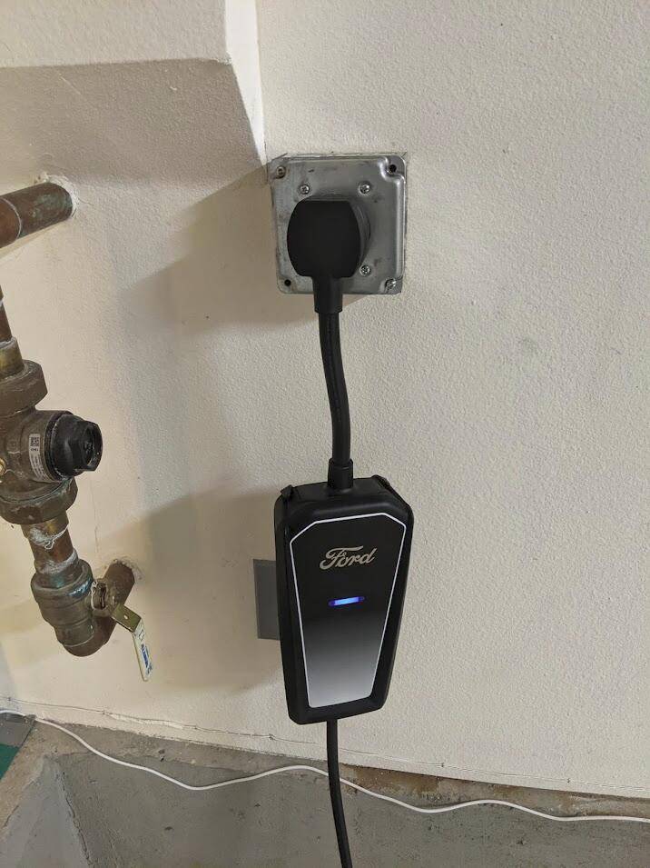

As I documented in another thread, I recently installed a NEMA 14-50 outdoor outlet on an outside wall so I could close my cellar window. I still use the Ford Mobile Charger with the NEMA 14-50 extension cord. I noticed the extension cord cable getting stiff in the colder weather, while the Mobile Charger cord is still very flexible.

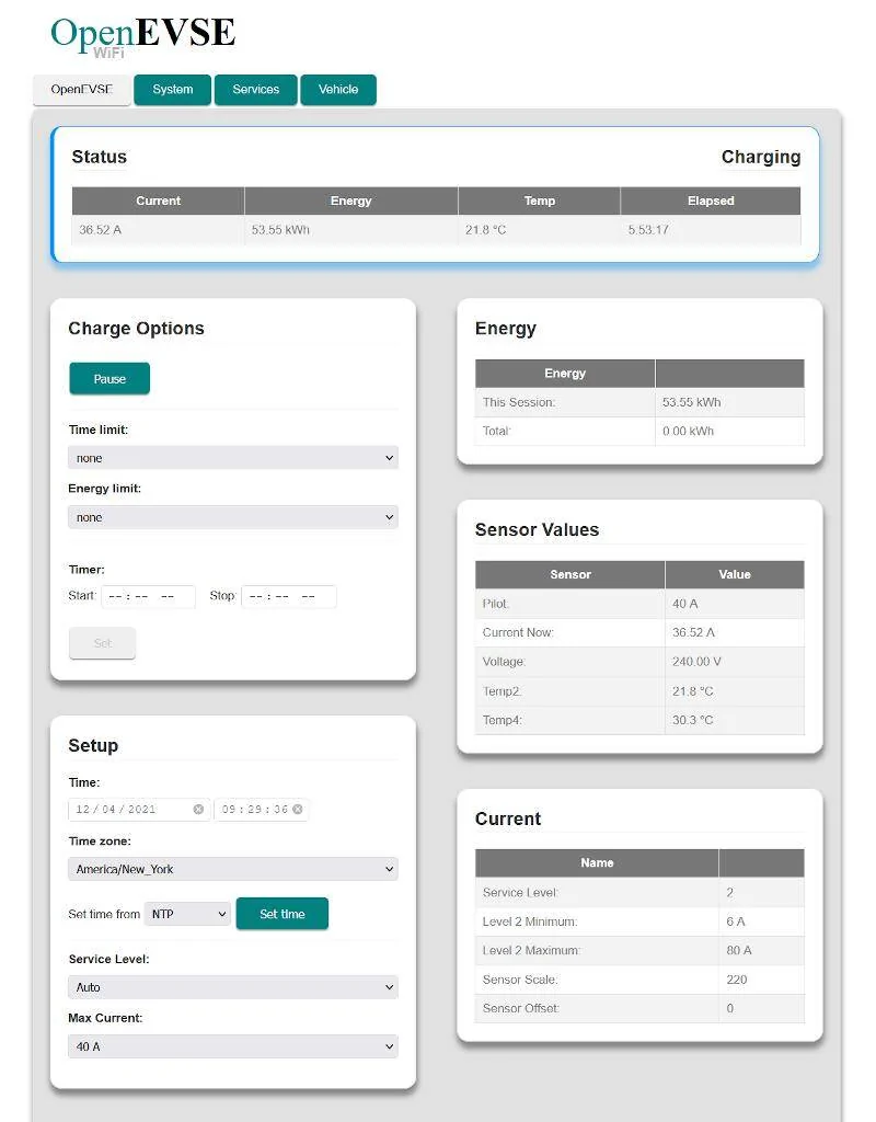

I got the openEVSE kit yesterday and built it last night. Not difficult because I have kit building experience. I set it up today and had a slight problem with the WIFI configuration. I do not have it permanently fastened to the outside wall yet. The 40 foot J1772 cable reaches the car with additional length to spare. So far the first charge is going great. 25 percent more power than the mobile charger and I do not have to drag it out of the frunk.
I like the web interface, simple but good information.
