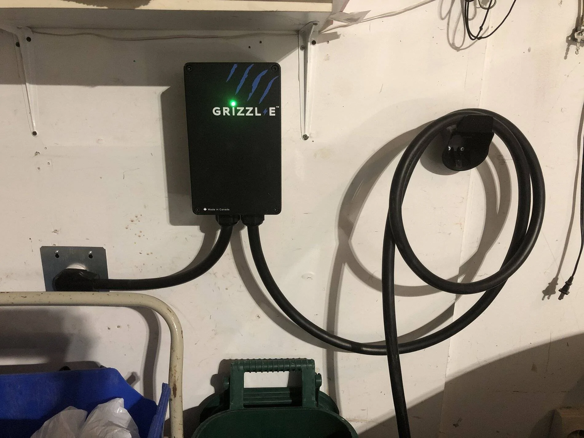

I reached out to Grizzl-E and asked if I could order their EVSE with custom length power and charge cables. Their power cable is 18" and charge end is either 18' or 24'. I wanted one with a 15' power cable so I could use an existing 50amp outlet and have the charge cable reach the car easier. Their answer was, NO, length is UL max at 18" and 24'
So I bit the bullet and moved the outlet, cost me $223 to DIY that between cable and conduit

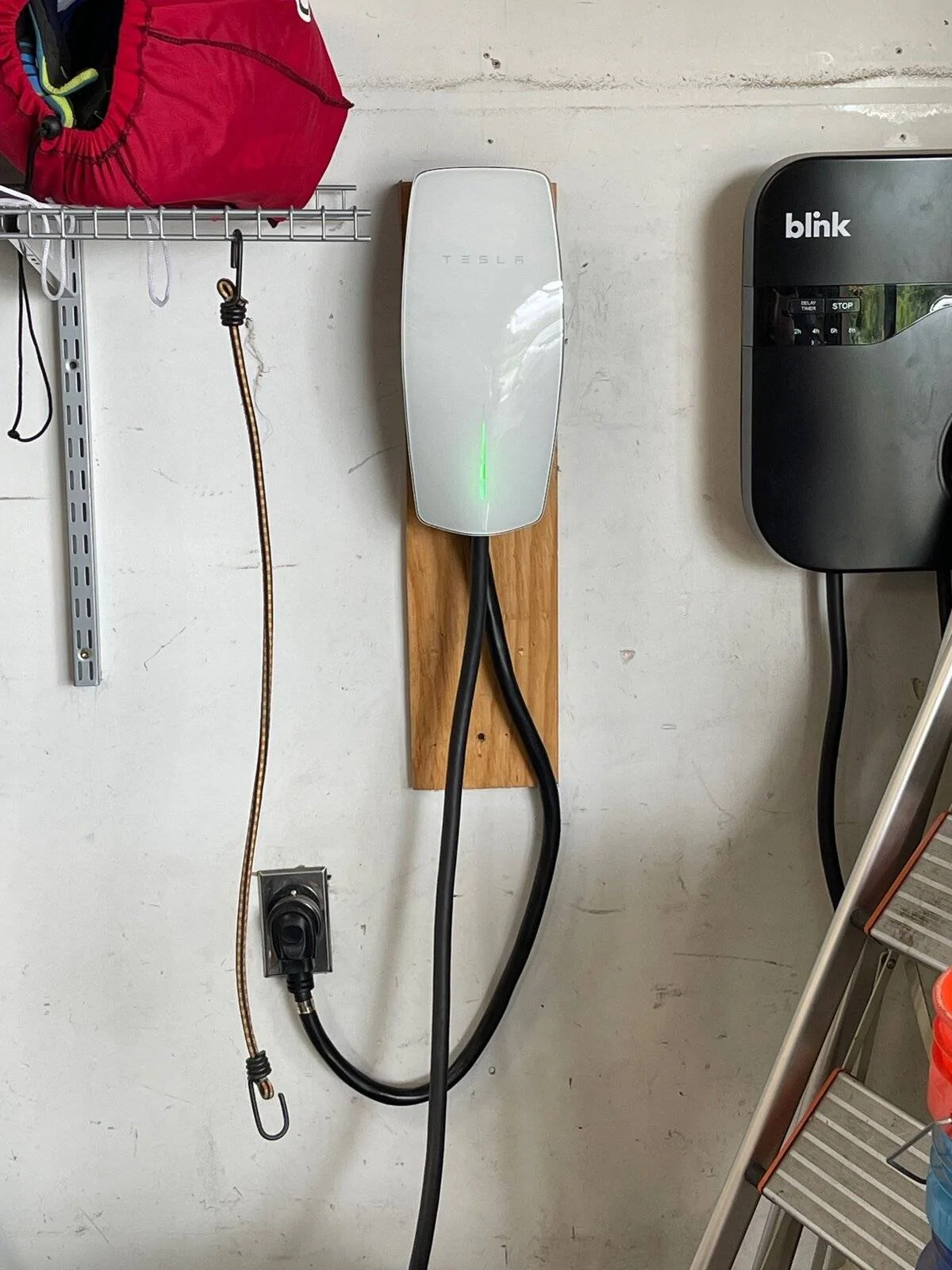

I picked up a gen 3 Tesla Wall connector with a bad cable ($200) replaced the tesla cable with a 50A chargepoint j1772 cable ($75). Now i just need my new car.........
Ford Mustang Mach-E What level 2 charger is everyone purchasing for home use? 64642765949__226FF3DC-04E7-49AC-92E6-7621D7C2E152
