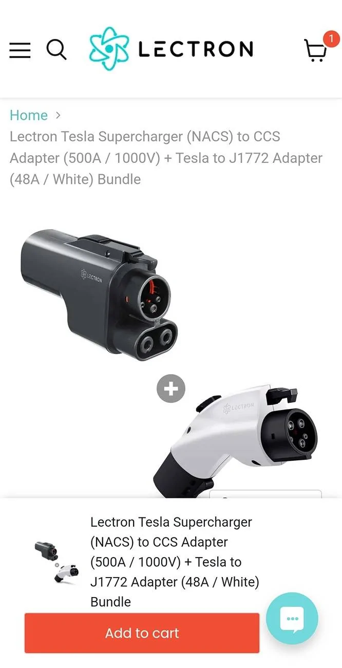

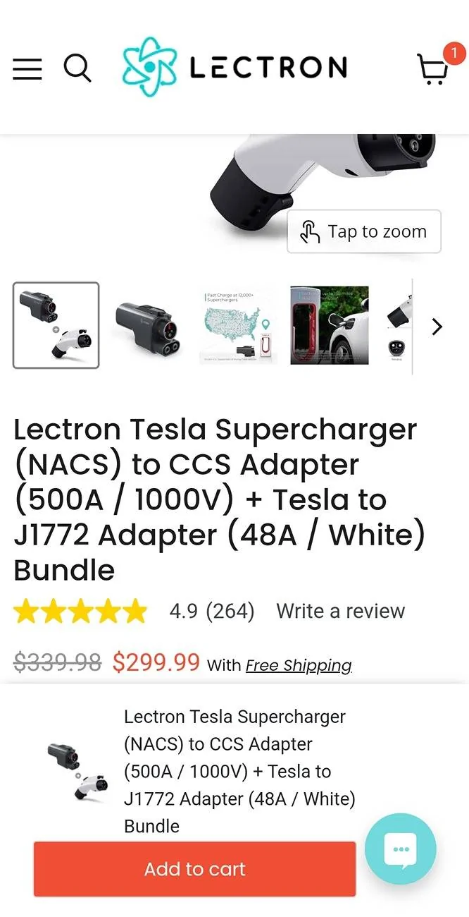

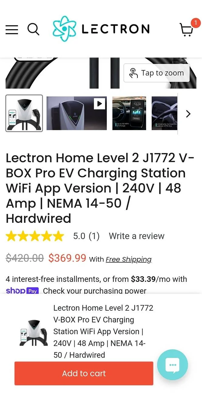

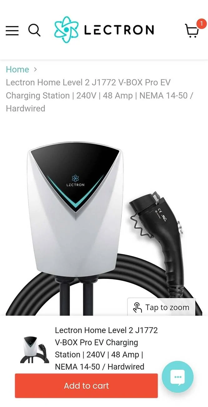

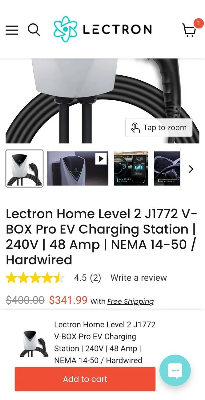

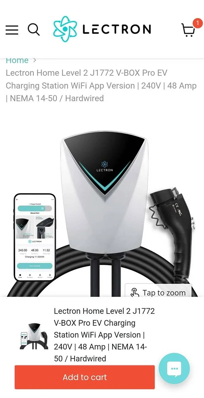

Another home charger option is through the company Lectron. I had the home charging station mounted on the outside of my home 2 years ago which has worked flawlessly. The one I have is the original model that does not have an app to monitor charging, but that does not matter due to monotoring by the Ford Pass app. There is a newer model with a wifi app. I use the Tesla to J1722 adaptor when I charge at my brother's home at which he has a Tesla charger installed for his Tesla. Right now they have an offer for the Tesla adaptor and Tesla supercharger. I have never used a Tesla supercharger as I was promosed a complimentary Ford Tesla supercharger that I received last week. Lectron often offers 5-10% promotions.
Oh, if you live in New York or a similar state with EV charging incentives, you may want a Chargepoint unit (NY) or a unit that communicates with the utility company (Con Edison/Orange & Rockland here). This past February and March, my charging data was shared with the utility company ($50 earned), but the Ford Pass connection was terminated because Ford "does not communicate with third parties." Consequently, not only did I miss out on monthly incentives, but also deep off-peak summer incentives totaling over $200 worth of time based charging incentives.😡 According to Ford and the utility company, they are working on a solution. 🫤😖. I attached photos of the charging adaptors and chargers referred to in this reply.
