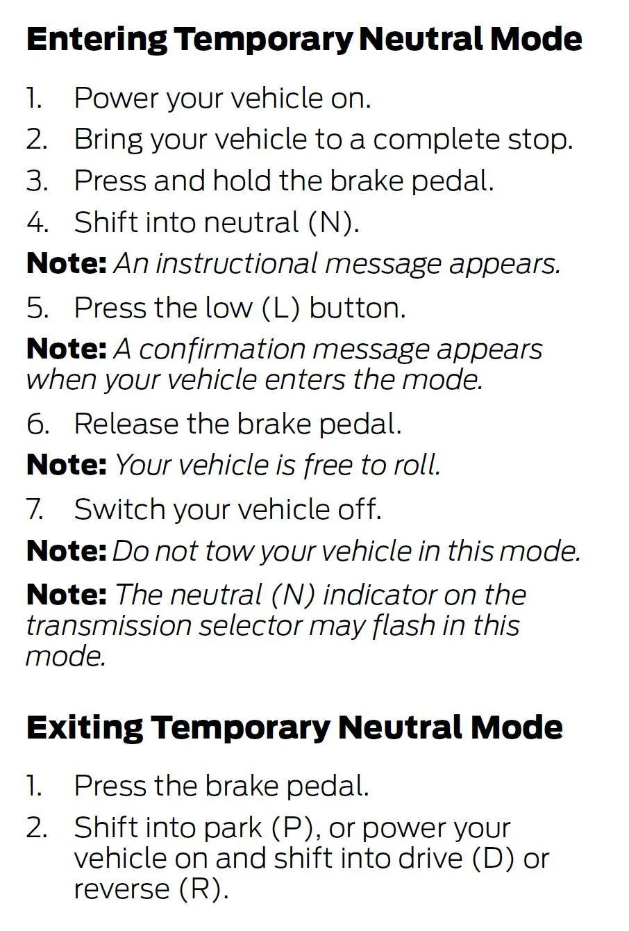

I've taken my Mach-E to the car wash 5 times. First time, no problem. Second time, different company, PROBLEM, my wheels were locked like in Park. I freaked out and put in in park and then back in neutral and pressed the accelerator, and my wheels unlocked and went through the carwash. Third time, no problem, fourth time, no problem, last time, total wheel lock.......I was very embarrassed, we tried 6 times, stopping the entire carwash 3 times. I finally had to reverse about a foot, go forward about a foot, and put it in " N " neutral without stepping on the brake. I finally got to go throught the car wash.
Three different wash companies but the same technology.
DOES ANYONE KNOW HOW TO MAKE SURE THE CAR IS ACTUALLY IN NEUTRAL?????
