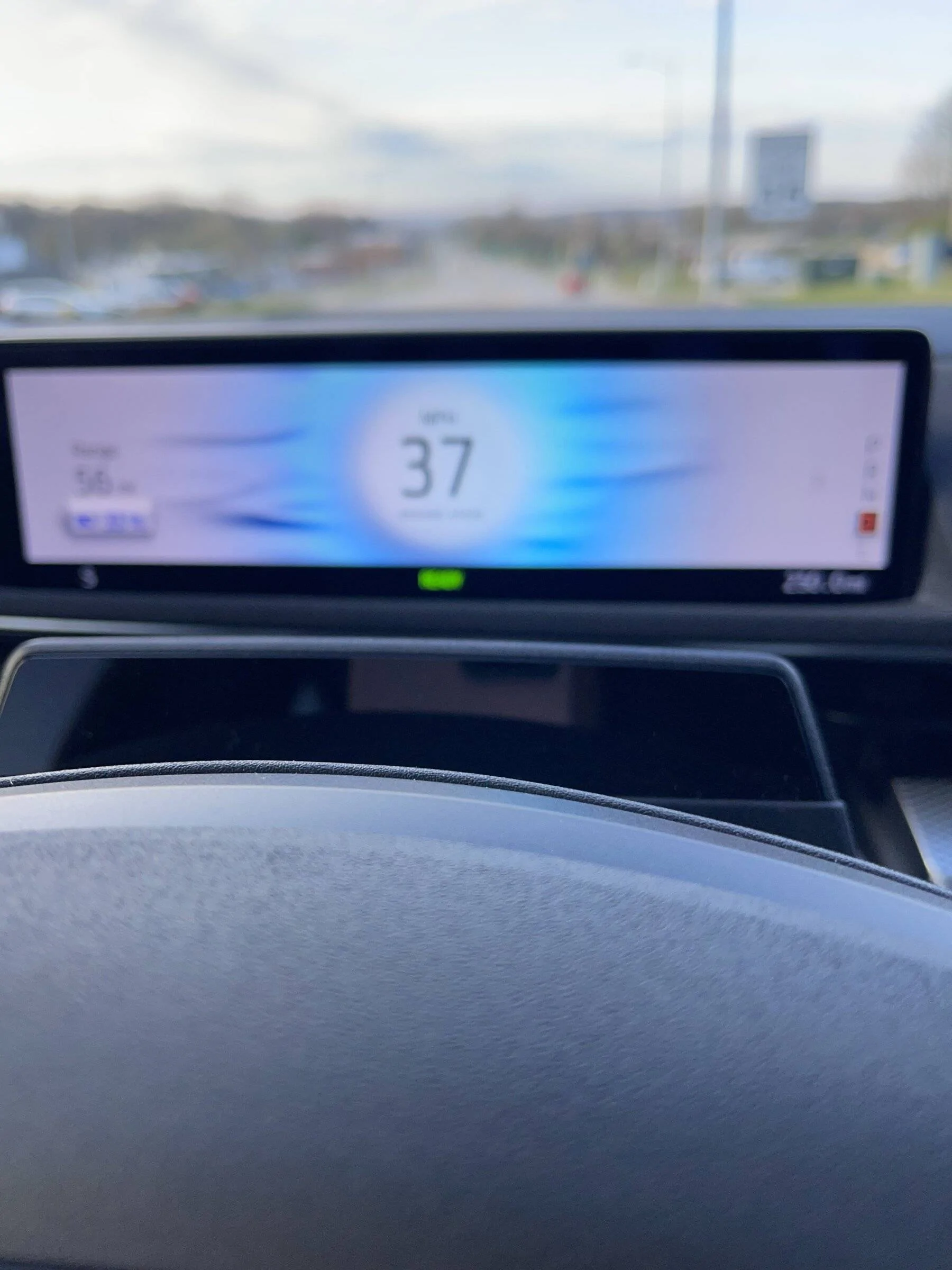

FYI: It is much better to include a picture along with this sort of question. Also, include key information like the drive mode.Anybody know why the color of the speed display in the car turns to a blue? Thanks
It’s in whisper mode, and here is a pic. Sorry for the vague post, it doesn’t turn blue all the time only sometimes while driving.FYI: It is much better to include a picture along with this sort of question. Also, include key information like the drive mode.

I see the same sort of blue waves effect that you're observing. I believe it is loosely tied to the amount of power being used to keep the vehicle in motion.
In Unbridled mode this effect is much more pronounced and more obvious. Whisper is more subtle. Engaged doesn't have this sort of animation.
