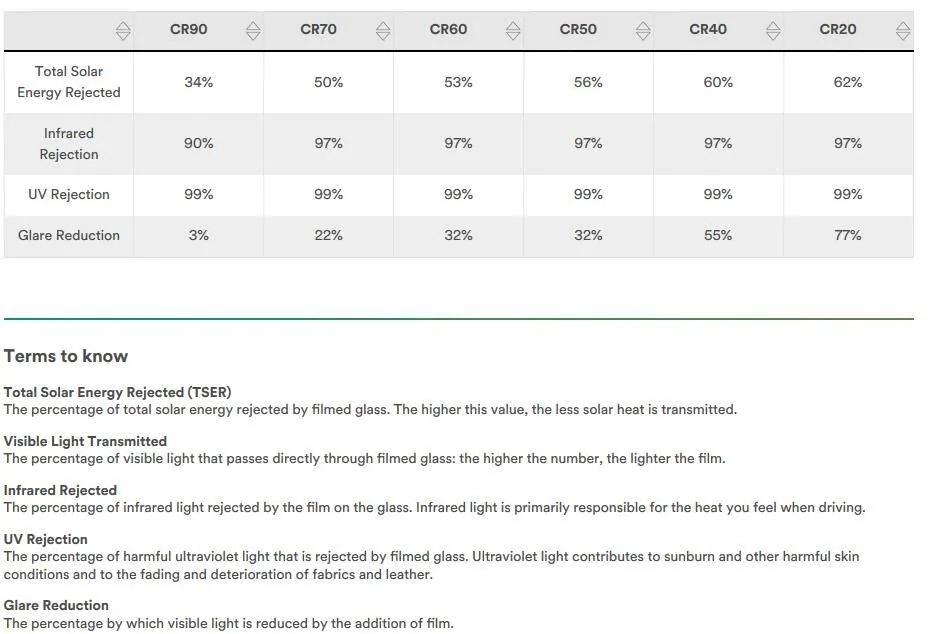

Great write up and coincidentally I was just looking at a local business with that same table and information. Plotting out tint for the front side windows on the MME atm.Darkness value means close to nothing for tint. A dark cheap tint would let in more heat than a lighter more premium tint.
What your interested in is total solar rejection and Infrared rejection. UV doesn't really matter as far as heat, that's more for protection from fading, skin cancer, etc; I think the car already has some UV protection and the pano roof has infrared protection.
From 3M Crystalline's website:
On my C-max, I have CR70 on the front windshield, and CR40 on the sides and back. It allows 40% of visible light, and rejects 60% of the solar energy. Compared to some random tint I found on Amazon that allows 20% of light but only 50% solar heat rejection. (If you can believe their numbers in the first place.) Another example is 3M FX-ST, in that line, they have one that allows 5% visible light but yet only rejects 46% of the solar energy.
Bottom line, if your interested in heat rejection, quality > darkness. If your interested in just looks, then it doesn't matter as much.
