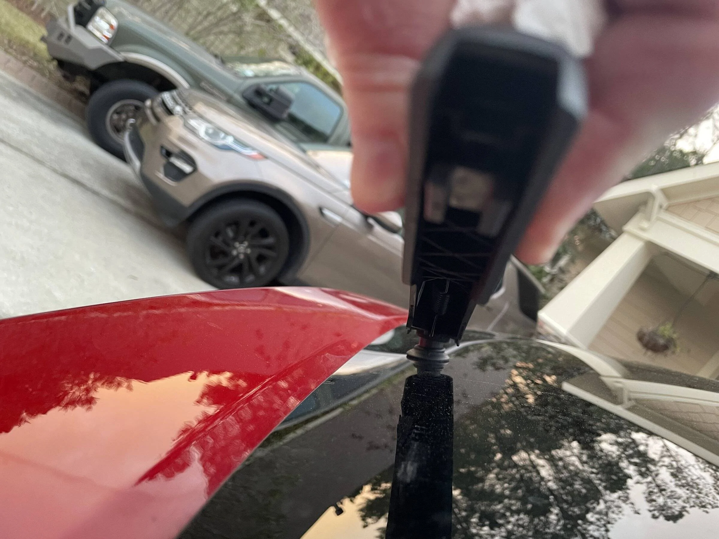

Wiper broken/knocked off in car wash
Blanked
James
Jan 10, 2021
386
373
Bluffton, SC
2021 MME FE , 2003 Ford Excursion EB 4x4
So i had upgraded the wiper to the longer blade back in March. We run thru the car wash 4-6 times per month…
just noticed this after a trip through the wash today..

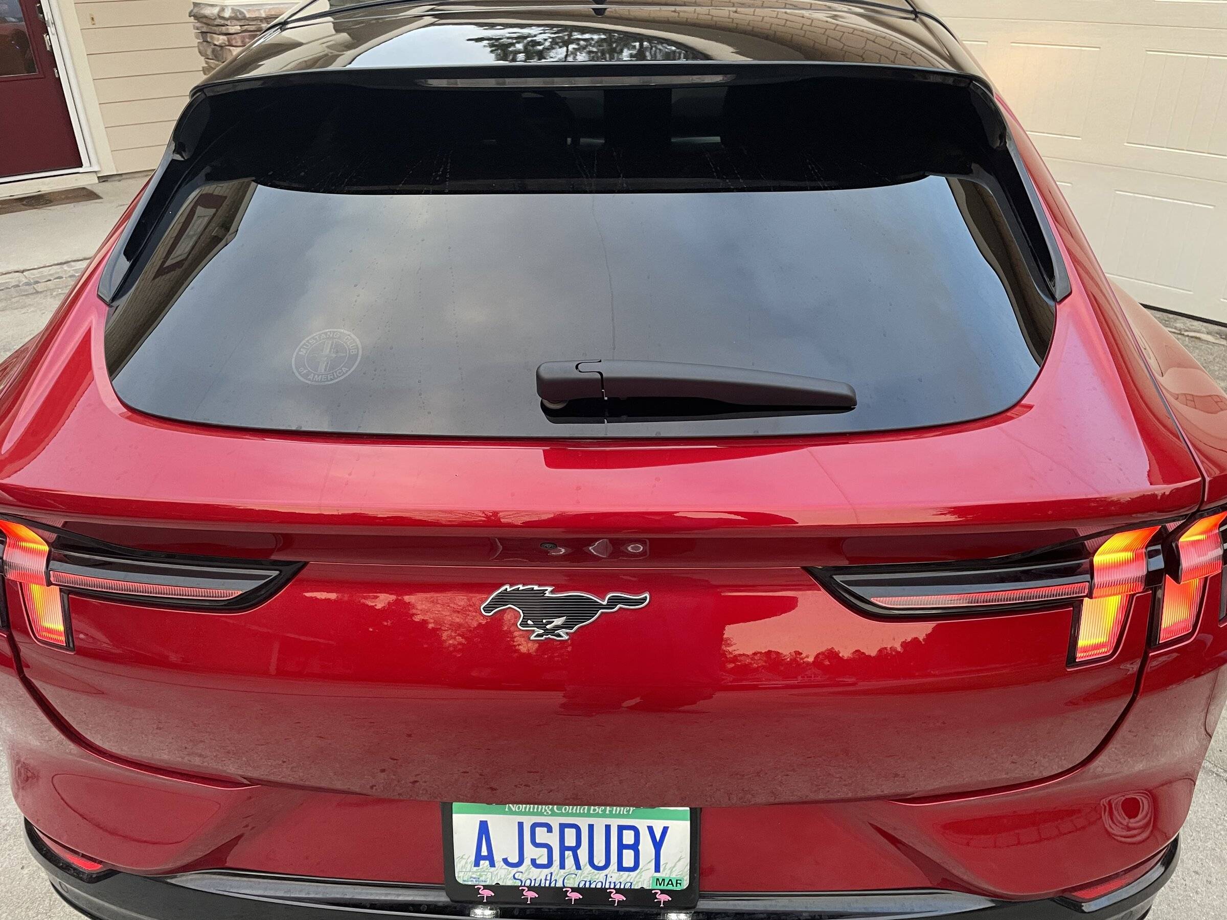

Most of the pull through car washes around here actually have someone put a piece of tape over the rear wiper to keep it in place through the wash.

Saw this coming after reading the wiper thread. Rear wipers are notorious for getting damaged in car washes. A longer wiper that doesnt sit flat on the glass makes it just a little more easy to get damaged.

The longer wiper sits flush to window but the issue i see with it is it's not like the original which had a two position connection where the replacement just snaps in so easier to know loose

Thought I'd mention that almost my whole rear wiper (wiper blade, wiper blade holder, and spring, but not the joint cover) was ripped off in a car wash a few days ago. After the wash was done, I found all the pieces on the ground, except for the wiper blade itself, which I never found. (Did it go down the drain?) After a little head scratching, and confirmation via some photos in this thread, I was able to figure out how to reassemble it all back on the car. Now I just have to wait for a new blade (TRICO Exact Fit 15 15-G) to arrive to have it fully operational again.
The head scratching was to figure out he orientation of the spring. It will pretty much only go one way, you have to play around to figure that out. The attachment hooks extend from each end of the spring and it's the longer extension with the bent wire (with bend downward) that goes towards the base of the wiper assembly and hooks on a pin. I just hooked both end of the spring first, then pulled the whole blade holder to fit its hinge point into the base. I hope this makes sense.
The only permanent damage appears to be a little bit of plastic chipped on the under-inside of the blade holder near the base attachment point where the spring appeared to make contact during detachment. I broke a little more off myself during reattachment, but it doesn't look like it will affect anything.
I thought it was a little funny that folks here mention that the most common thing to get ripped off in the car wash on the rear wiper is the joint cover, but in my case that's the only thing that didn't get ripped off.
