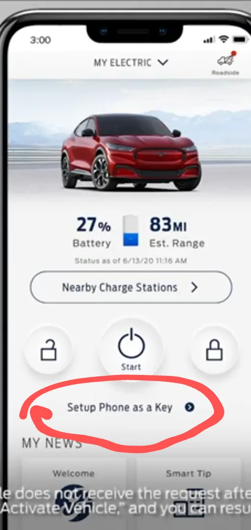

I have not been able to set up PaaK on my Android Pixel 3aXL and my wife's Pixel 4 phone. The "Setup Phone as a Key" (Circled in the pic below) option never appeared below my Start button in FordPass, despite several reboots, uninstalls, clearing cache, Mach-e Master Resets and THREE calls to the FordPass (Quote) "Guides".
For the heck of it, I sent my VIN to my brother who has an iPhone just to see if he set it up, would he at least get the PaaK option.
So I sent him the VIN and he did an Activation request. I went into FordPass to grant him authorization and the PaaK option was in there!
I followed all the instructions, said "yes" to all the Android pairing questions and now it's working. And I also get all the extra features like windows up/down, trunk, horn, etc...
So relieved. Hopefully this helps others pulling their hair out because of this.

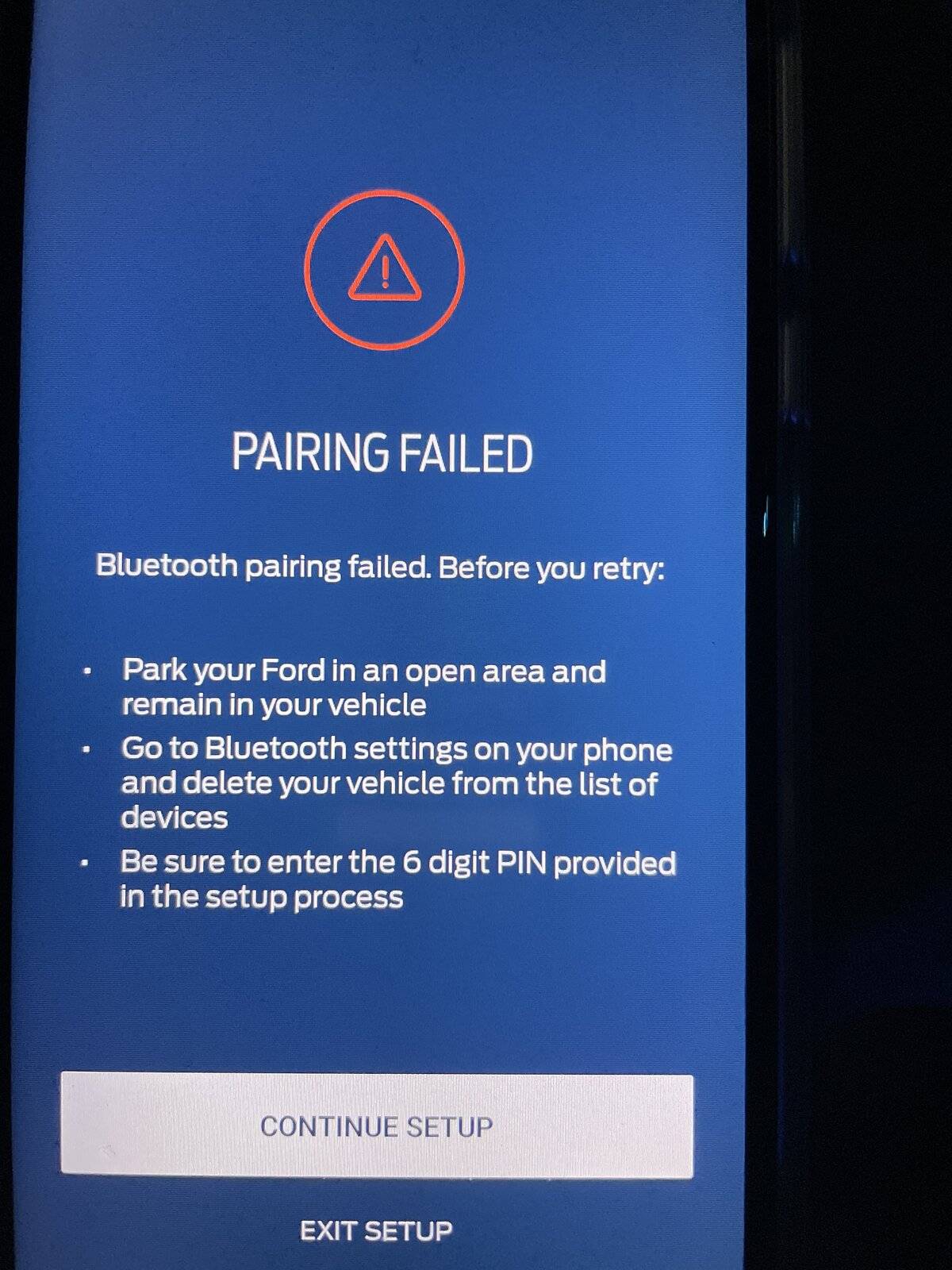

Mine is not going through the paak setup. It ends up with this message. I tried 3 different phones, both ios and android.
