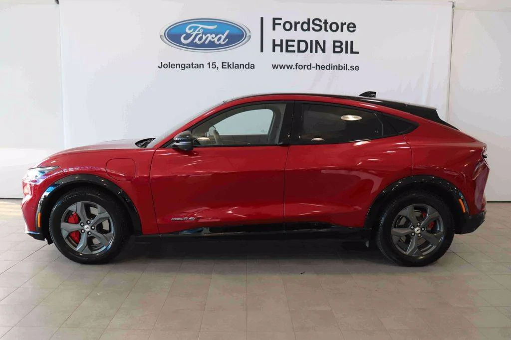

Got an AWD with the original 18". No problem.

But correct me if I'm wrong - the red calipers and the discs on the AWD is exactly the samze size as the RWD?
So, the 18" original will fit the AWD just fine? Because I thought that the fitments were different and the brakes/discs would be too big for the 18".
ALL non-GT MachEs have the exact same brake sizes, and will fit the exact same wheels. The GT and GTPE have a larger front rotor, so while all the wheel fitment measurements are the same, they will not work with an 18" wheel.

The ground clearance with stock 19" and stock 18" is identical. Just more rubber, yes.
