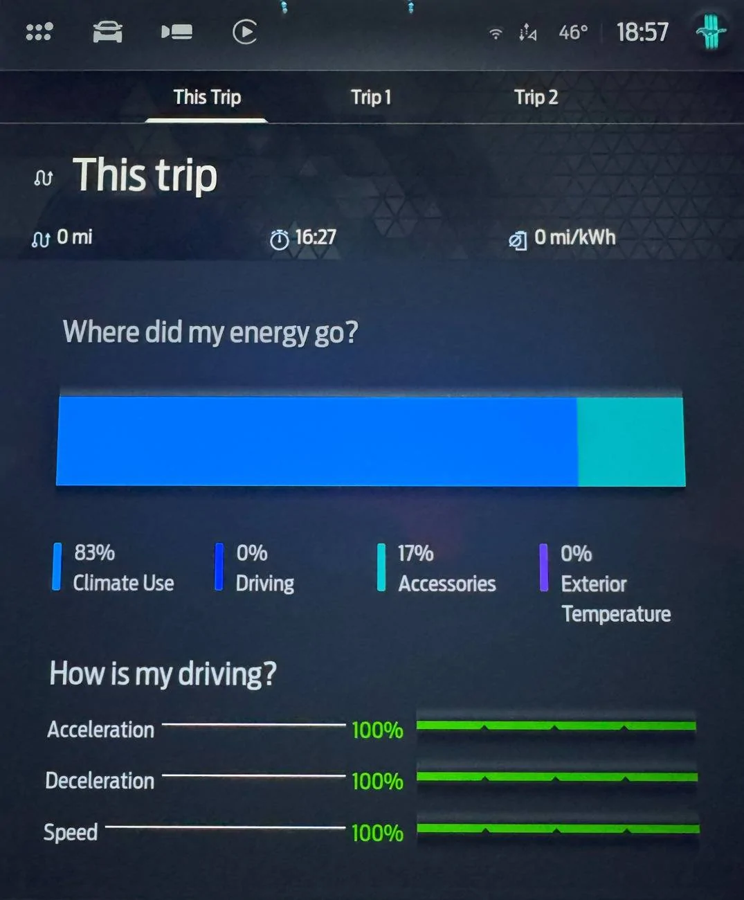

While that part of my drive home was small, the rest of the trip home from work left the climate use percentage mostly the same. It dropped to 48% by the time I parked in my driveway and I turned off climate control for about 10% of the trip home. I couldn’t believe the number either. I did not precondition the cabin, I just started the car and drove. I normally average 2.3 miles/KWh going to work and 2.8 coming home. There is more traffic coming home. I have not seen this disproportionate climate use before or since (it’s only been a couple of days since I saw that). ?ā€ā™‚?
FYI if you turn OFF climate control, in certain temperature ranges that can cause the battery to heat instead, which can use MORE power than if you left HVAC ON (counterintuitive right?). Which is why you might see the Climate Use bar expand after turning HVAC OFF since it's heating the battery now with the full 6 kW.
If the battery is already warmed up, then you should have no additional climate use if you shut off HVAC.
For consistent results you want to use a departure time (to make sure the battery is warm), and leave your HVAC ON set to the same thing each time (e.g. 68ĀŗF AUTO 1 like in Mark's photo).
I never turn off HVAC unless I'm doing testing or at 5% battery, it's not usually a significant factor compared to my driving energy use at the highway speeds I normally drive. Plus I despise driving without any airflow or HVAC running.
Again, Ford is more proactive about keeping the battery and cabin warm with the latest changes, so if the car is kept outside, normally unplugged, or on a restrictive charging schedule, you may see greater energy use because of automatic battery conditioning while driving. Especially in the first half hour of driving until everything is warmed up.
