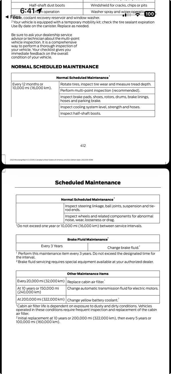

I recently took my 2023 GT for 30k service. But I got the car next day from the day I was supposed to get it. They only did a multi-point inspection. I thought at 30k they do brake fluid and other changes. Even they didn't ask or do a cabin air filter change. Were they supposed to even if the multi-point inspection came back good

The info is in your manual. Every 10k is an inspection and tire rotation. Every 20k is the cabin filter. Brake fluid isn’t until 3 years. So your 30k service is an inspection and tire rotation.
