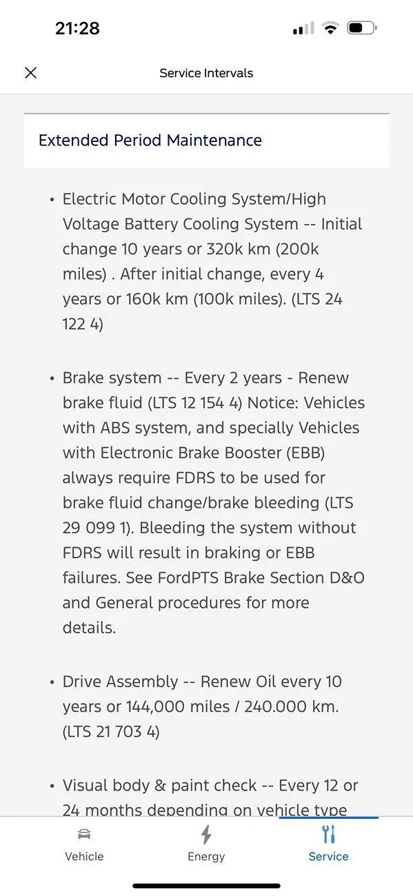

As was discussed early in the thread, the brake interval only shows in the manual, and was even omitted in some of the online manual versions. Since it isn’t a mileage based recommendation it doesn’t show on the mileage based Ford account recommendations. Ford really needs to fix that omission if they are serious about the 3yr interval, as it is causing significant confusion.
In UK it’s listed under Extended Period Maintenance in Ford Pass App.
