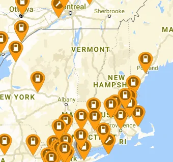

OK, well your route seems to intentionally cross a fast charging desert. Along the eastern seaboard there are plenty of >50kw chargers as evidenced by this map from plugshare:

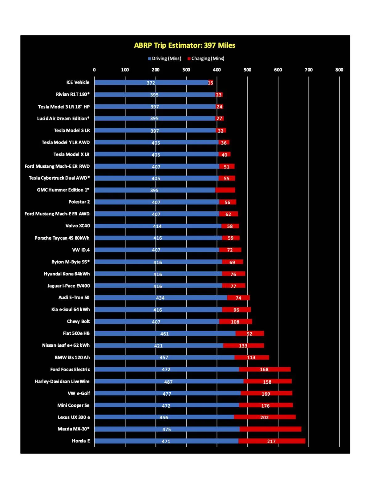

For comparison, I ran a trip from Philadelphia to Durham, NC (379 miles) which has lots of DCFC charging along the way:
Ford Mustang Mach-E ABRP Sample Roadtrip Comparison Across EV's EV Road Trip Estimate 2
Excluding the prototype vehicles, aside from the ER RWD MME coming close to the Model X results, Tesla still owns the trip. Once again, the ER AWD MME is sandwiched between the Polestar 2 & the Volvo XC40 (this one REALLY surprises me given the lower range on the XC40). The ER AWD MME is still 29 mins behind the Model Y and a whole 83 mins behind the reference ICE vehicle.
This data makes me consider the XC40 as its virtual performance shows it may be the more efficient AWD vehicle, performing very similarly to the MME but with only a 75 kWH battery. It also has a tow rating and a heat pump :).
For EV adoption to take off, total travel times are going to need to come closer to ICE vehicles. For the average person, I'd say that means EV travel times within ~30ish minutes of an ICE vehicle. We're probably still 2-3 years away from that outside the Tesla world.

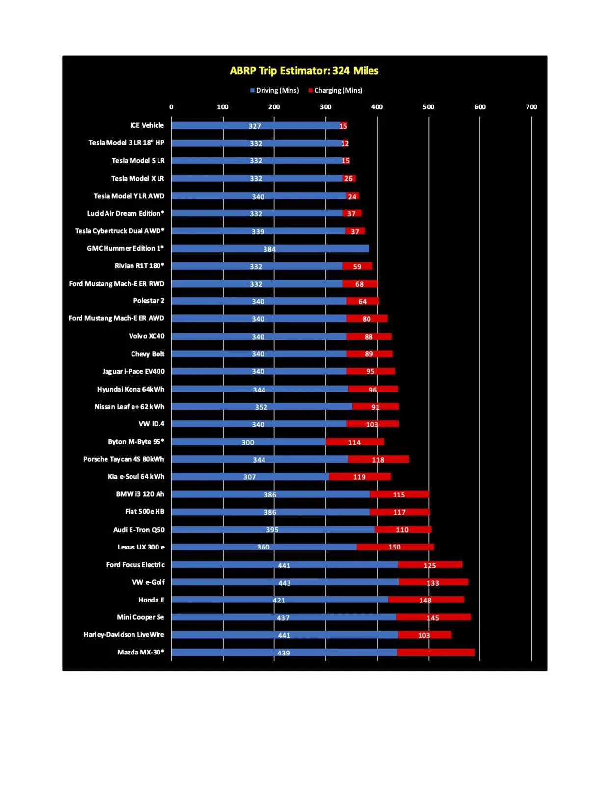

I put together a chart showing the ABRP (abetterrouteplanner.com) results for a 324 mile EV road trip I took last December across 29 different EV's. The trip starts in Marlborough, MA and ends in Montreal, QC at a constant outside temp of 40F and goes through both flat plains and mountains. The chargers along the way include EVgo 50 kW but no EA DCFC's as they aren't in operation yet. I also included a standard "ICE Vehicle" for the same trip using Google Maps (assuming one 15 minute gas/snack/bio break stop). Vehicles with asterisks are not yet available.
Not surprisingly, Tesla dominated the top end of the results. I was surprised to see the Mach-E stuck between the Polestar 2 (EPA: 233 miles) and the Volvo XC40 (EPA: 208 miles). Perhaps this is due to the sheer weight of Mach-E?
Lots of assumptions in four of the vehicles faster than the Mach E in that chart. We'll see if those companies can live up to their own hype.

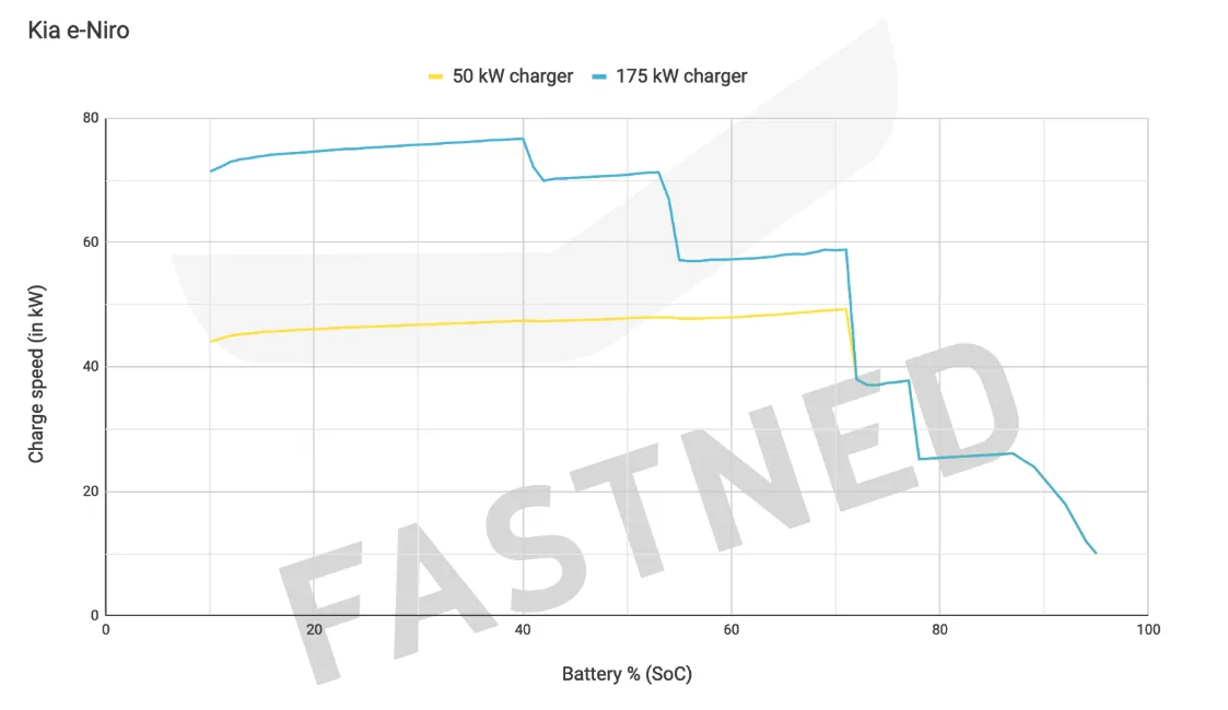

When planning a BEV trip, you need to arrive at your destination with enough battery power to get you to the closest charging station (whether that's on the way back or in the middle of your trip is up to you). I've done a few trips in my Kona to remote places where the closest charger was 70+ miles away. I arrived at my destinations with less than 15% battery. This wasn't an issue as I was staying at least 2 nights and I was able to plug in the 120V charger that came with my vehicle so I had ample battery level by the time I headed home.
Ford Mustang Mach-E ABRP Sample Roadtrip Comparison Across EV's Kiae-Niro_022020
The charging speed isn't necessarily the most important issue as all BEVs charge on a curve where charging is most efficient between 10%-80%. Beyond 80%, charging is speed is going to crawl as the battery approaches 100%. Some BEV's like the Kia e-Niro step down the charging rate as the battery fills up as you can see from its charging curve. In this instance, there's no charging speed improvement between a 175 kW charger & a 50 kW charger beyond a 72% charge level. For these reasons, two BEV's that are both rated for 125 kW DCFC charging can have very different charging session times.
There's a lot of calculus involved in planning a big EV road trip. Thankfully, tools like ABRP make it much easier since they do most of the number crunching (factoring in elevation, temperature, charging speeds, vehicle charging curves, etc).
