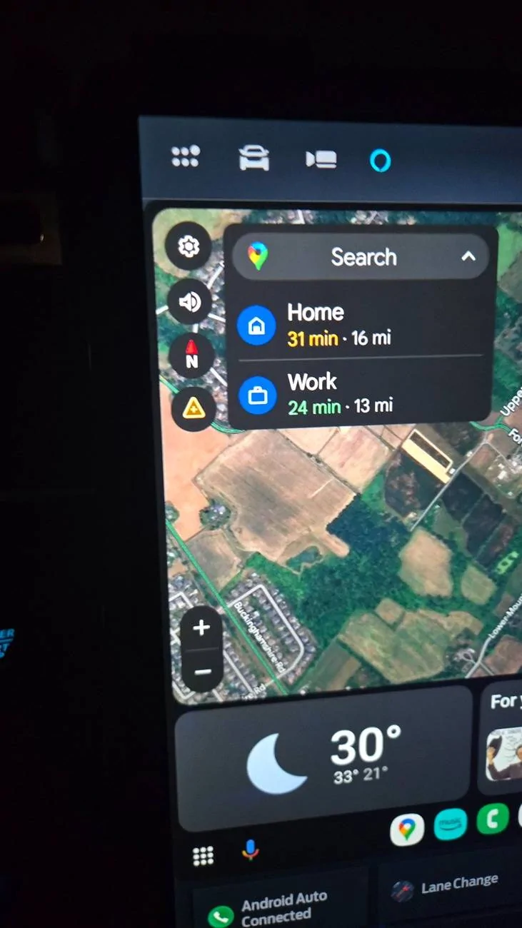

I am not getting any of the features like battery on arrival estimates, charging stops, or preconditioning.

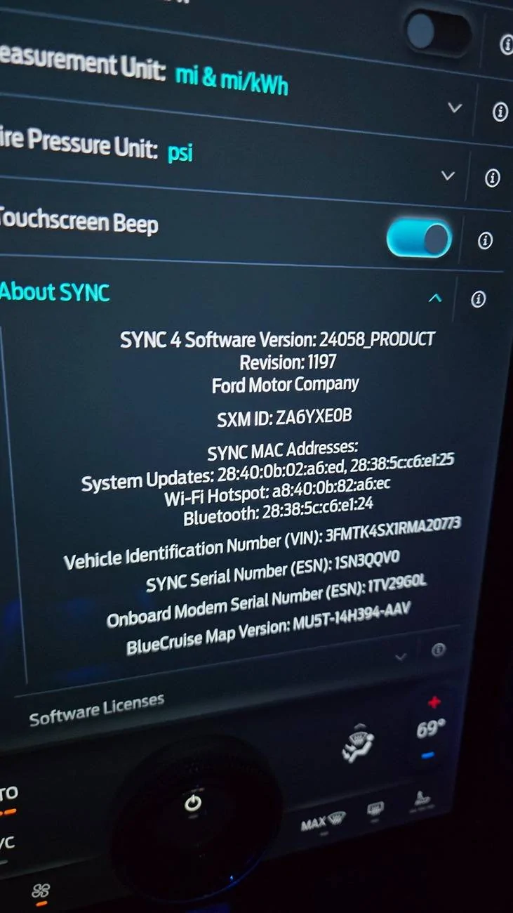

I confirmed I have the latest Google maps and and configured my vehicle in the settings. I have not been able to figure out how to see what version of the software I have in the car but I would assume since it's brand new it should be updated. (Probably a terrible assumption) I did receive two updates over the last couple of days. What I do see doesn't align with what I have read. (10.1.0 and later). My SYNC version is way off from that but I don't think thats what they were talking about

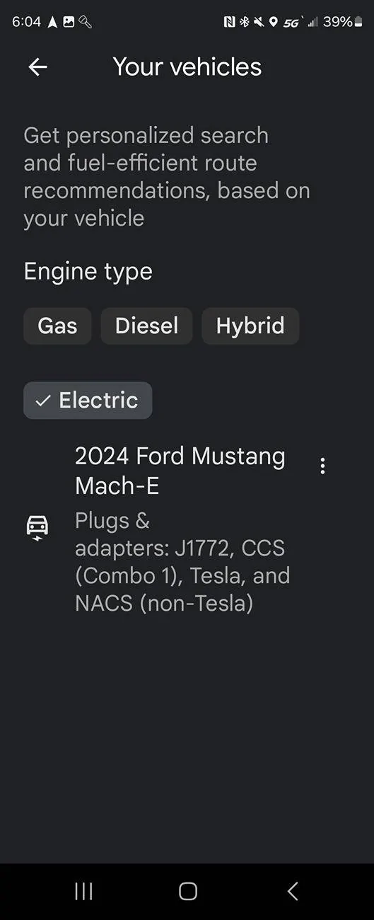

So far I have uninstalled and reinstalled Google maps, reconnected the Bluetooth in the car, and made sure every option I could find in the car was turned on.

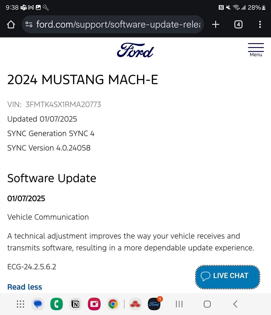

I really hope I'm missing something obvious. Has anyone else had issues? I'm attaching some pictures I took showing the options and versions.

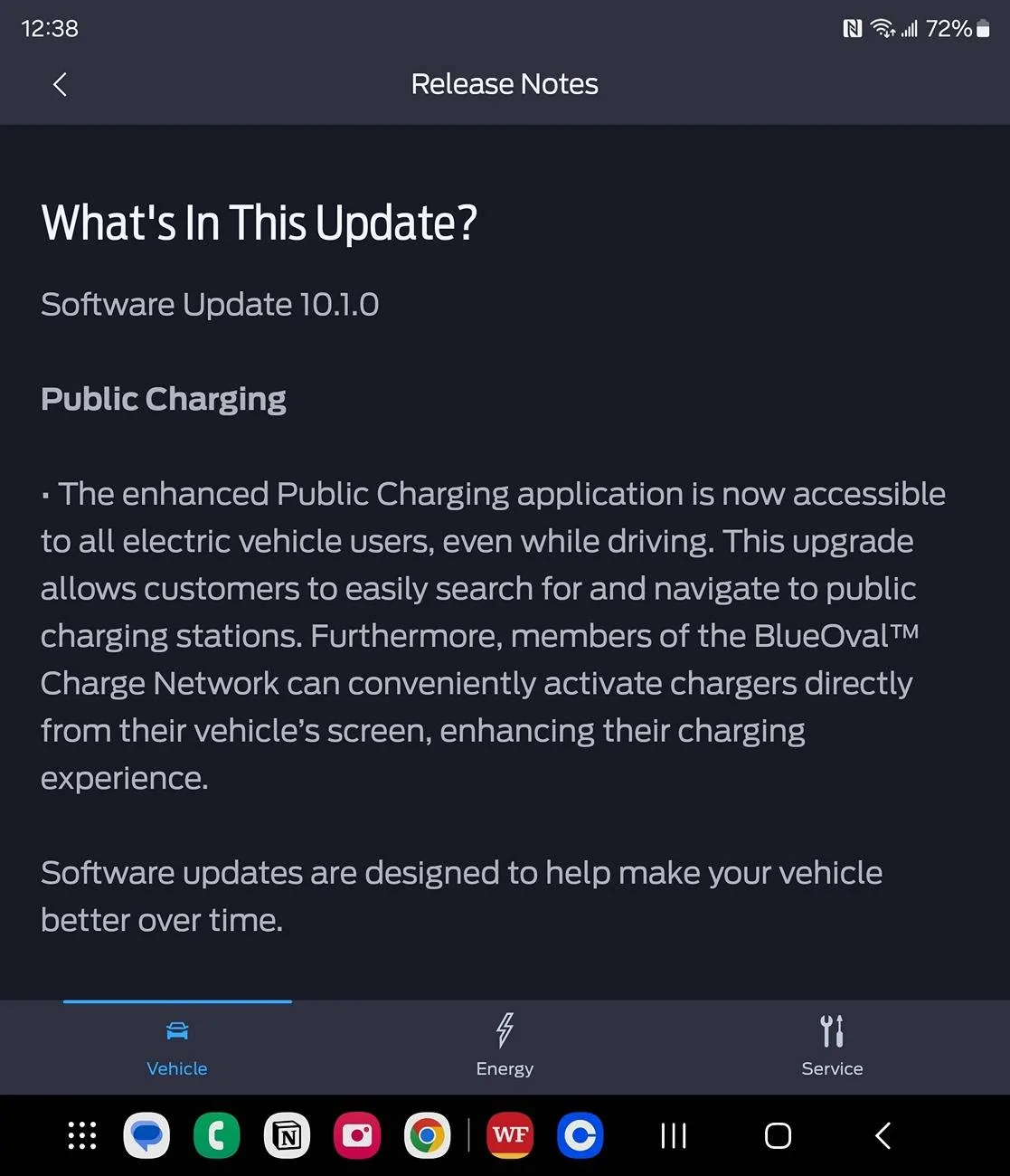

10.1.0 update enables battery sharing

Your vehicle has not yet received the update (10.1.0) that enables Google Maps EV Routing for Android Auto. When it does, the feature will automatically turn on.

You'll see Software Update 10.1.0 in the release notes when the update is deployed to your vehicle. This feature was released after your vehicle was built, so your vehicle needs an update to receive this feature.

Where can I find what version of SYNC I have? I have a 21 and have never had the EV functionality of Google Maps in my car. It sure would be nice if it knew my battery levels.

Well what do you know. I cant help but wonder if posting about this and putting a pic of my vin number in a public form didn't help. lol Going to try and mess around with it tomorrow. But already I see the charge at destination estimates showing up.

Its in "about sync" You can see mine in the pictures above
