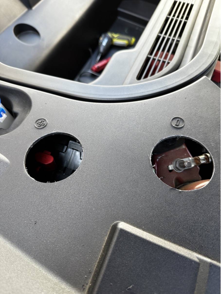

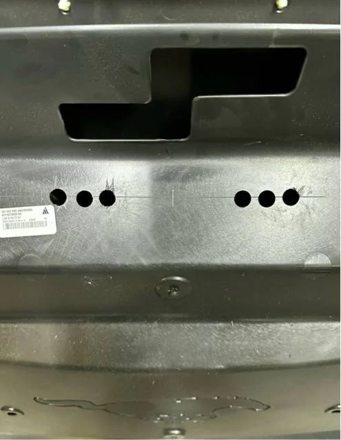

I had to pull my panels to charge my 12v battery. Since I was in there I decided to improve the lighting for the frunk.

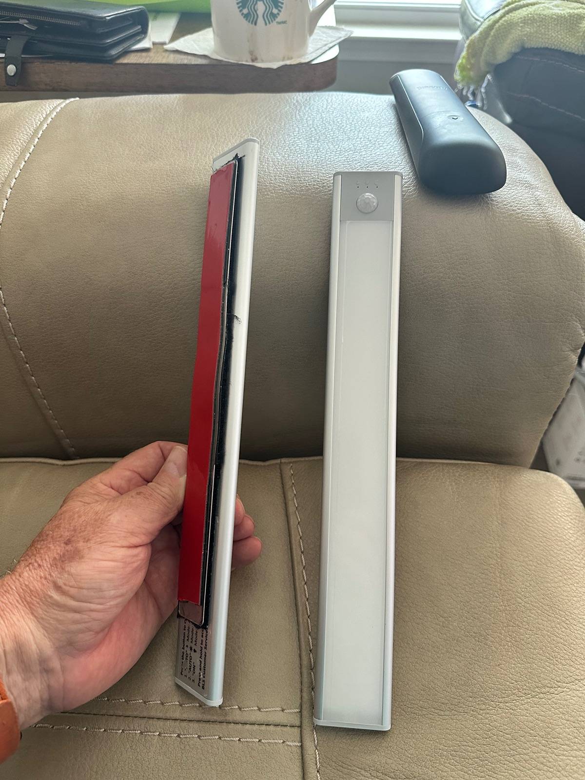

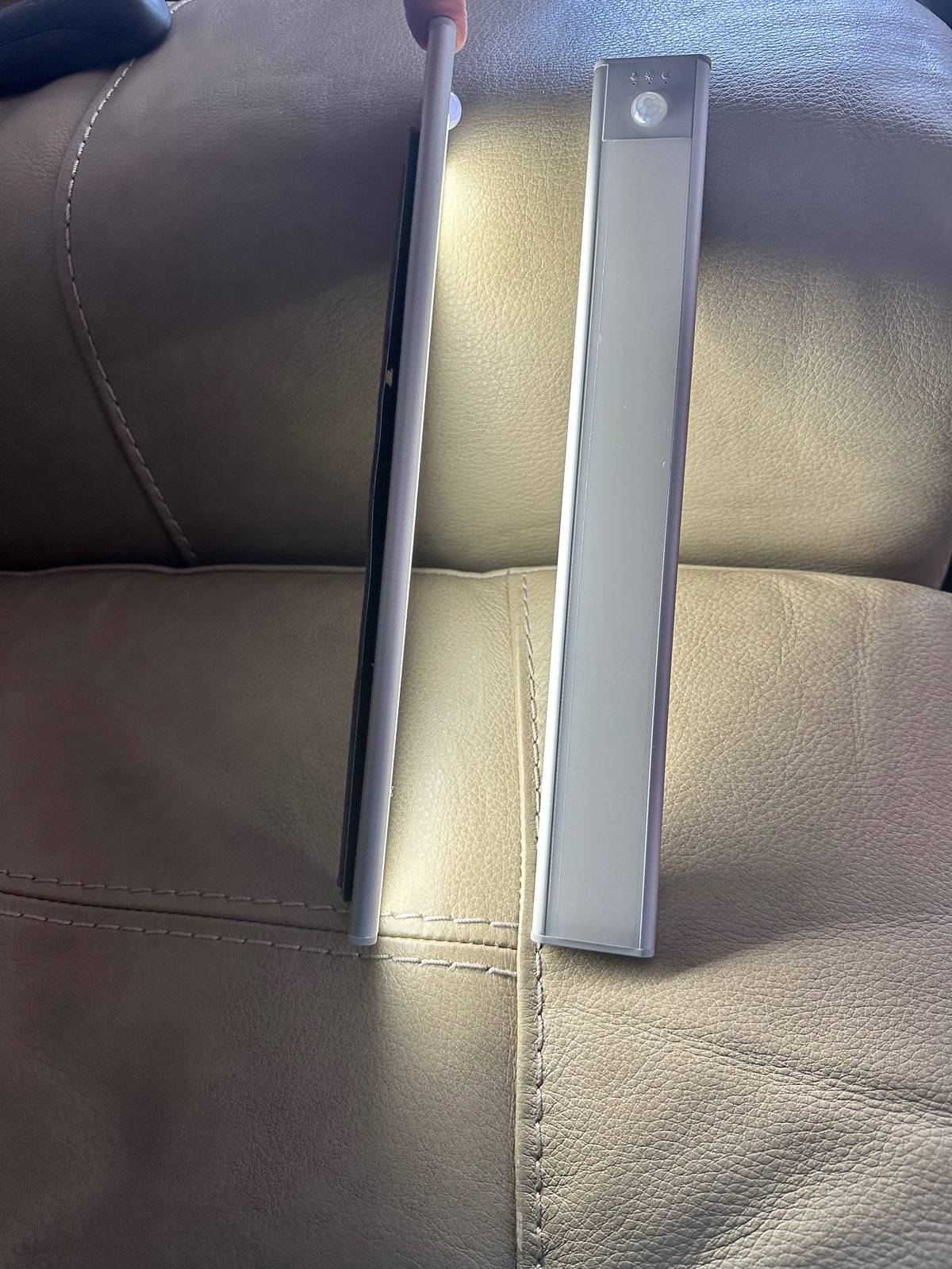

I had some 12v led light strips that I used to fully light up my trunk of my 2016 GT. They don’t make them anymore, but they are similar to these
https://www.amazon.com/dp/B08RBKSHR...pY2tSZWRpcmVjdCZkb05vdExvZ0NsaWNrPXRydWU&th=1
1. I pulled the hood liner.
2. The flat section is at the right angle and just over the frunk, so I drilled the holes where the leds would be.

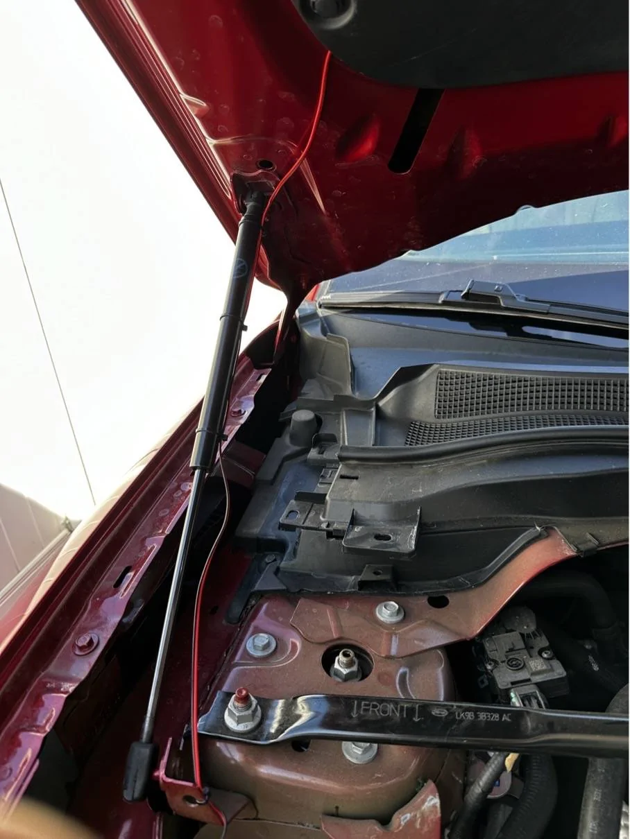

3. I hot glued the lights in place. I also hot glued the wire to the hood line and routed it to the left strut where I zip tied it all the way to the frunk wire harness.

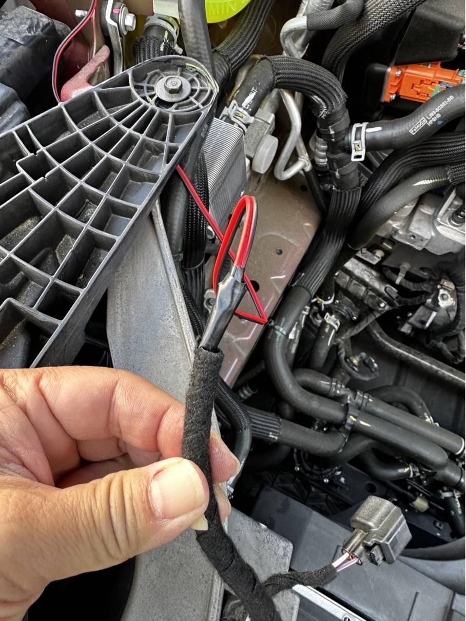

4. I cut off the light connector and spliced in my wire.

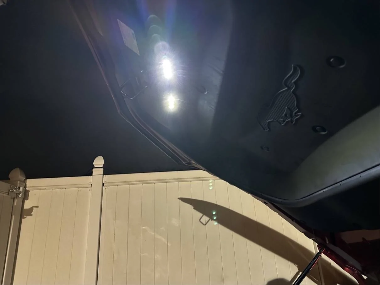

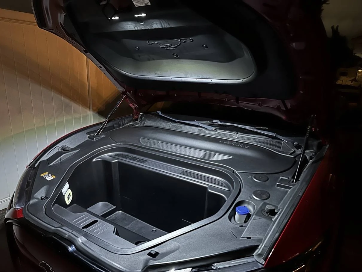

5. Here’s the end result. Very happy. Except for a little section of wire, everything is hidden.

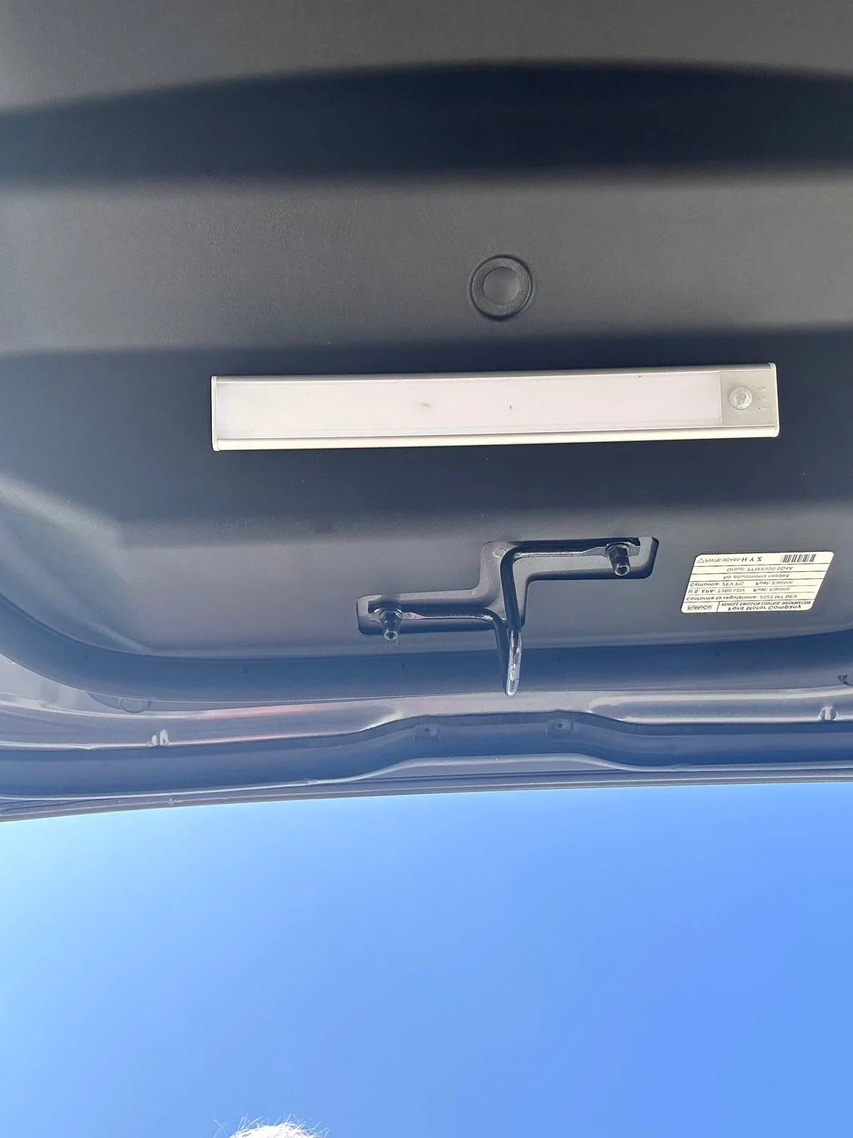

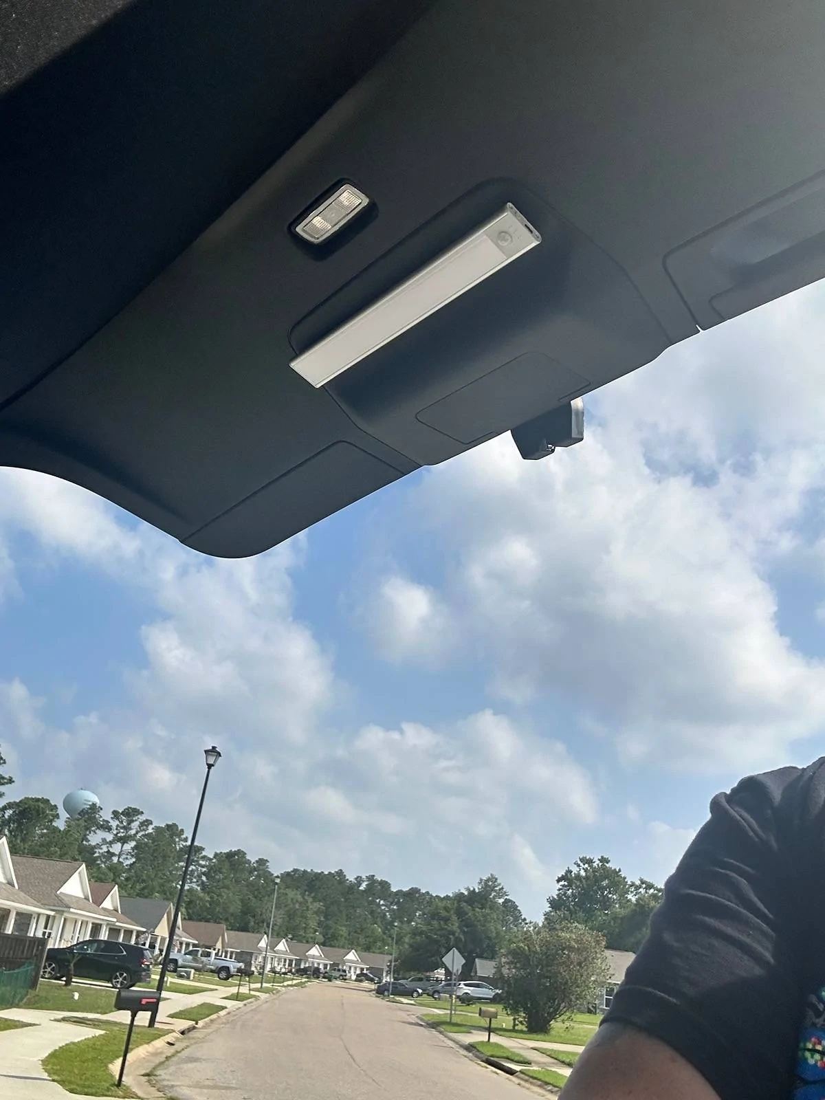

Next, improve the lighting under the rear hatch.

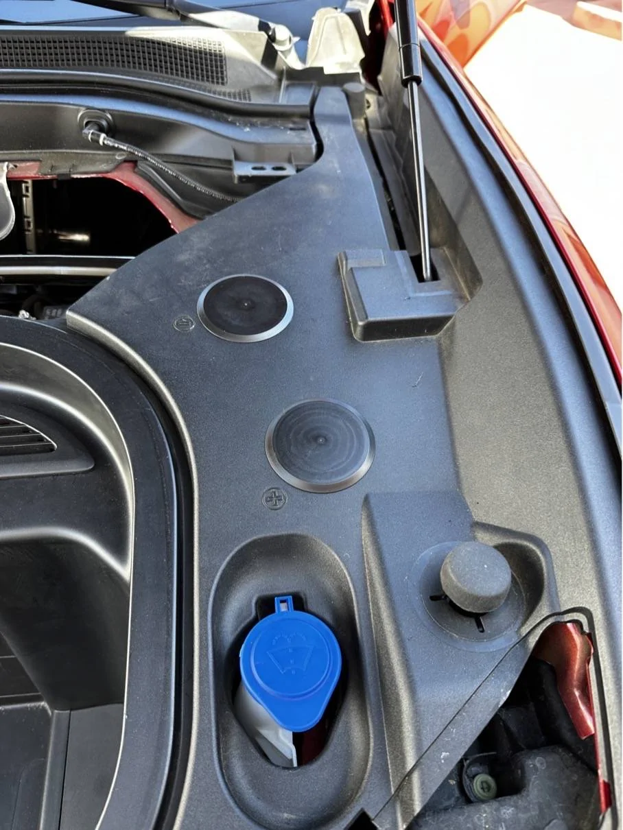

oh yeah. Also idrilled the holes for charging access.
these are the caps that I used
https://www.amazon.com/dp/B011HBY3BW?psc=1&ref=ppx_yo2ov_dt_b_product_details
