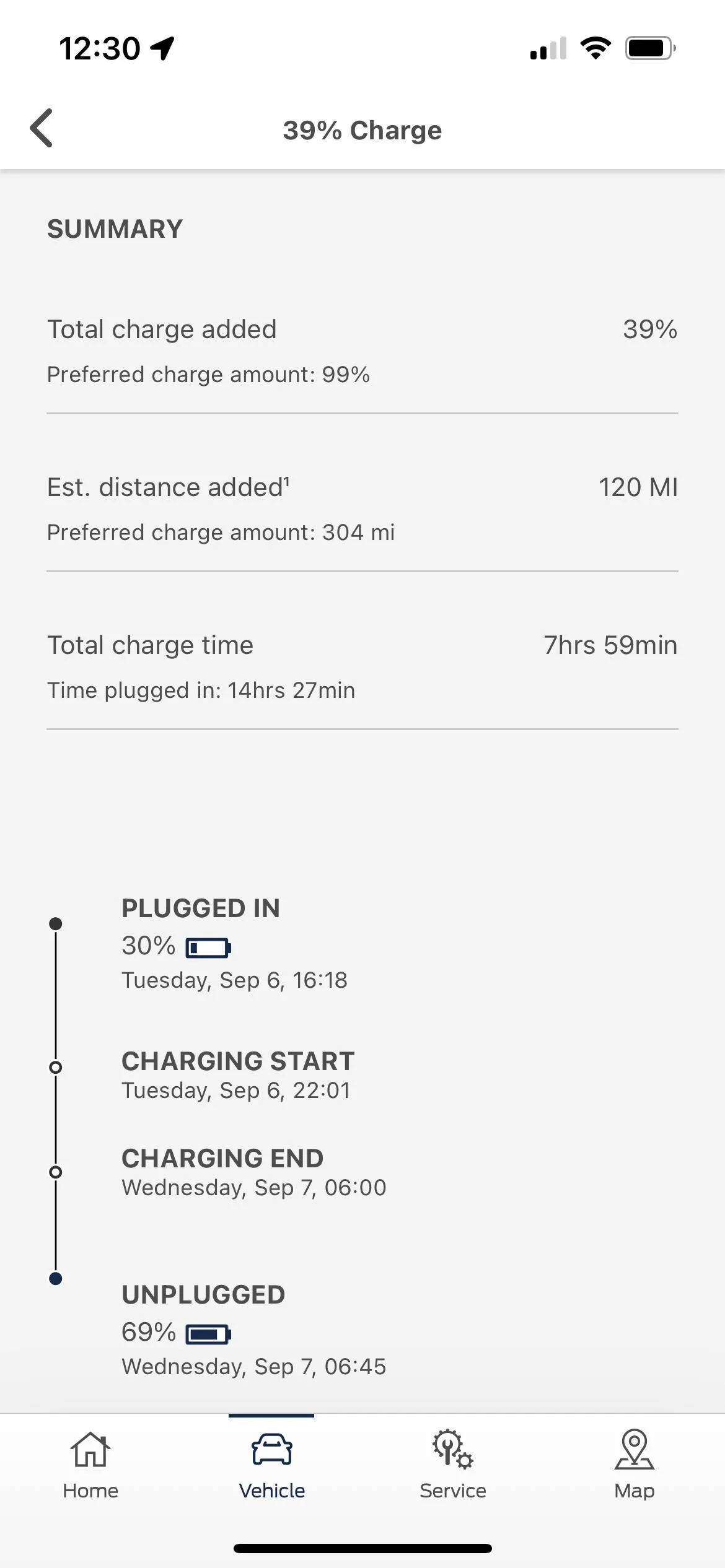

Had the car over a year and this hot interior after charging occurred for the first time. Also only reached 69% instead of promised 85% on ford level 2 overnight. Was at 30% and set to charge from 22:00-06:00. Any thoughts?

Why did I only average 15 miles per hour added during this charge and not the usual 20-22? Never happened before.

So.....what EVSE are you using?
If you are using the solid state Ford Mobile EVSE that came with the car then when it gets hot it can derate itself. What they usually do is shut off, cool down, restart, repeat. I haven't used mine at all so I don't know which method it uses to protect itself. Derate or Pause. Sounds like yours went into a lower power mode due to the heat. When it cools down it should be normal again. You can try placing a fan to blow air across the body of the EVSE.....that usually helps.

Yes, i am using the provided charger. Must have been a combination of hot Fl garage and letting battery get too low before initiating the charge thus causing over heating while charging. Usually my car feels cool upon entry like it is better insulated than ICE cars.
