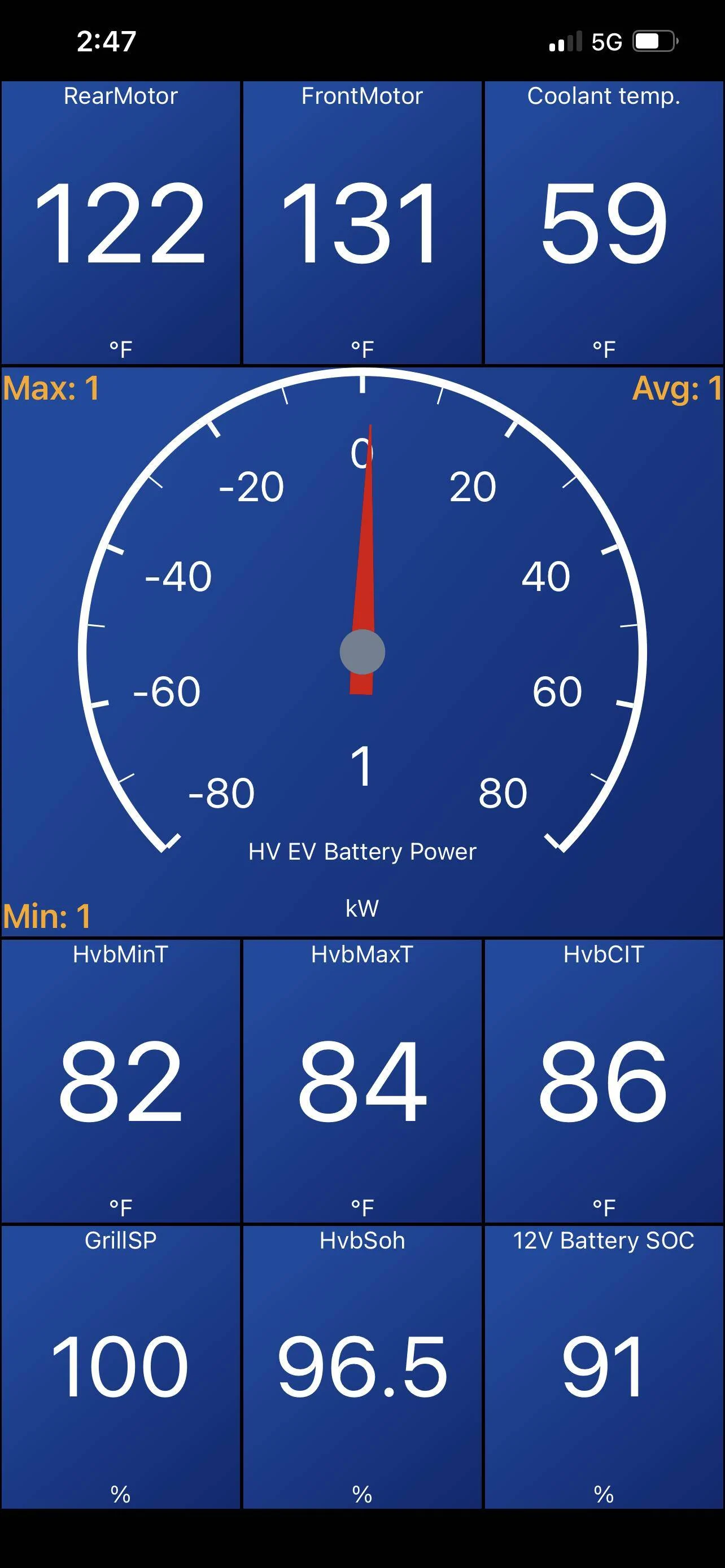

Does everyone else who uses Car Scanner Pro see the Engine coolant temperature at a constant 59 degrees F? I’m trying to find the coolant temperature for the electric motors as I thought there is a separate coolant system.
The HVB Battery inlet temperature changes but I have never seen the engine coolant temp change at all even when the primary and secondary motor temperatures change significantly.
I observed that engine coolant temperature is the same as Engine Coolant Temperature (A) at 59 F.
HVB Coolant Inlet Temperature is the same as Engine Coolant Temperature (B) which fluctuates with the temperature of the battery.

Thanks @Mach-Lee . Glad I asked the question. I’ve now figured out that there is only one coolant system and multiple loops for the HVB, rear motor, front motor and electrical systems. So it makes sense that there is only one coolant sensor.
