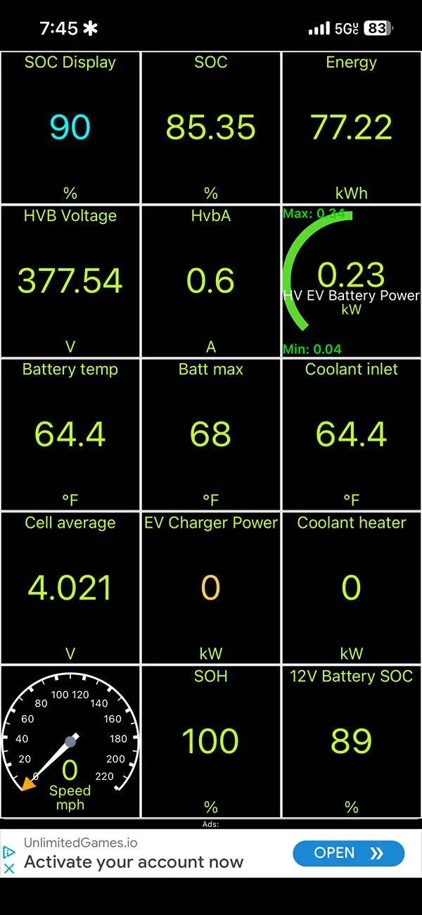

Charged my car to 90% last night. Below is what I see in Car Scanner. I have 2024 Premium AWD with Extended Range battery. I'm expecting Energy/SOC to be 91 kWh. But it's not. It's only 85.8 kWh. Can anyone explain?
77.22 kWh / .90 = 85.8 kWh.

I believe you meant you expected 81kWh. Reading is not that far off. My car’s SOC will drop a percent right after starting so I know numbers are not perfect.

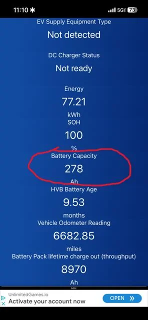

Your SOH is still 100%, what is the BECM Battery Capacity in Ah?
Looks like 278 Ah. Does that look right?
Thanks for the links. I can see this gets pretty messy, pretty fast. Still, I'm curious and I enjoy the math, so I'm going to do some more research and get some more numbers over the next few charges. I'm charging to 100% tonight. I'll see what says tomorrow.
My battery temp is 64.4F, which is below 77F (25C) "standard" temp. That seems to account for some of the difference. I found a chart (not sure its source or accuracy) that shows 88.7 kWh at 65F. My 85.5 calculation is close, but I still wonder about nearly 3 kWh... Not going to lose any sleep over it, but I'm going to dig a little more on this. Mostly because it's fun stuff.
Oh, I see what you did. I was confused. Yes, 90% SOC of 91 kWh would give an expected energy of 81.9 kWh, where I see 77.22 kWh. Still a bit off, I think.
But what I was doing is working backwards. Given a SOC of 90%, and energy of 77.22 kWh, what would be the energy at 100%? 77.22 / .9 = 85.8.
Anyway, it gets more complicated with temperature a big factor. So, I'm probably in the ballpark...

Yes, and the 278 Ah battery capacity is probably correct, too. We don't know the reference value for brand new vehicles, as this variable appeared quite recently in Carscanner.
