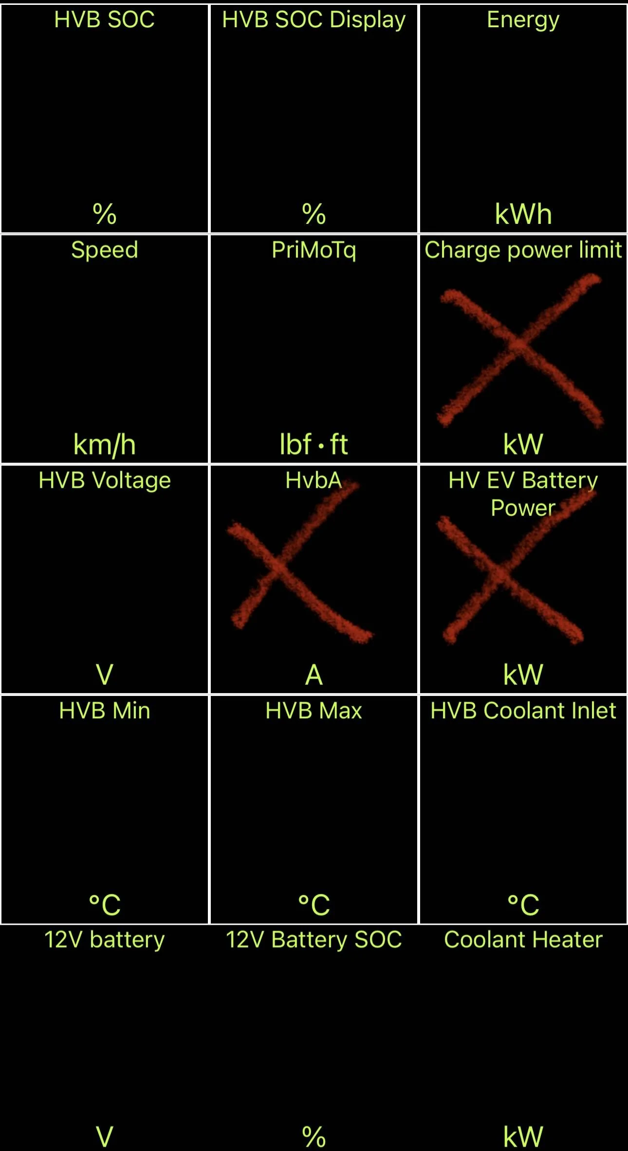

I’ve used other apps before for other cars like this, but I just installed Car Scanner to get details on battery temps and charging etc.
There are three boxes that don’t show any information. They remain blank all the time but everything else works and updates perfectly.
Anyone have any idea why? I just got the car, so it’s a 2023 Select with LFP.
Attached is a screen shot, the ones with the X are the ones that don’t work.
thanks!

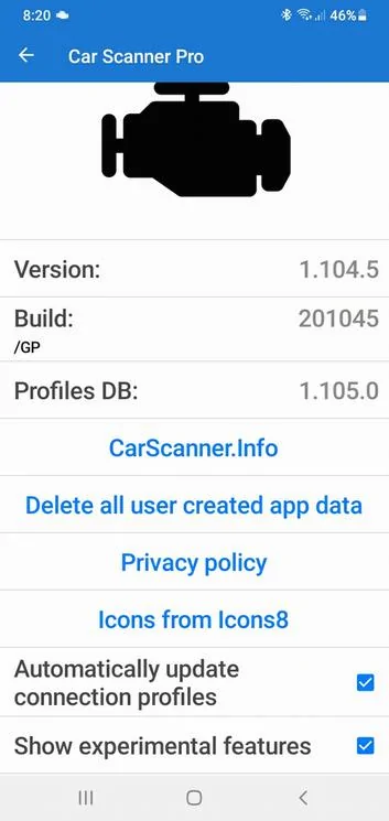

Not noticing any problems for my setup.
Adapter: vLinker MC+
CarScanner Pro
Ford Mustang Mach-E Car scanner app not showing some information CarScanner Information
2023 Select (MFD: 12/22):
06/15/23: 4.2.4
06/30/23: 4.2.5
06/30/23: Customer Satisfaction Program 21B36
07/13/23: 23-PU0314-DCM-LAT
07/15/23: 23-PU0105-DC-CHG2
09/25/23: PowerUp 5.1.1
10/18/23: PowerUp 6.1.0
11/06/23: PowerUp 6.2.0
11/06/23: 23-PU1103-NAT-VCE
12/08/23: PowerUp 6.3.0
12/14/23: PowerUp 6.7 **** INCOMPLETE ****
02/20/24: 23-PU0722-DC-CHG3
02/22/24: 24-PU0102-SVD-FX

Ok I just figured it out. I just had to customize the screen a bit. The ones that are there by default are the wrong sensors (at least for this model year). So I just looked through the sensor list while charging and replaced the ones that weren’t working.
Just curious, which profile were you using? Wouldn't think the Mach-E & Lightning profile would have the wrong sensors.
redgrandam
Jay
Feb 23, 2024
230
241
Southwestern Ontario, Canada
2023 Mach E Select
Just the default after selecting the Mach E profile. Possible I didn’t set the layout up right… I’m new to the app so not totally sure. But I definitely selected the right sensor profile.
