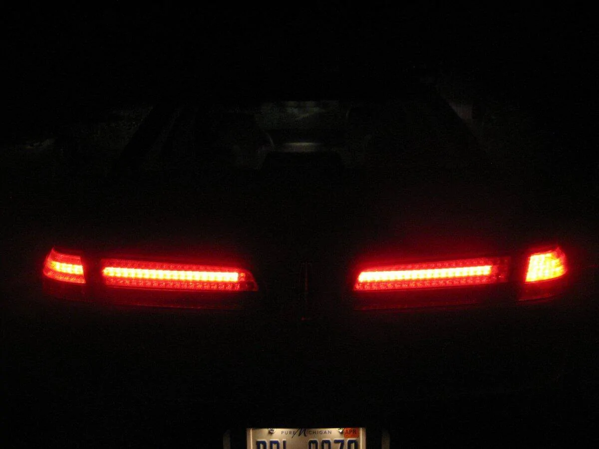

Depends on how closely they decided to make it work like an ICE car brake lights would. When coasting in an ICE car, there will be a slightly negative acceleration (wind resistance, etc), but of course no brake light until your foot touches the brake pedal.
There may even be federal regulation that EVs have to show brake lights at a certain threshold of negative acceleration.
I always thought it would be useful if there was a brightness threshold based on how much brake was being applied. Like dimmer for slight braking, and much brighter for heavy braking. I see these people around here with the brake lights mod that flash their lights like an emergency vehicle would. I assume those mods are illegal?
My thought was to increase the length of the lights with heavier braking.
Ford Mustang Mach-E "Car Scanner" (OBD software) now supports Mach-E 1667314570193
Either way, a person behind you needs to understand what's going on, so it's pretty much hopeless.
