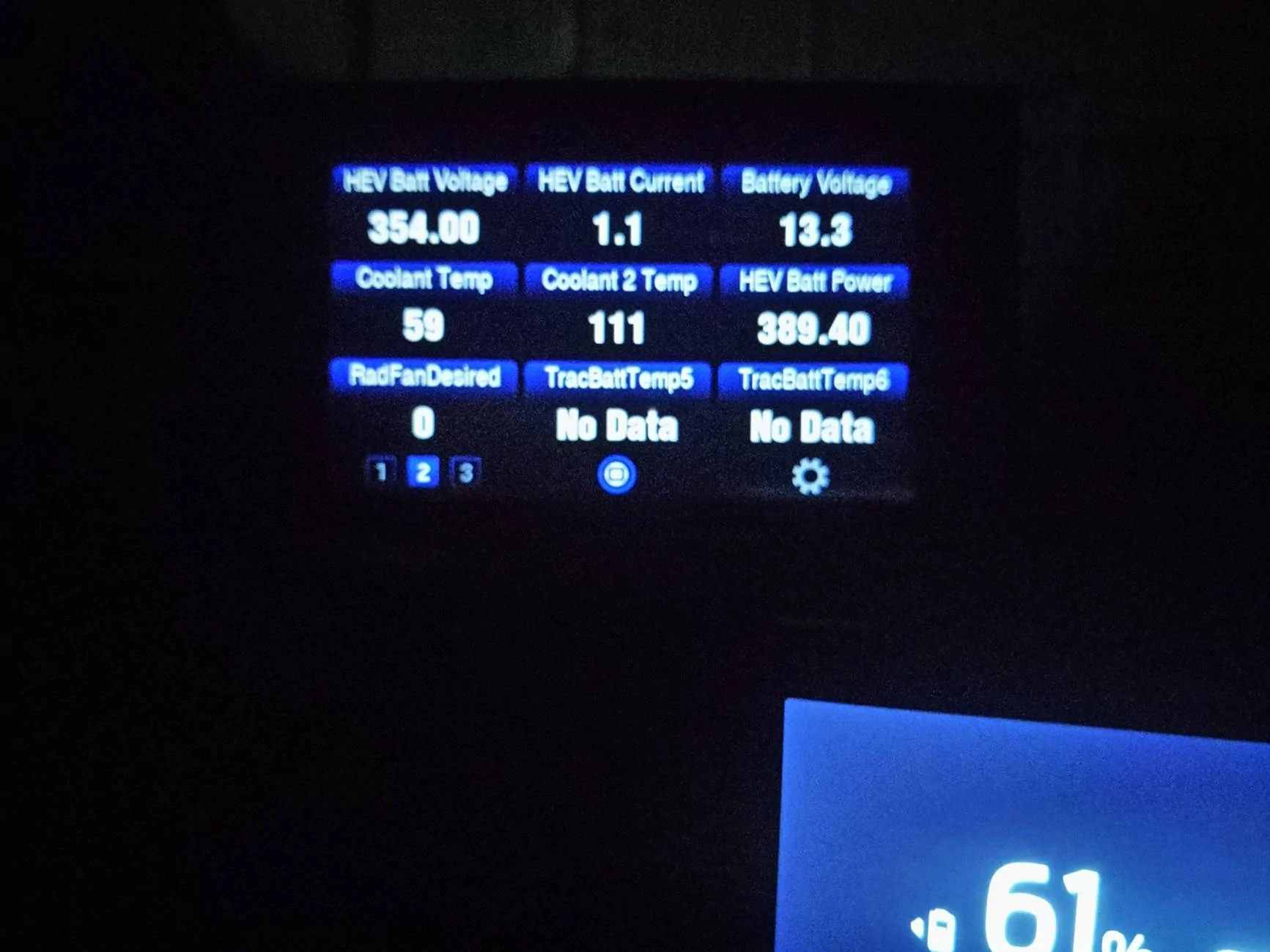

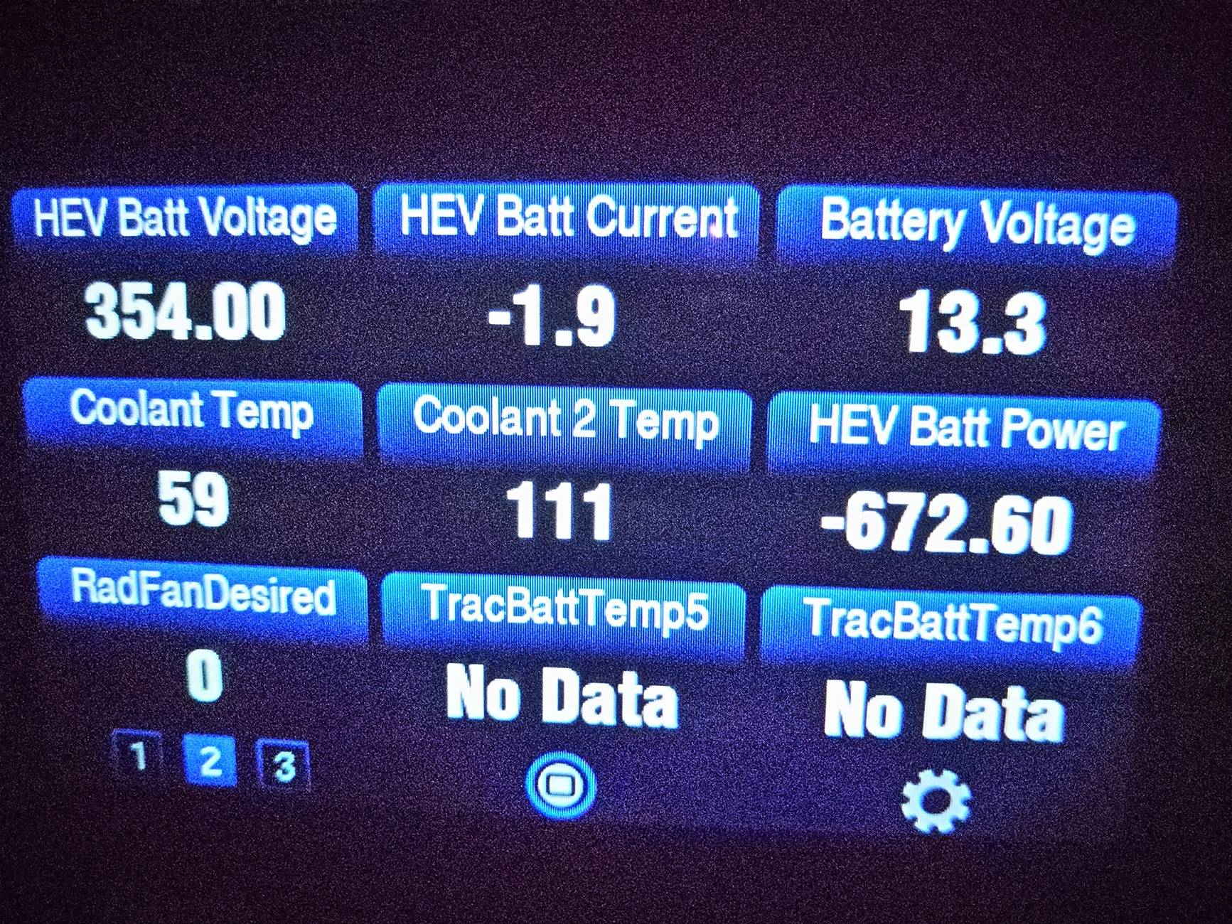

I just moved my ScanGauge from My I-Pace to my 2025 Mach e because the Jag is being bought back next week due to 8 battery fires of 2019s. I could monitor the battery cell temps with the ScanGauge. Most of the points, I had ScanGauge, the Company, research and gave me the numbers to watch these parameters. I hooked the ScanGauge up to the Mach e and did a search for any recognized points, it uses my home modem to do this. Bingo! It came up with: Ambient temp, Battery Voltage(12v), coolant temperature, HEV Battery Current, HEV Battery Voltage, Barometric Pressure, coolant #2 temperature, gross Horsepower, HEV battery power, Hybrid State(?), odometer, speed, & instant MPG(?). The points work. Pics of charging and not charging . The suction cup mount works on the smooth dash! I mounted it next to the drivers door jamb. The Scangauge is great for displaying pids that you already have the info about. You can't find unknown pids using it due to the programing of the points. Below is the pid programing for the Jag's Traction battery volts on the Scangauge.
