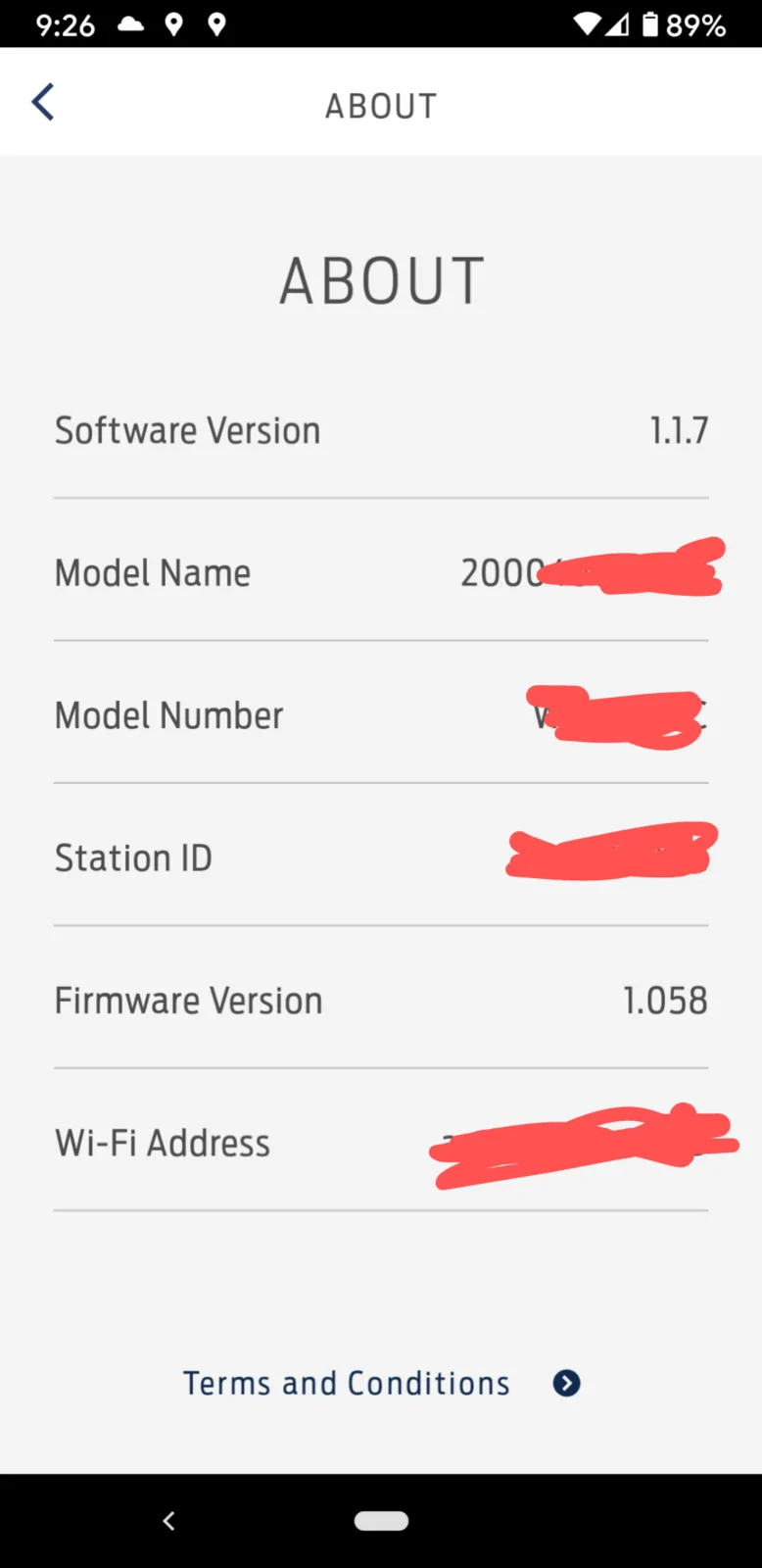

I had this happen with my home Ford Connected Charger. It turned out the charger was locked. You can open FordPass, More, Your Connected Charge Station and make sure the lock slider is set to unlocked.
