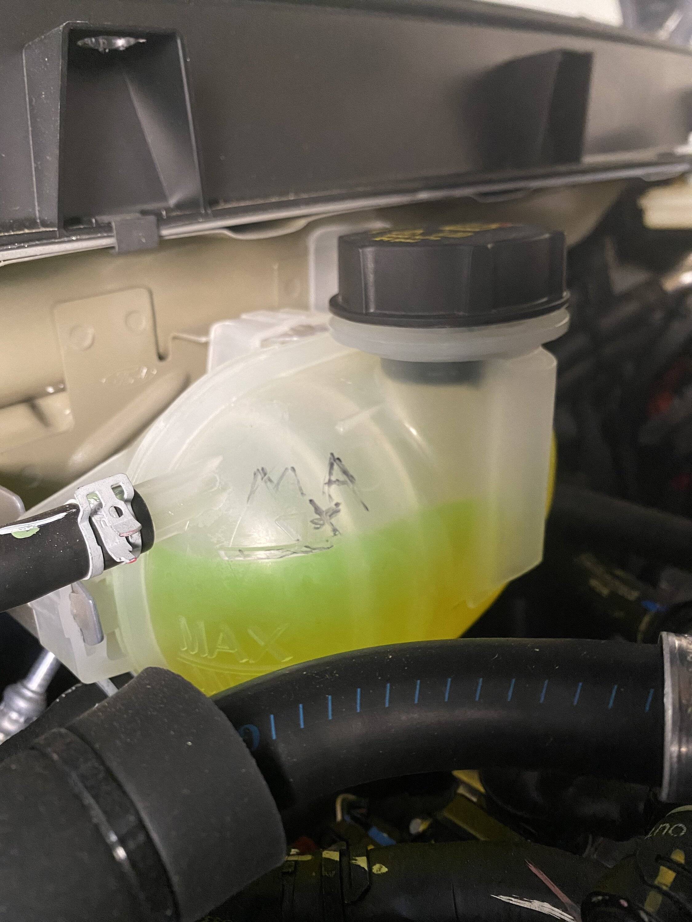

My 20 months old 22select motor coolant was about an inch about the min mark and the battery coolant in the middle of max and min. So I decided to top both off. Got a gallon of yellow motorcraft anti freeze from a ford dealership.
Ford Mustang Mach-E Coolant color IMG_5216
But the manual calls for VC-13DL-G, I though DL stranded for pre diluted so I mixed it with equal amount of purified water then added it to both coolant reservoirs. To my surprise the added coolant look greenish compared with the stock one in the reservoirs. Did I add the wrong thing?
Here is how they look in the reservoir. The top layer is the new coolant, it looks greener than the bottom layer which is the stock one
Ford Mustang Mach-E Coolant color IMG_5218

Motorcraft Yellow coolant is kinda strange, it can look either green or yellow depending on the dilution, pH, and how much air is entrained. What you see there is normal, I've seen the same thing.

You used the right coolant. It's a highlighter yellow when new but fades to a more pale color as it ages.

The yellow-green color comes from Fluoresceine. The dye is extremely common as it is relatively non-toxic, breaks down into pretty harmless compounds, is absurdly cheap, and has a fluorescence near the peak sensitivity of our eyes. As a result, you will see it used everywhere.
It's big drawbacks are that it photobleaches (stops fluorescing upon sustained exposure to light) and the color can shift based on the solvent, the pH, temperature, and pretty much every other chemical factor you can think of.
Source: Chemist who has made loads of fluoresceine conjugates.
