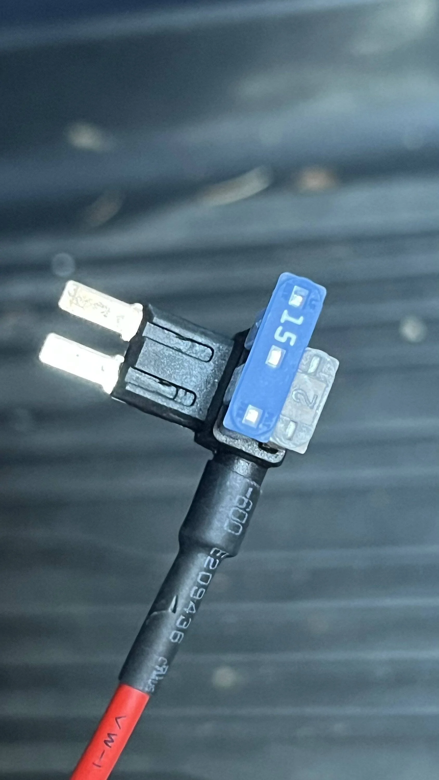

Tony, was a standard ‘ebay type’ micro3 tap used, do you happen to know? when we tried the micro2 into slots 5 or 13, it was a very tight fit, nudging the neighbouring fuse. Did you encounter any issue?

I bought the Nextbase wiring kit as part of an overall Nextbase package deal - and that wiring kit had 4 different tap types to choose from. One of them was a perfect fit but I can’t remember which one I ended up using ?

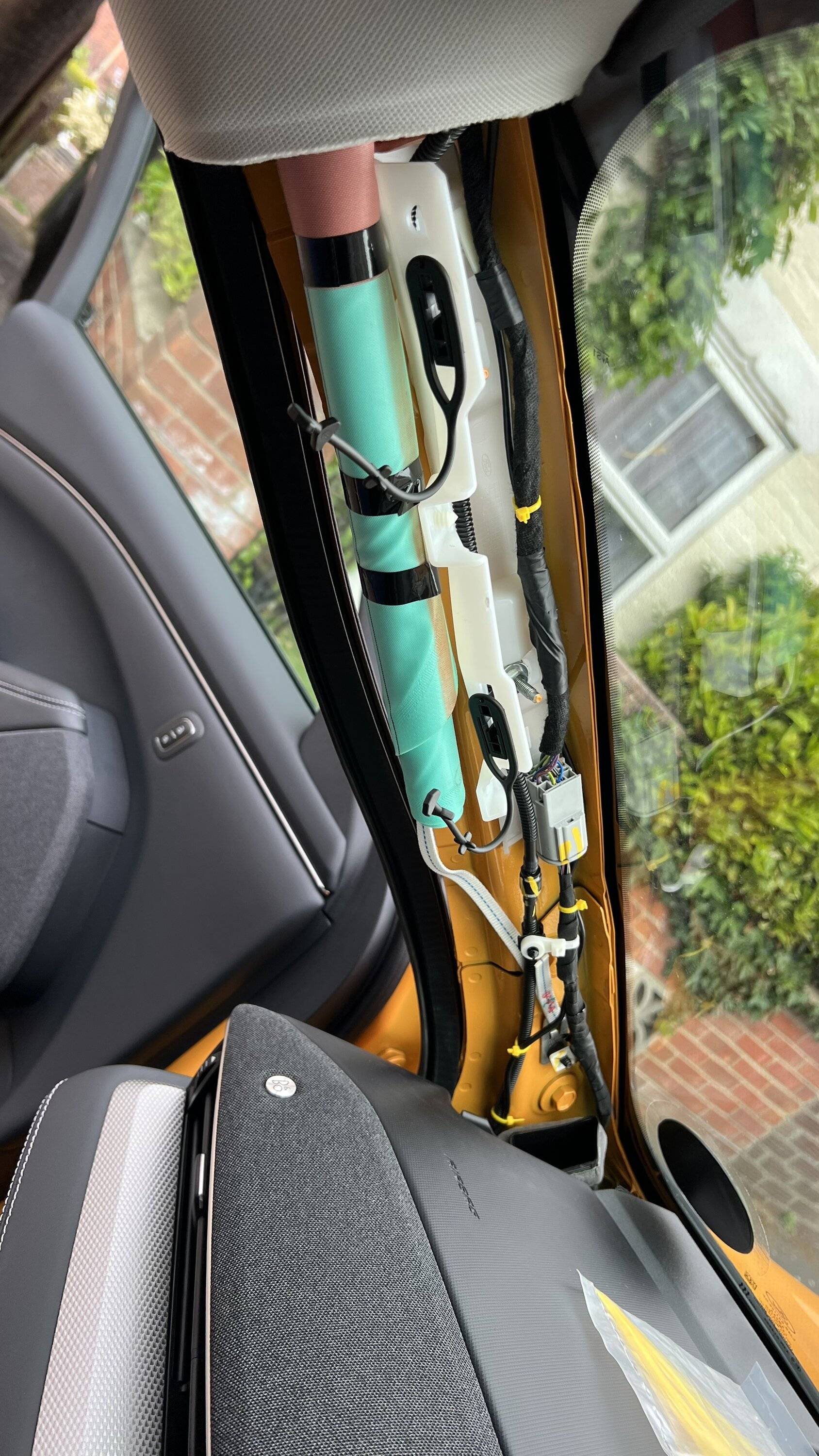

No issues encountered during install thankfully, just took it steady and made sure I took care with the A pillar trim removal and reinstatement. Wiring carefully threaded and secured so not to cross over the top of an airbag deployment area. (using yellow cable ties on existing wiring looms)
I think it took me about an hour in the end.
That was 5 months ago now - all still good and no issues.
Ford Mustang Mach-E Dashcam DED888CA-BCC2-4D84-8777-C4BD76801EFA

Very neat job and good idea with yellow cable ties as makes the additional wire obvious.??

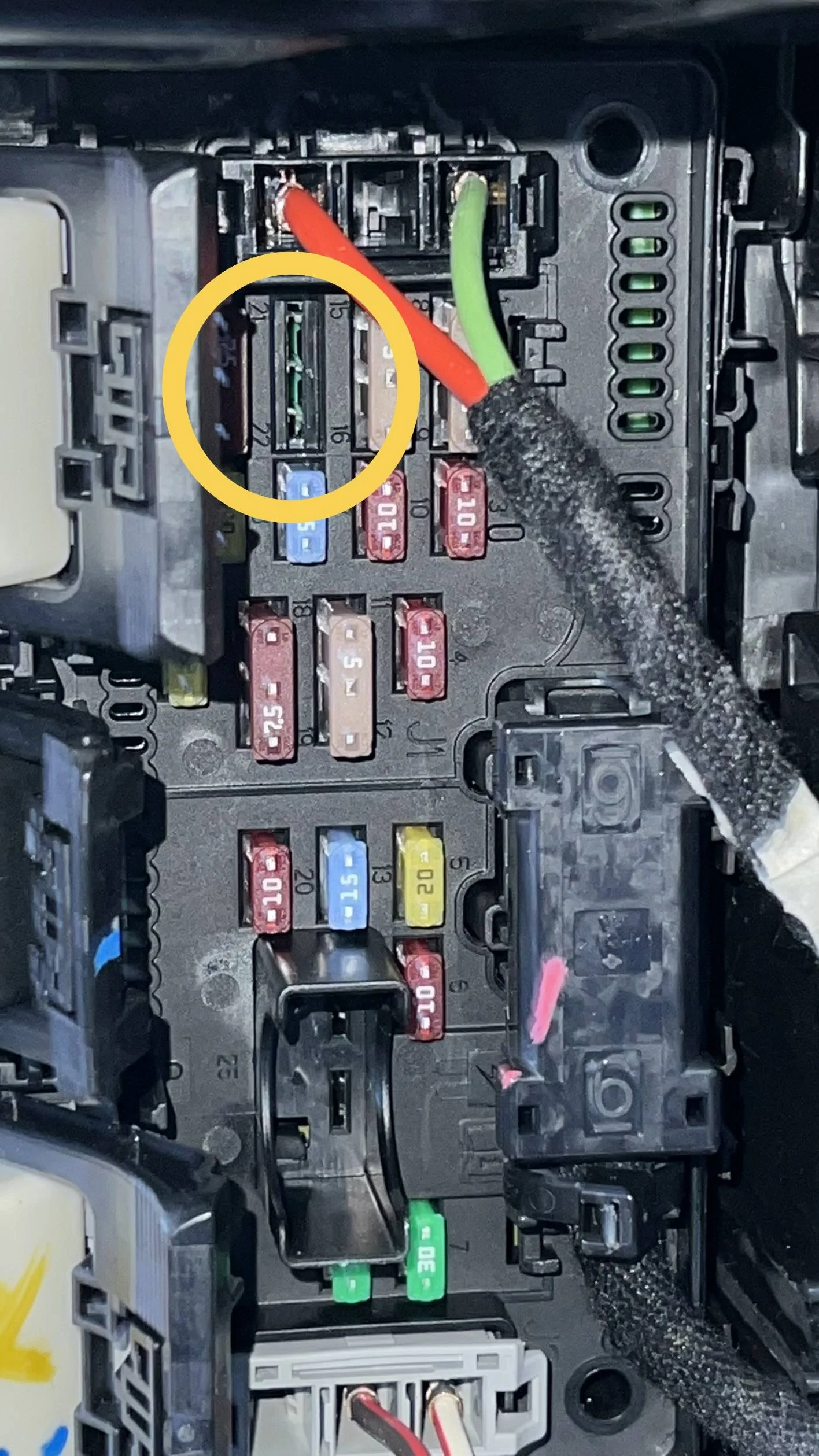

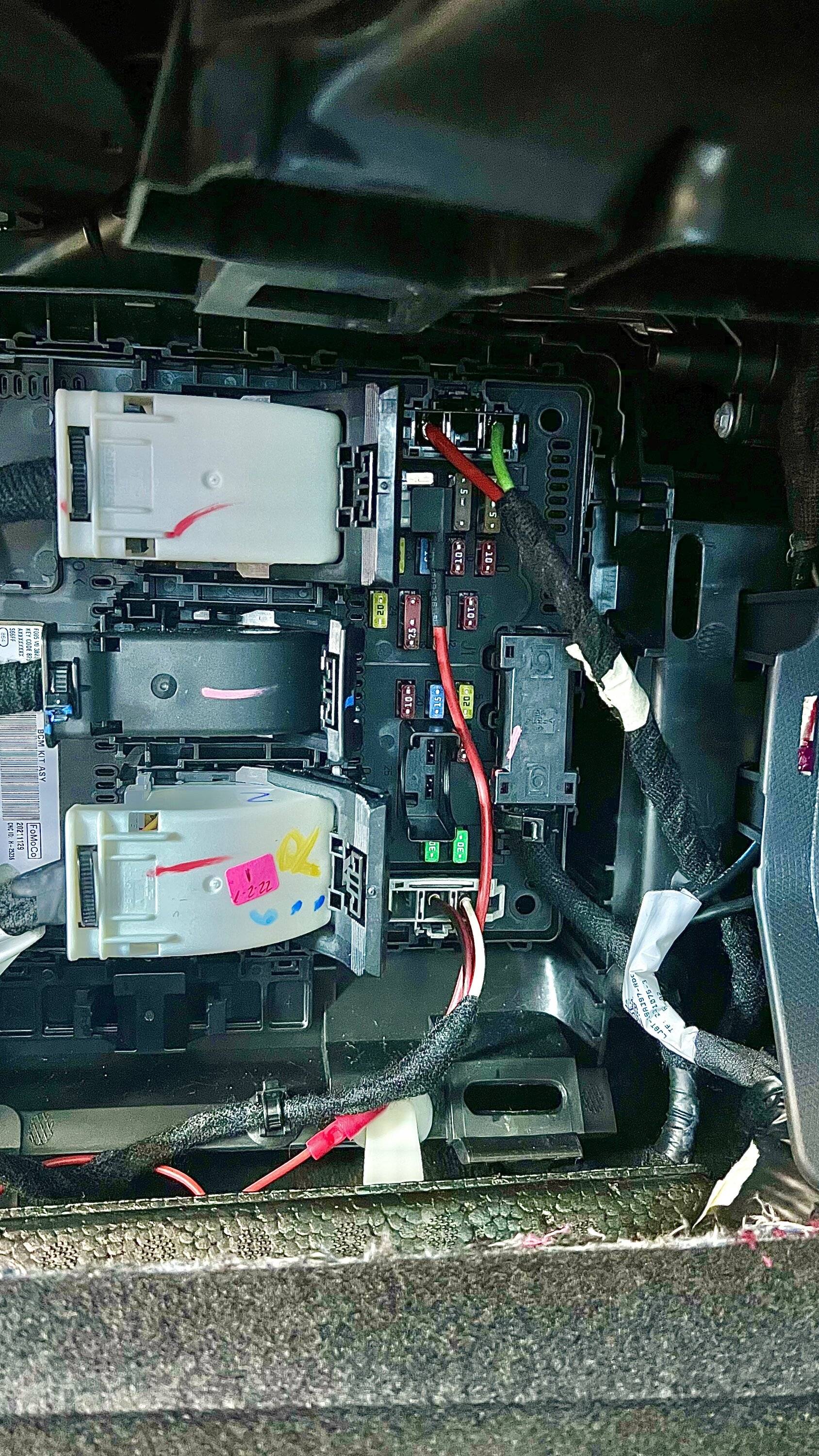

As promised heres the wiring in the fusebox…
Ford Mustang Mach-E Dashcam 3CBA394D-7867-453E-B791-5EAA770EC23F
Ford Mustang Mach-E Dashcam D5EC5151-6867-4414-A7D5-06413D2E3248
Ford Mustang Mach-E Dashcam 7C119352-EB86-439E-AABA-72C1CF98B9DC

Thanks so much for taking the time to post the pics. Great stuff??
