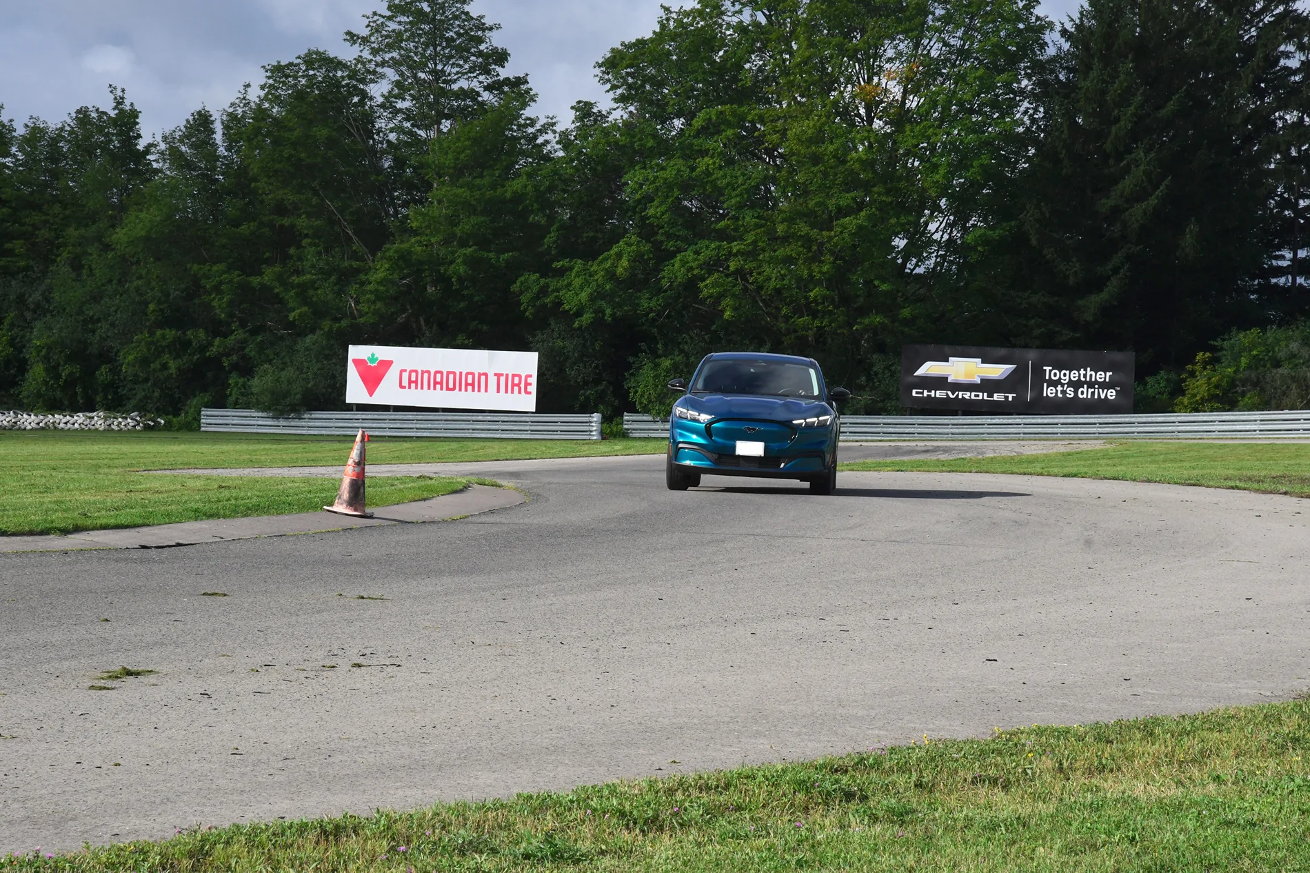

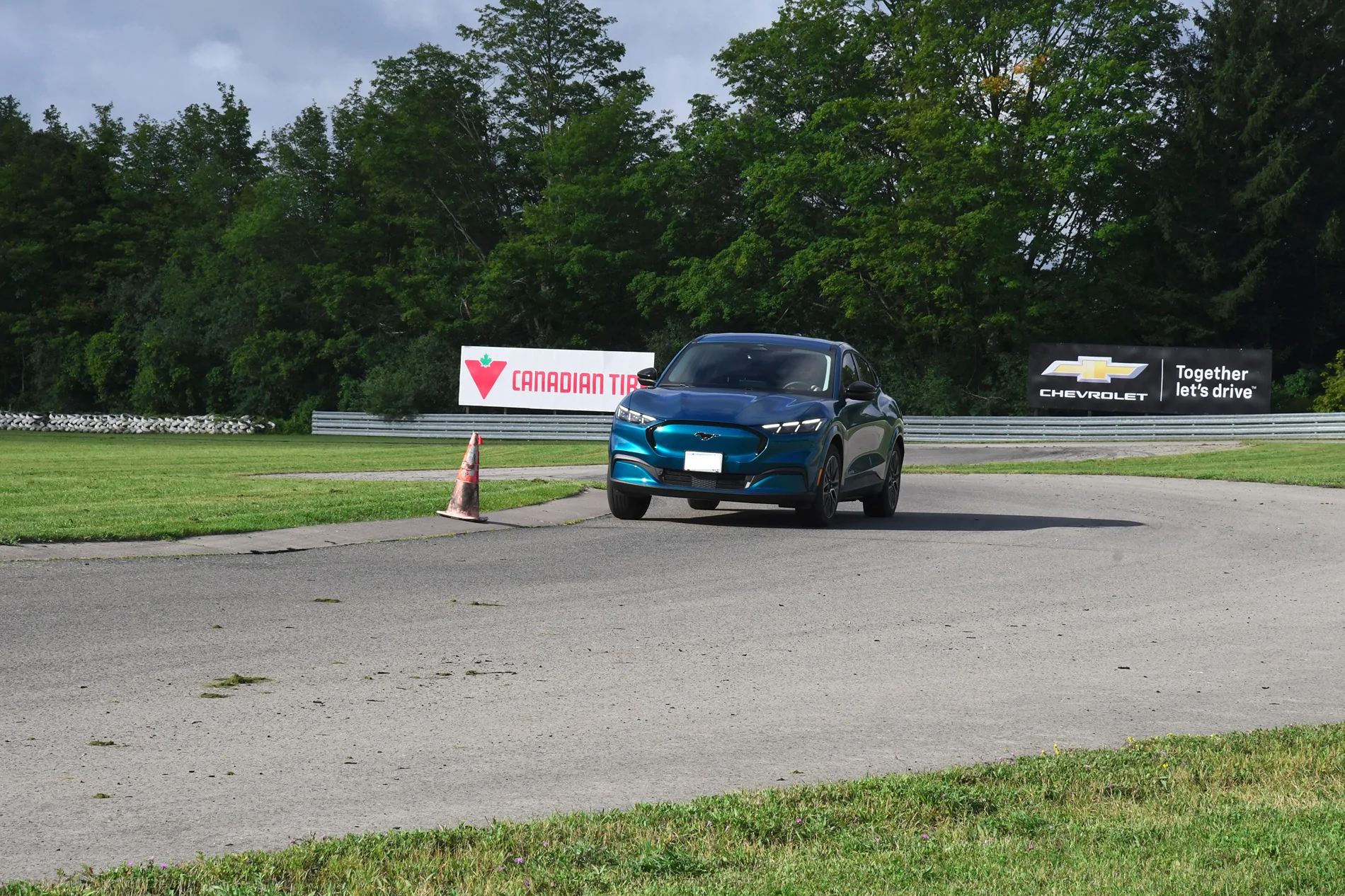

Does it lean?

Swap out your factory sway bars for some Eibach sway bars, and ditch the factory end links for quality adjustable ones… (use Red thread lock after adjustments)… {I replicated the factory lengths} Will make a noticeable improvement…

The Eibach antiroll bars transform the car. I didn’t change endlinks so I can’t say how much better they make it. And unless you wanna be “Flirtin with Disaster” wider wheels with wider tires are in order! Enjoy the car!
