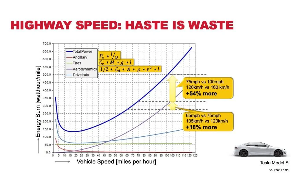

Some of them are counter-intuitive, but these help efficiency:
  1. There is little/no difference between 1-pedal driving and regular 2-pedal driving. The computer in the MME blends the regenerative braking with the friction braking. Moderate braking is done entirely regeneratively. As a result, the friction brakes are hardly ever used with 'normal' driving, whether with 1-pedal or default mode. Teslas are the only EVs that do not have blended braking.
    Regen is only maximized by smooth braking. The accelerator pedal is a little harder to control than the brake pedal. Unless you have a very steady right foot, 1-pedal driving is often slightly less economical.
  2. The AC does not use that much energy: Between 500 Watt and 1000Watt. It is not worth sweating in the heat for. The e-heater does use a lot of energy. So turn e-heat off and use seat heater in cold mornings.
  3. Cruise control is a good idea because it makes for smoother driving, also on local roads.
    The main way to save energy is to drive slower on the highway. The difference between 65MPH and 75MPH is a whopping 18% more usage per mile.
  4. Smooth and slow driving is the key to maximum range. For that reason, whisper mode is the one to use, and unbridled is better avoided. Regen gets less efficient with harder braking, so the Unbridled mode is not a good idea. If needed the increased regen from Unbridled can also be achieved by gently pressing the brake pedal in whisper mode.
  5. Pump up your tires to a higher PSI. Do not carry unnecessary weight.
Ford Mustang Mach-E Driving with the most efficiency Screen Shot 2022-05-23 at 16.37.22
