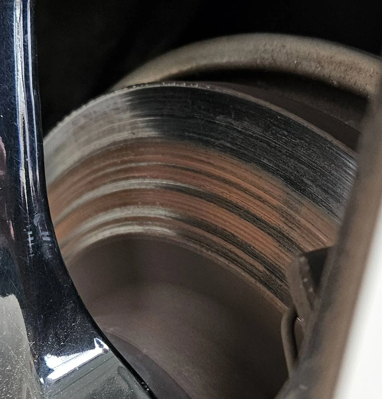

This is what my rear disc looks like, and i can see lines within the dust/oxidation
Ford Mustang Mach-E Dust on rims IMG20250401161225~2
505
14,330
28,706
1 pedal makes no difference in friction brake use on the MME. The MME uses hybrid braking, and will always start with regen and add friction braking as needed even if you press the brake pedal.
Not true. There is a limit to how hard you can brake with 1PD. However, mashing the brake pedal hard will result in friction-only braking.
1PD = minimal brake dust
2PD with gentle braking = minimal brake dust
2PD mashing the brake pedal = lots of brake dust
