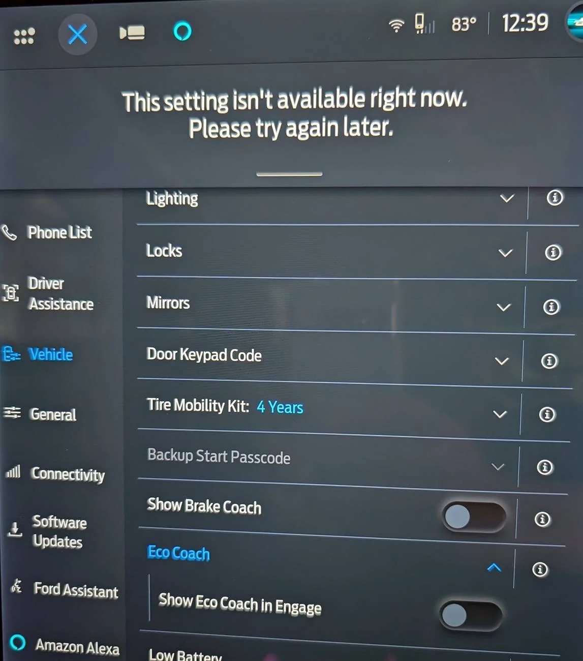

It was in the APIM module - search for "coach" and turn on the one that says "eco coach in go mode"
That turns it on -if I remember right there's an additional option to turn on the Setting as well so you can toggle it via the center panel.
Can you confirm the changes were made to address 7D0-09-04? I'm looking at the FORScan spreadsheet and that is the only Eco Coach setting I see.
I don't F w/ the as-built view.

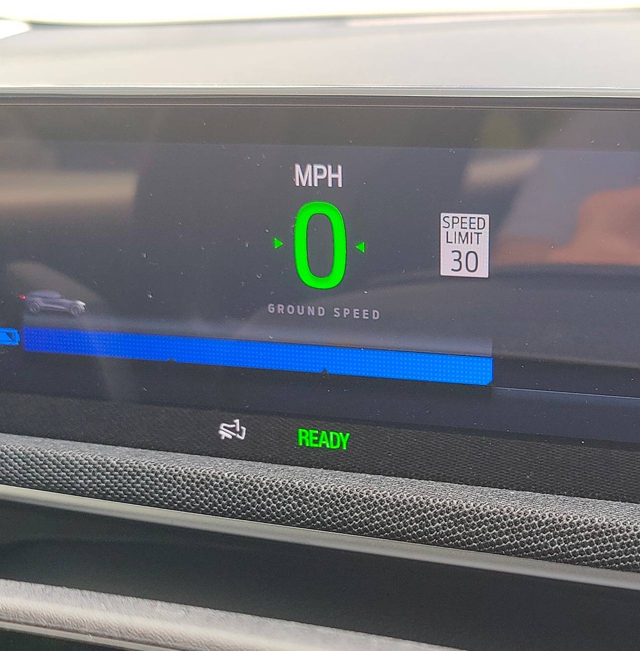

I enabled this yesterday, and here it is. Ok. Cool.
That speed limit indicator just to the right is a bit annoying, and I ask if there might be a setting to disable it.
I know that it comes on in highways, but it never did on normal streets. This mode being on seems to have turned it on.

May give it a go here in the good ol’ UK if it worked here.
