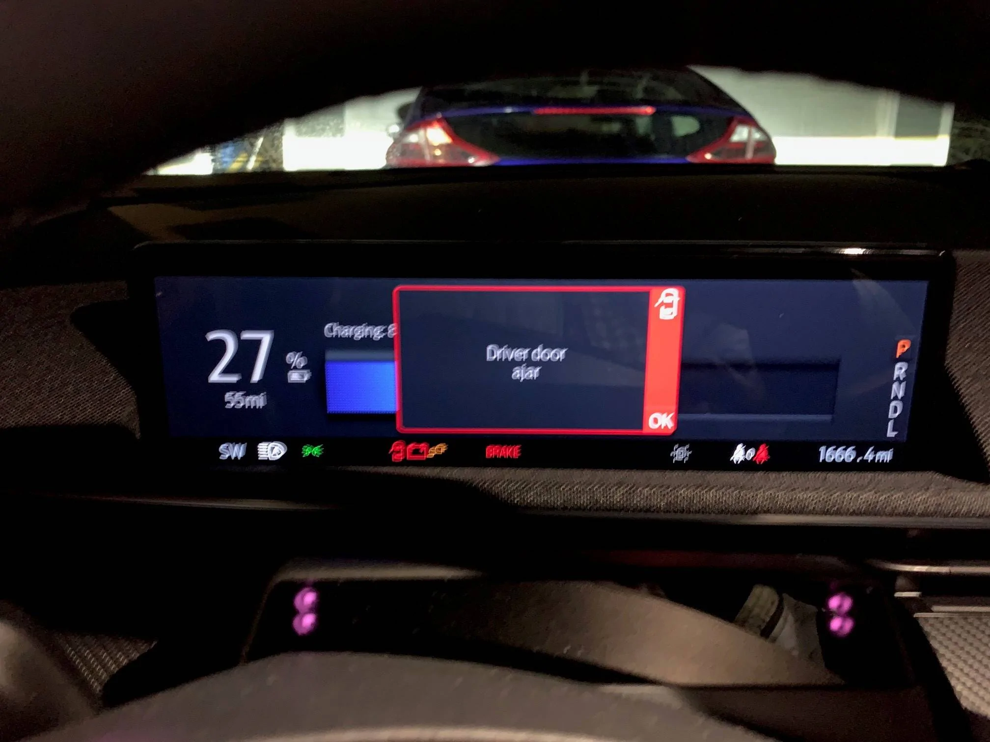

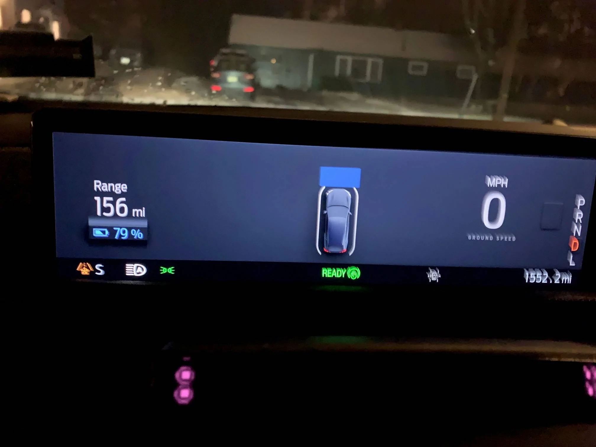

After returning home The car took exactly 46.76 KWh to recharge from this trip back to the original starting percentage. This is the gross reported out of my ChargePoint charger (from the charger software) to the Mach E. That corresponds and matches nearly exactly to the battery percentage used for this trip 79% to 27% which is very close to 52% of an 88 KW (.52x88, Battery size) or 45.76 kWh. (So strange this came out this way a 2% or 1 kW difference). This calculates to 2.5 Mi/KWh for the trip. So only 1 kW for internal charger losses, or 2% ?

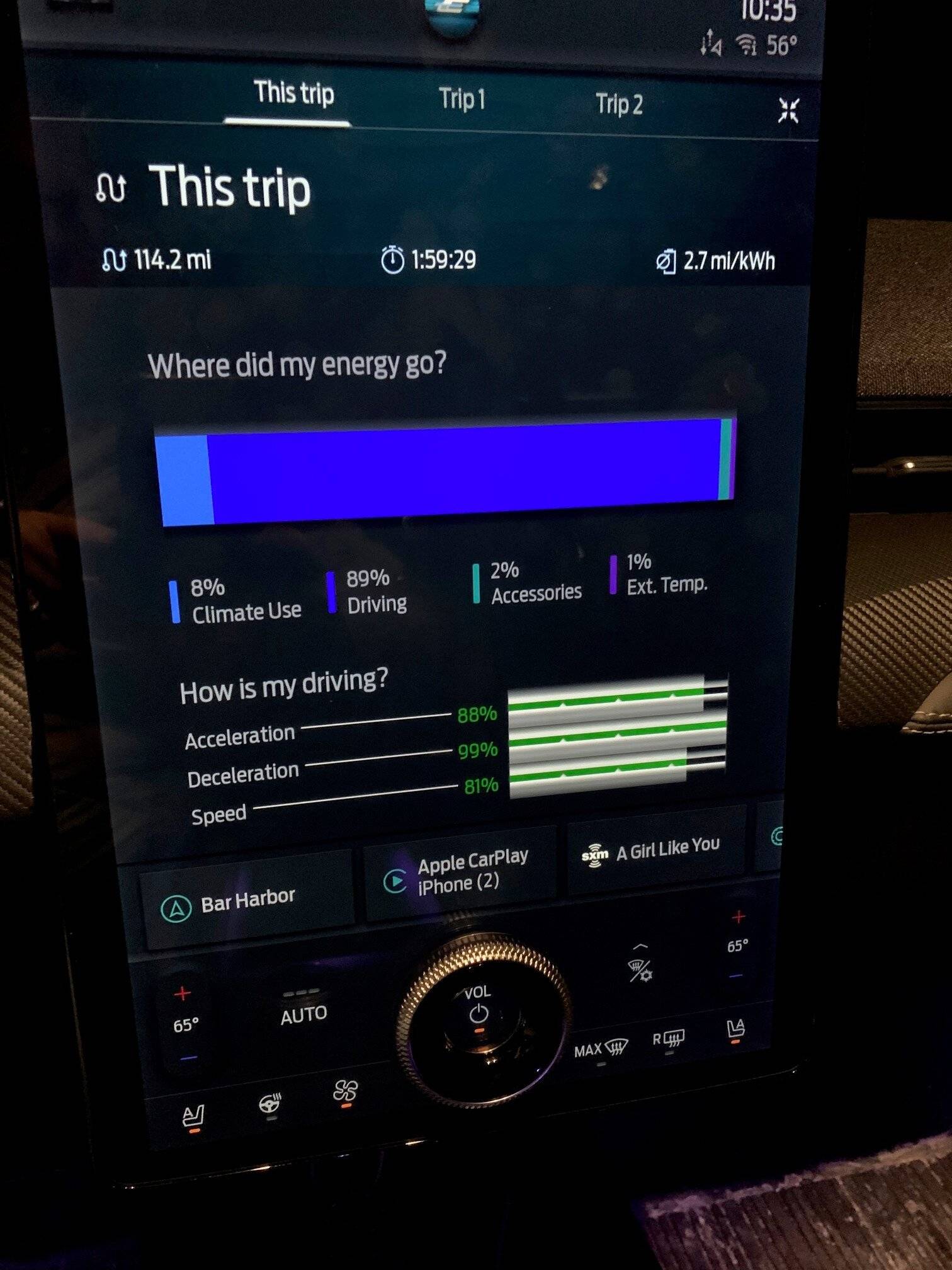

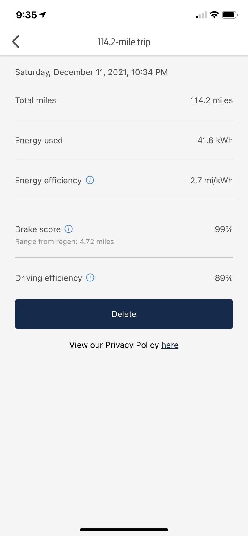

The strange thing is My EV data on FordPass shows I actually used 41.6 KWh for this trip (or 47% of the battery). If I divide the miles driven (114.2), I get the 2.7 mi/kWh reported by the car. It also notes a "driving efficiency" of 89%.
If I assume 9% for internal charger losses (What I saw on my Select for 11,000 miles and verified), that actually equals 45.7 kWh. (41.6/.91). These calcs are too close to perfect. But………
With this data working out like it is, I would have to assume the % battery display in the Mach E includes and added 9% factor for charger losses and our Mi/KWh on the display takes that factor of 9% away.

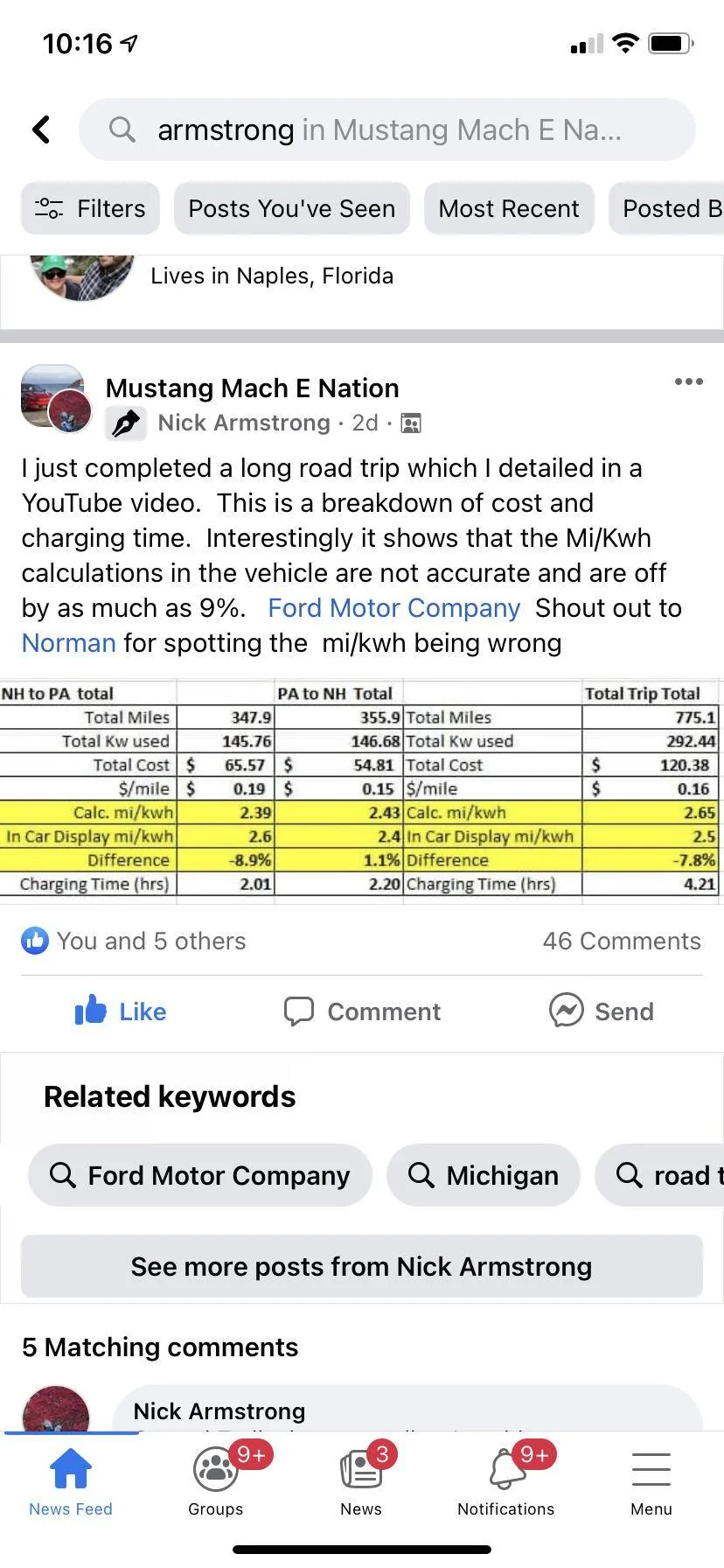

A FB Mach E Nation member Nick A found similar results on a long trip with his Select noted attached.

Battery % Start. 79%

Battery % End. 27%

Overall trip 114.2 Miles 57.1 MPH 2.50 calc’d efficiency , 2.7 mi/kWh Display Efficiency. 7%-9% Error.
