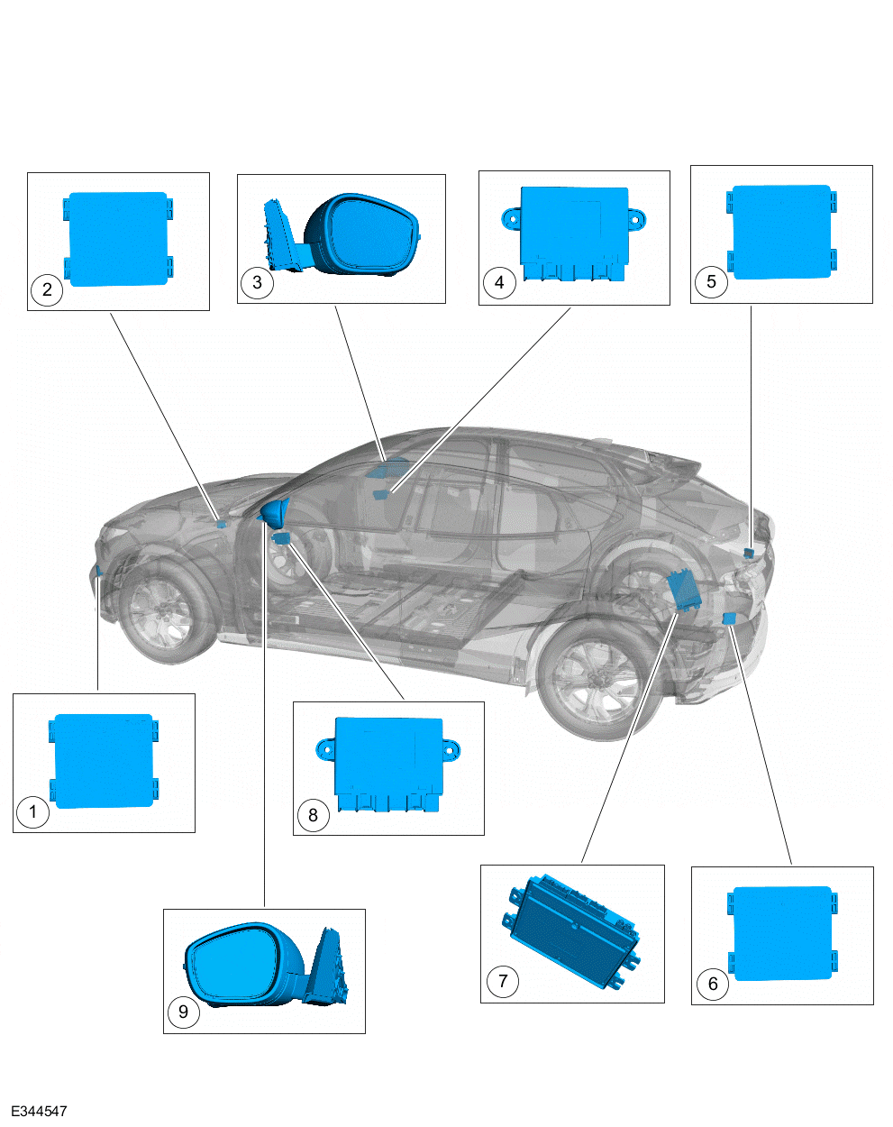

The radar units are located in the 4 corners of the vehicle, 1, 2, 5, and 6 in the photo. There is no radar in the side mirrors, just an indicator light.
Ford Mustang Mach-E False positives in Blind Spot Detection: Anyone else seen this? Radar
The radar shouldn't care if it's day or night though, so that's the odd part. I could see the bike rack blocking the rear sensor visibility but this seems to be triggered by light, so a camera?
