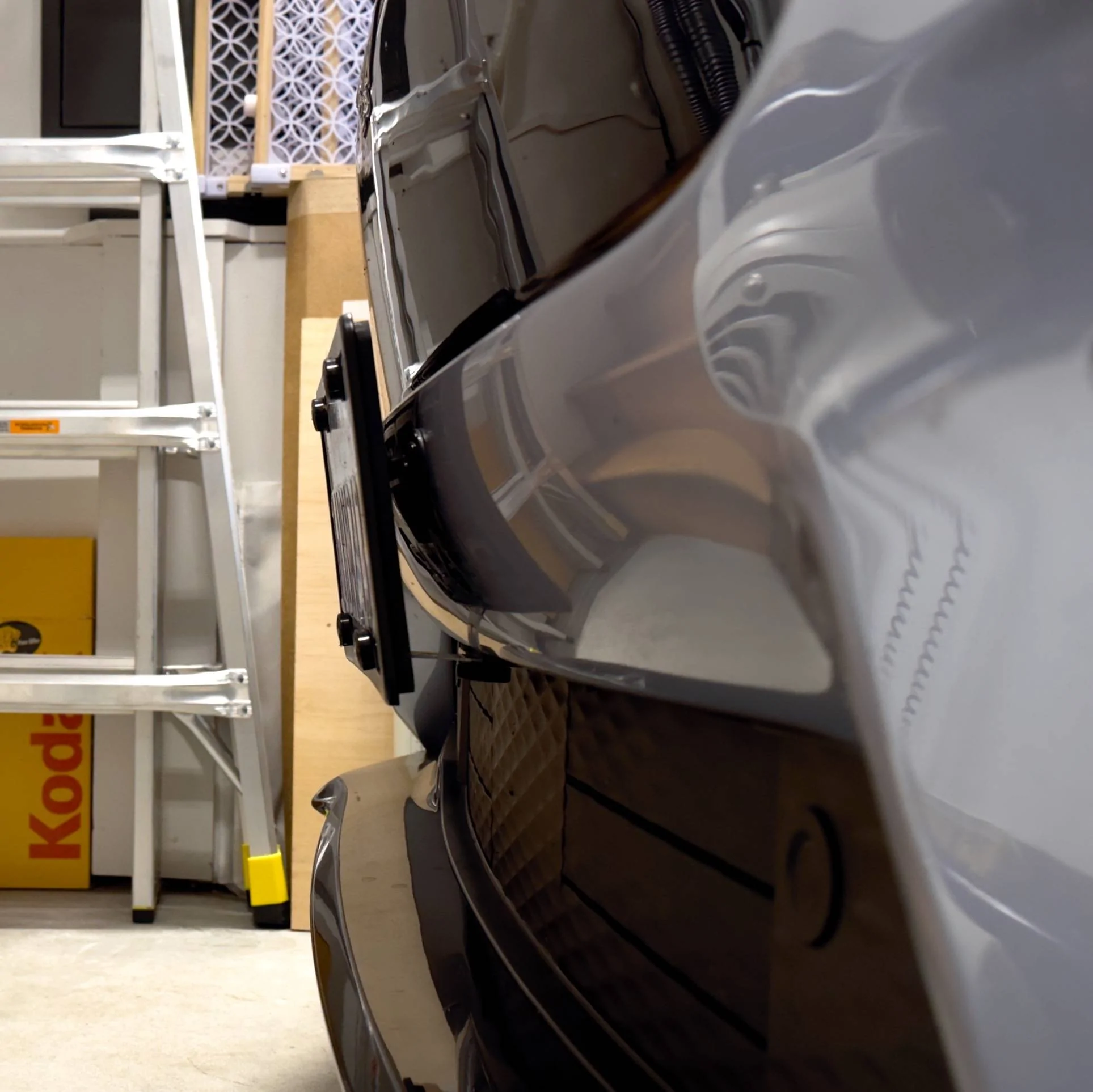

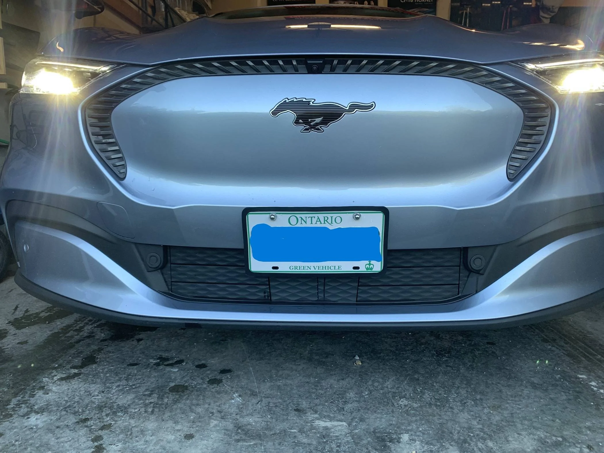

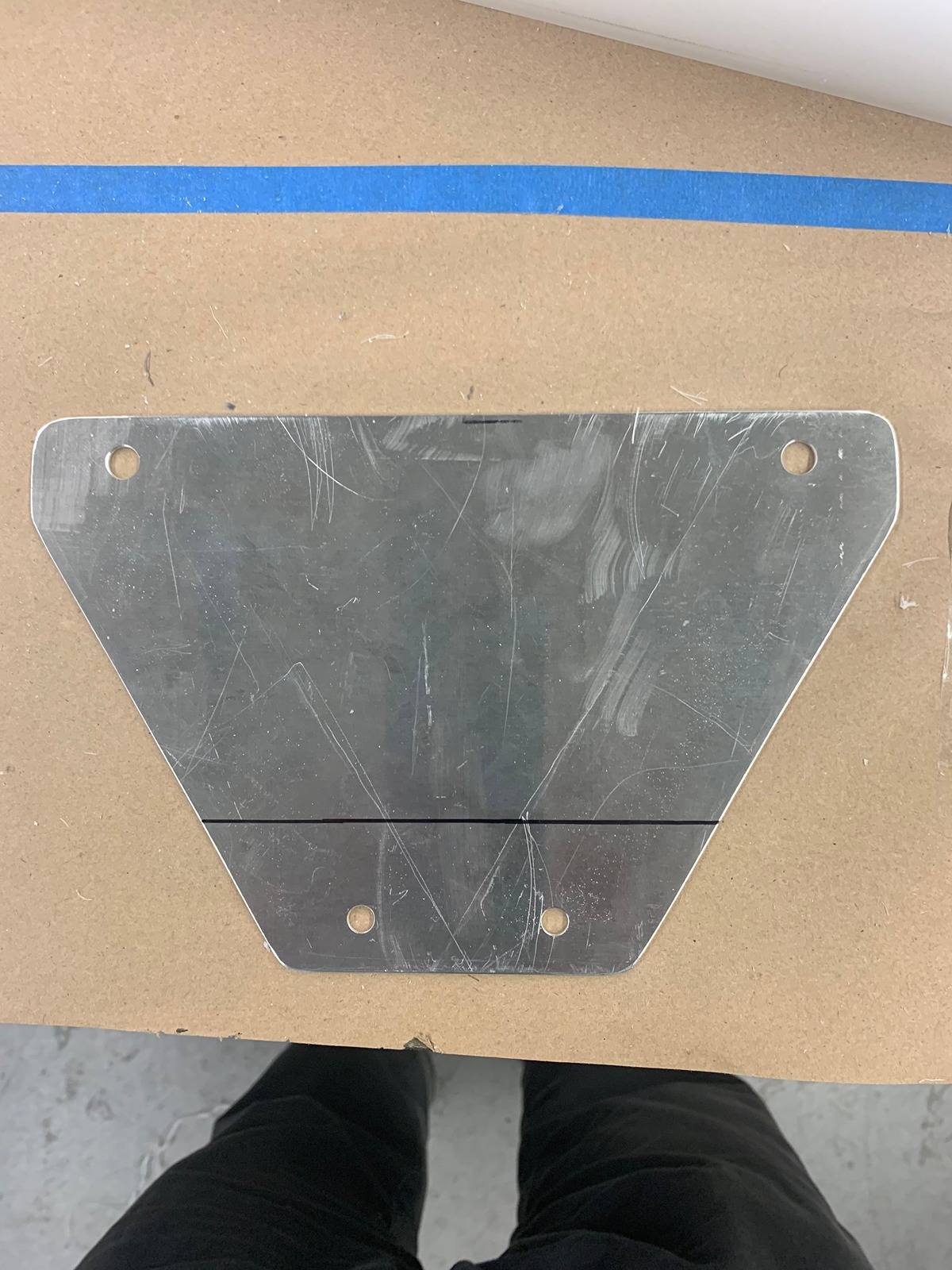

I decided to make my own. Turned out pretty good I think. I forgot to take a picture after I bent it. I'm a machinist so I'm fortunate to have equipment available to me. I first made a block out of PVC and I had to drill two holes on the underside for plastic rivets and I used some really strong two sided tape. Then cut and bent some 1/16" aluminum and bought some rubber license plate protectors. It fits nice and close to the bumper and I added two rubber bumper so it does not make contact. It took me two try's to get the height right so it would not interfere with the sensors.
