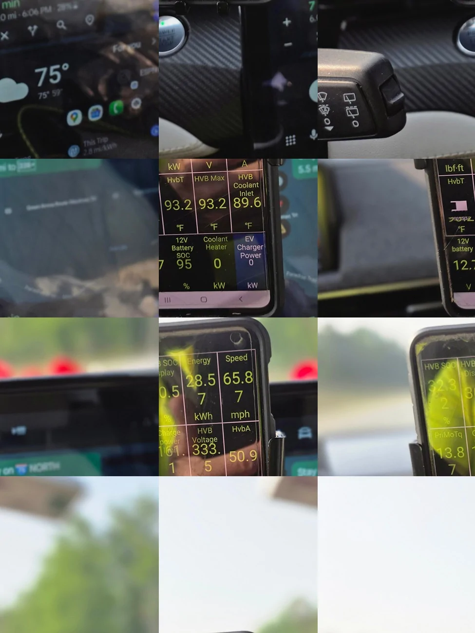

From my 2021 Mach E Premium I have seen during the cold months pre conditioning start at around 16 miles away from a dcfc. This is on a two lane highway. I have never seen pre conditioning occur when the battery pack is 73/74f or warmer. This includes when the battery pack was in the low 90s. Rivian has different software and does not have the pouch battery cell design the Mach E Premium has. A simple ORB2 reader and Car Scanner Pro App setup can display battery temperature and pre conditioning. This forum is awaiting photos and information from Mach E owners living in the Warm Southern states detailing any pre conditioning effects during warm summer weather.
The allowable temps for NMC chemistry batteries fast charging is 68F to 104F. You will not see much preconditioning when operating at those temperatures. It has nothing to do with pouch versus cylindrical packaging. Packaging can affect how efficient the heating and cooling are, but not how the chemistry is affected by temperatures.
GM vehicles also use pouch packaging, my Hummer has that. It also has much better thermal management than Rivian or Ford.
Doesn't answer question on pre conditioning above 73 74f. At this time we have zero evidence Ford does it.
