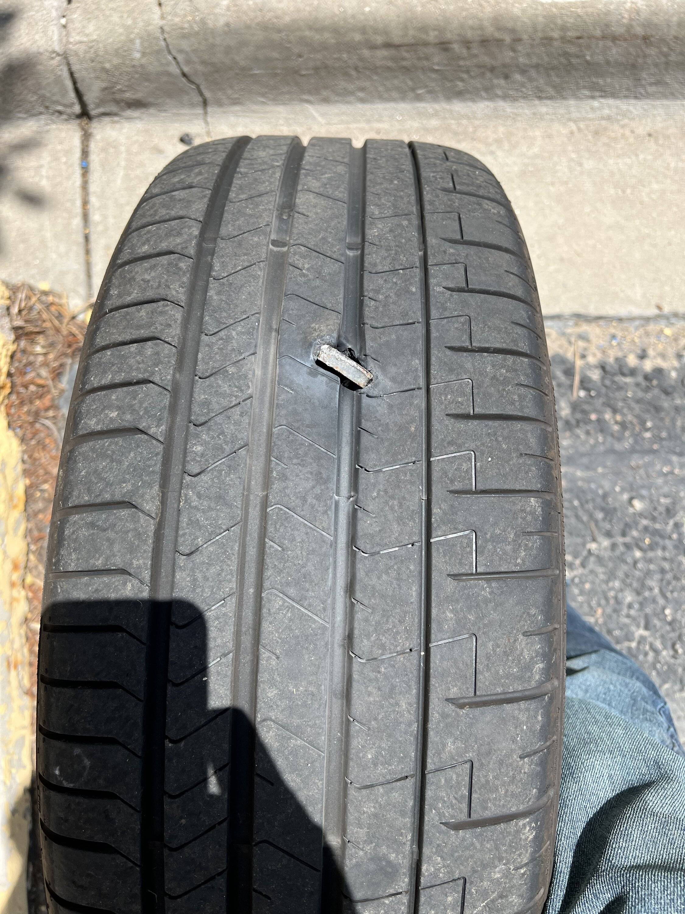

Today had a nasty tire puncture that deflated the tire in about a minute. Not sure what I ran over just yet, but wanted to let people know what to expect throughout.
I heard and felt the tire going before it alerted to being low pressure. Was able to remember where the tire pressure tile was and see it losing pressure rapidly before the alarms started going off. Pretty soon after that alarms did go off and warning banner was on small cluster. Able to reverse into parking with no real issues.
I remembered to back into parking due to lack of rear tow points.
MachE had the inflator and flat kit as expected, but since this was so bad, it would have done very little or been unsafe to drive after sliming it.

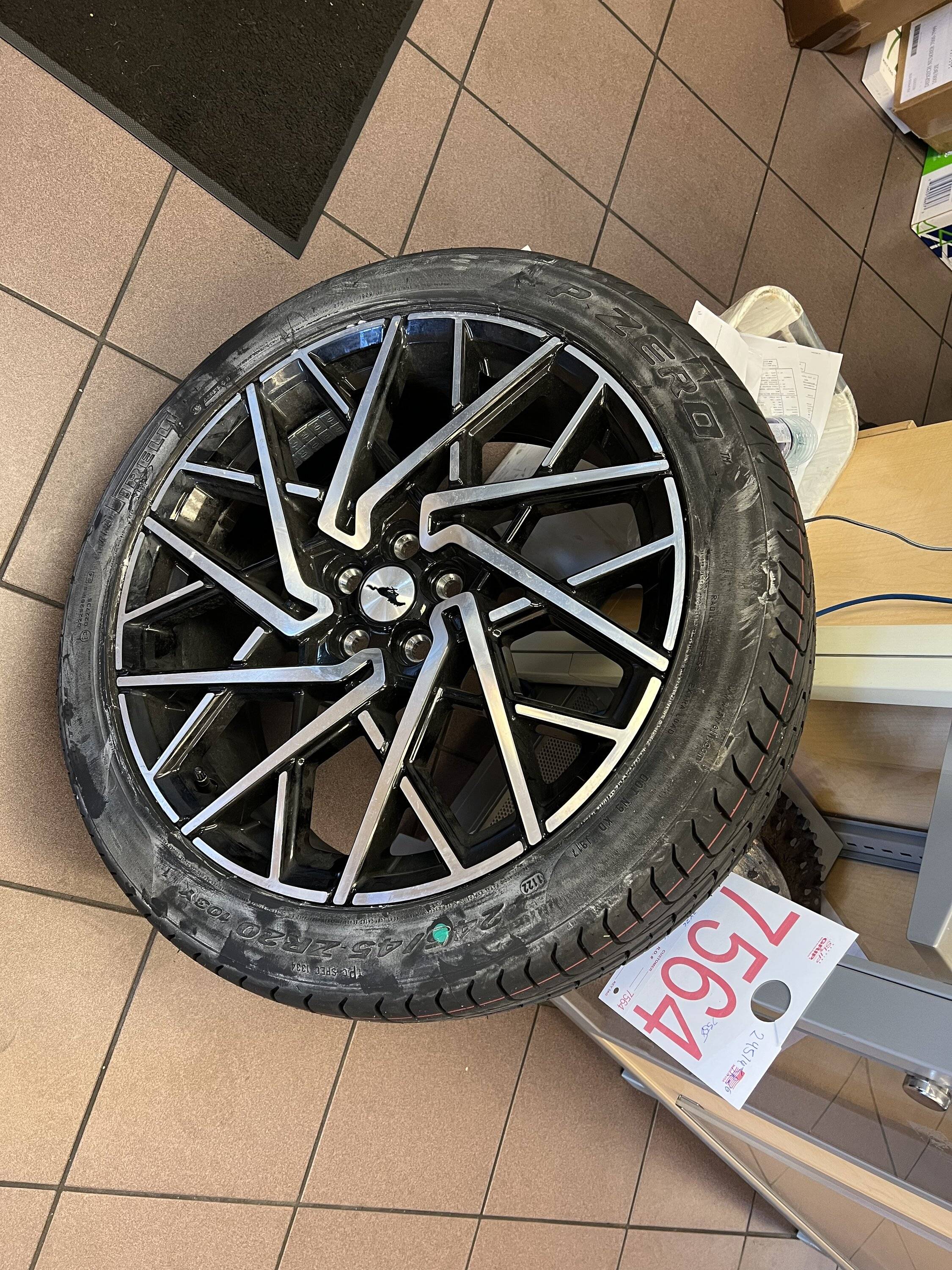

Ended up finding a dealership that could order, have it delivered, and mount/balance same day. If you need service in the Denver area, Sill-TerHar was attentive, responsive, and helpful! From what I can tell, they gave me a substantial deal on the rubber. Maybe 10% below online retail? Played the uno reverse on them and paid with some of those Ford Credit points. ?
Feel like there are about too many options as far as replacements. Ended up with a PZero with all the appropriate markings, ratings, and size buttt it doesn’t have the Elect notation on it. Ended up with part number Pirelli 1791700. Only had 2300 miles on the tires so hopefully wear will be equal enough. Have driven it a bit free-spirited - time will tell.

Man, like 50 feet from my office. It’s in an industrial area so maybe I should expect 4 inch steel rods to be in the traffic lane. ?‍♂
Lucky it wasn’t worse, but I’ll still be salty. Haha
