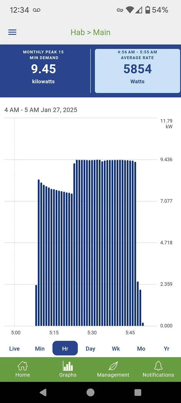

Here's my graph for last Monday when it was pretty cold. Mid teens F outside, mid 30s F in my garage at 5 am

The PTC heater is 6kW, so if your charger delivers only 2kW, you are draining 4kW from the battery. Running that for 30 minutes is ~2kWh loss in SoC.
Incorrect, heater power is LIMITED by the input power. So if your charger is only 2 kW, only 2 kW of heat will be used to heat the battery. They did that so the HV battery won't drain from preconditioning.
FYI if you're curious, the first couple minutes of 7+ kW is heating the battery, power decreases due to the PTC effect as coolant temps warm. Then because the battery warmed up some, it decided your SoC was actually below the charge target and started to CHARGE the battery some more in addition to heating. That's why it went to full available power halfway through. Charge target was reached again 15 minutes later and power dropped down to low levels to maintain heat before timeout is reached.
@ChuckUK I strongly recommend using a charger that can output 7.2 kW or greater for battery preconditioning. With lower power levels, it may not be able to warm up the battery fully in the available time.
Thanks for that info. It does indeed seem that preconditioning is a waste of time for my usage case. I wonder if a precondition how long it will stay ‘preconditioned’ and continue charging that batteries. With an L1 charger I guess there is no chance of recouping the lost battery percentage. Time to plan the 7 kw charger; the problem is the it’s an awkward and long cable route.
