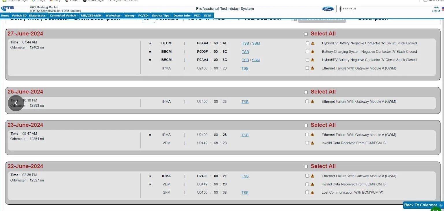

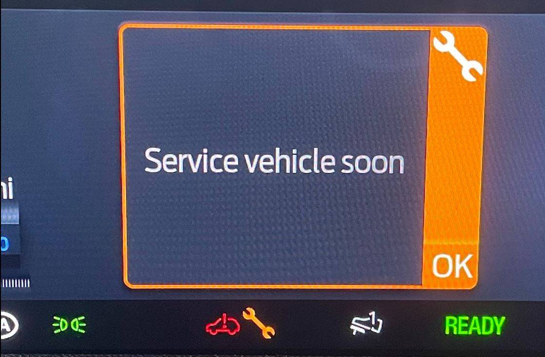

Hi everyone. Been a proud (okay, from proud to frustrated) 2022 MME GTP owner for just under a month, and well, wouldn't ya know it I'm getting the 'service car soon' message combined with severely limited power. Based upon pulling the codes, my build date etc, I'm thinking it's very likely the dreaded HVBJB at fault.
