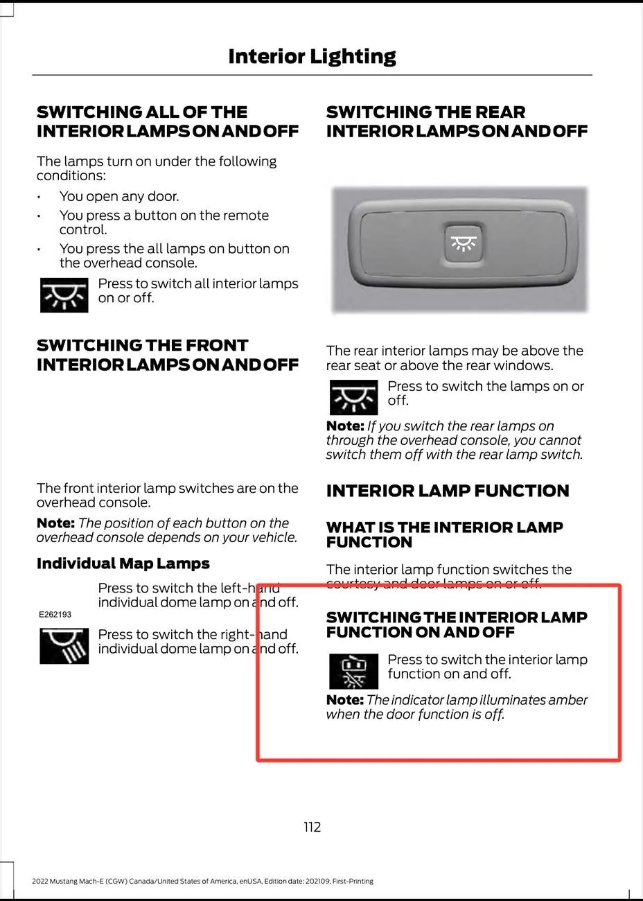

It's also not possible to disable the white interior lamps on door-open, blasting my eyes and ruining my night sight.
But you CAN do this. It’s one of the four buttons on the ceiling, above the center screen.

I thought that button only disabled the *rear* lamps. Does it do all lamps? Going to need to try it.
Disables interior lights. You need to open and close a front door after turning the car off to get the screens to shut down sooner. The exterior parking lights will still come on if anybody opens or closes a door.
