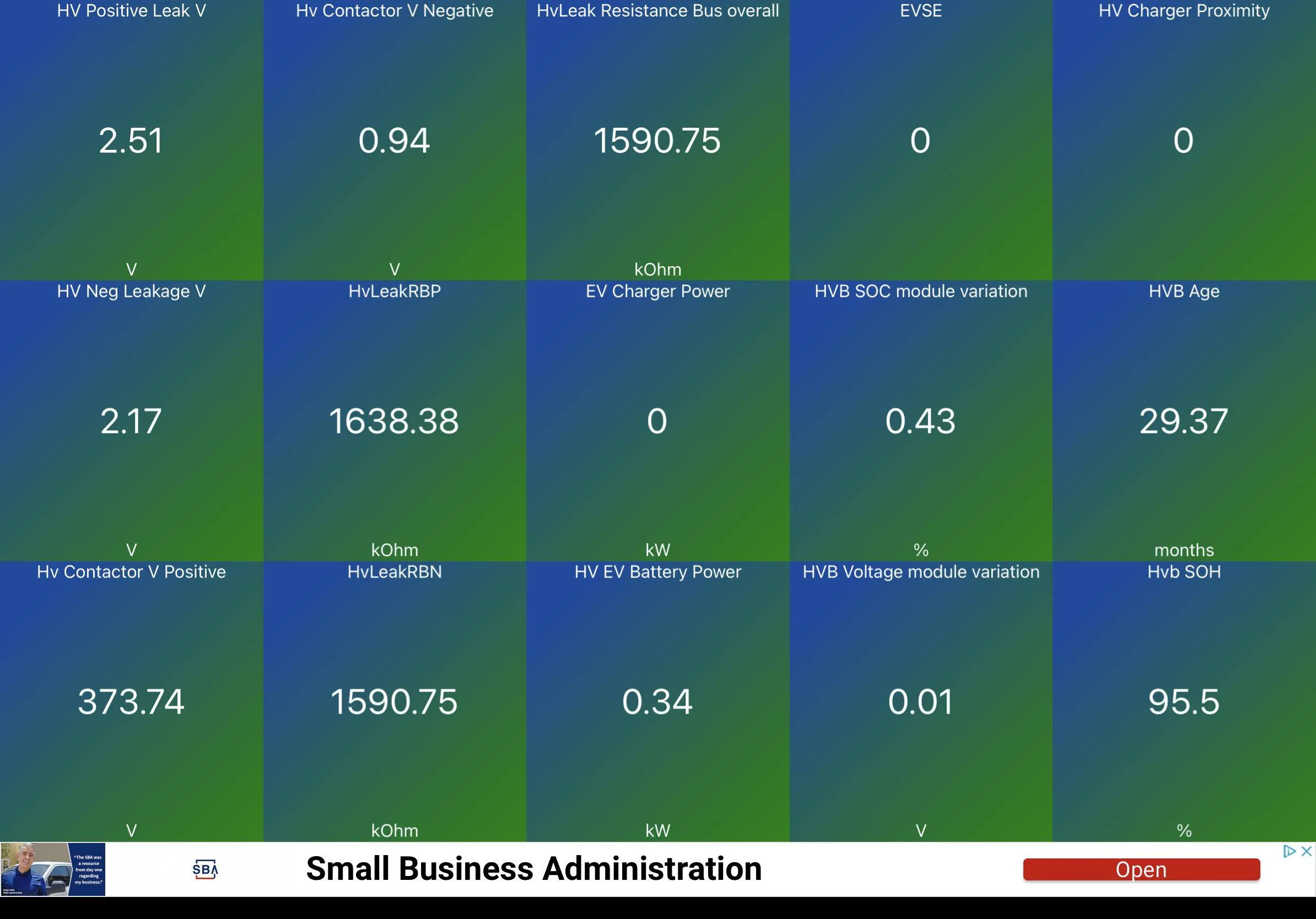

OBD reader to check the HvB state of health. I used an OBDLink MX+ with CarScanner app. It has dashboards for the MME. Keep scrolling and it will show up on this screen (bottom right). There is a poll with battery health so you can decide what works for you.
Ford Mustang Mach-E Is there a checklist to buy a used Mach E IMG_2513

3) check battery health as mentioned above

I would definitely check the HVB SoH. The rest would just be normal things you should check with any car: accident history, oil change history, etc. ?
