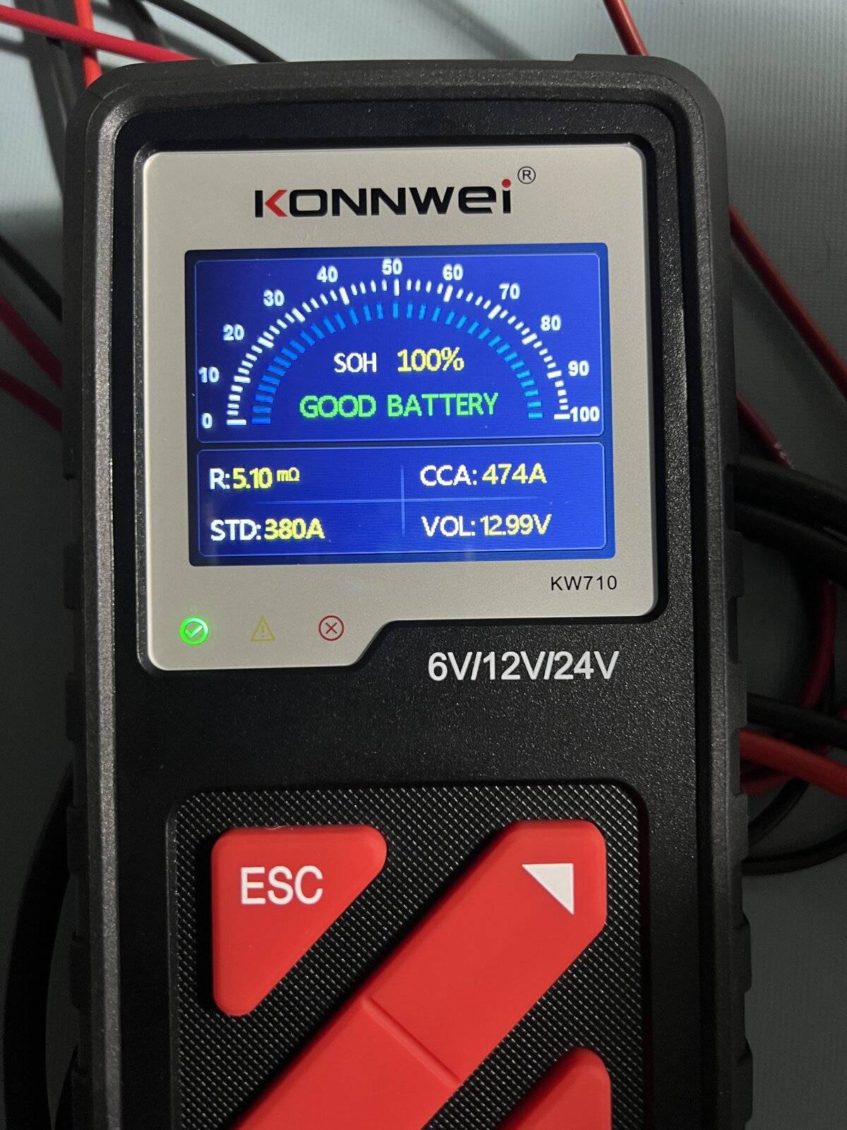

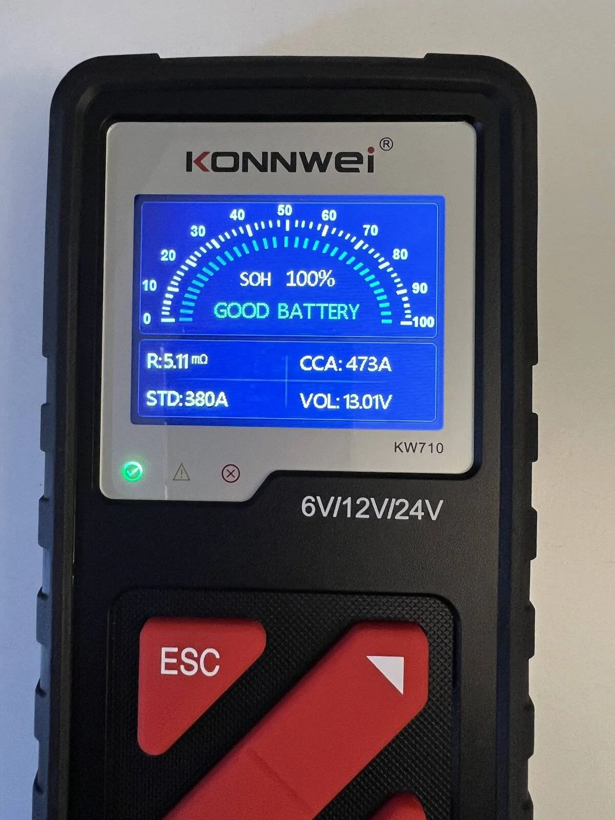

The KONNWEI KW710 BATTERY TESTER arrived this evening. I scanned the manual, connected the cable, and tested the new Mach E - BHAGM-H3 12V LVB. The KW710 is powered entirely by the battery under test, there are no batteries to install in the meter.
It all took a few minutes. Tested in the lab, at about 72F.
According to the KW710, I was at 100% SOH (soc?), the internal battery resistance is 5.11 milliohms, and the open circuit voltage was 13.01V.
I told the KW710 that the BHAGM-H3 12V CCA is 380, and the KW710 says my actual CCA is 473A.
Time allowing, I will change out my MME LVB with this new LVB, and repeat the test on the bench with the KW710.
