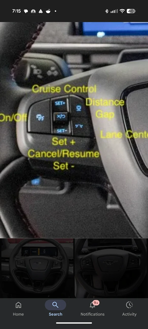

Make sure the lane centering button on the steering wheel is activated. Sometimes it gets turned off during updates. Left side of the steering wheel, lower right button.

That was it – I feel like such an idiot. I’ve never pressed that button, and don’t even know why it exists. Why should anyone ever turn off Lane centering???
