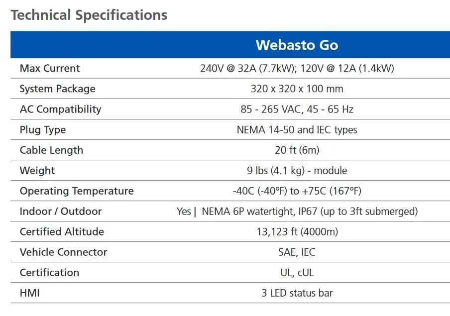

If your receptacle is the only one on the circuit you should be fine. According to this doc from another thread the 120 is 12 A. That is similar to what I see. I use a 3rd party Lectron chargers. I chose them because I can set the draw. I suspect some do it automatically.
