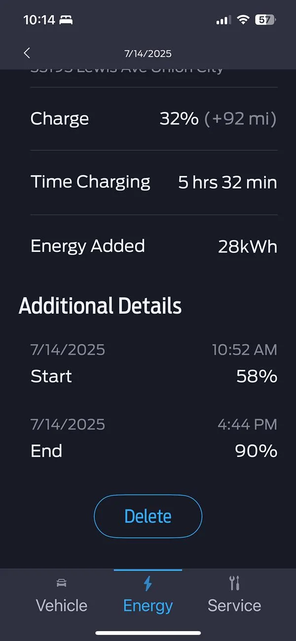

Measuring from the app which seems pretty accurate when I check it and it reads something like 6kW added and it’s been charging for 2 hours.
or like today in the attached photo I checked it after being on The charger for 3 hours and had to do the reset. 5:30hrs to get 28kW is not a good average.

Again, the readings from FordPass aren't always reliable. Sometimes they are correct, sometimes they are not. You should use an OBD tool to confirm.
Also, how do you know your workplace isn't deliberately limiting the charging rate during peak demand periods, or when all chargers are in use?
