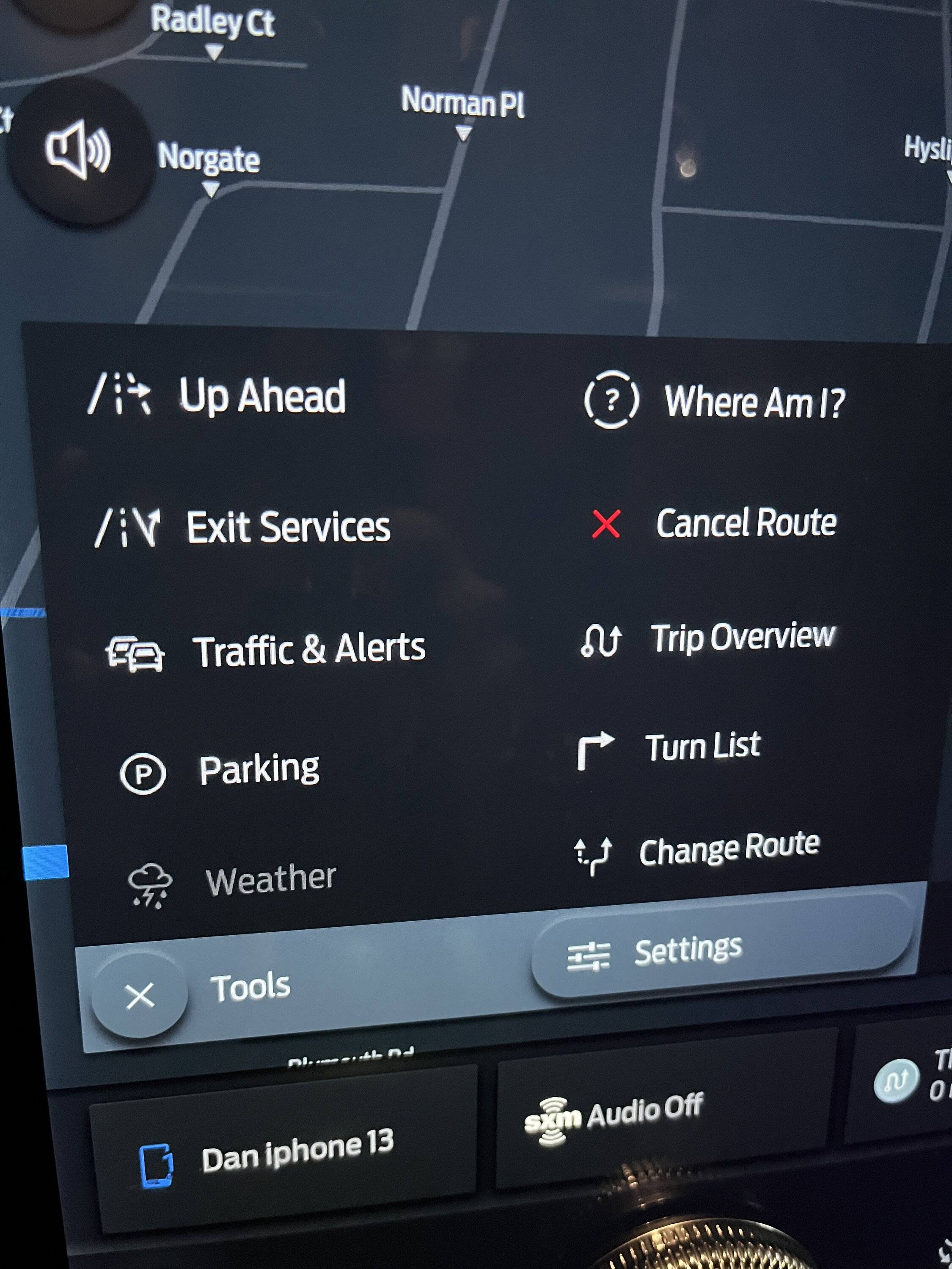

That's why I asked about asking for the weather through the "voice" button......this same thing happened to me when I picked up my new '23 Premium in June......I could not get a response when I asked for the weather but did get the message that there was a problem with connected services......at that time there was a problem with big Ford......a call to connected services solved the problem......part of the problem was also not getting traffic updates.....
Yup, and had I not already been on the video chat with them, your message likely would have gotten me there - so thanks!

Searching for chargers would have brought up a message to turn on connected services, not sure why you had to go through the whole hassle. I’m just glad the menu showed up for you when you needed it lol, cause there’s a bug with that right now.
That's exactly what happened - the video chat agent had me click on chargers (even though it was greyed out - who would have thought clicking on a greyed out option was a thing..) and that brought up the settings section.

All - thanks for all the suggestions - I missed them because I was on a video call with Ford. I must say, that was a great experience! So much better than just calling - the ability to just show her what I'm seeing on the car was awesome.
Better yet, she figured it out! It turns out that in Connectivity/Connected Services, under Connected Vehicle Features, The Connected Navigation toggle was disabled. (2nd to last option). Not sure if 1) it was always disabled or 2) I disabled it at some point myself (extremely unlikely) , or an 3) an OTA update disabled it, but either way, after I toggled it on, I got both traffic and weather.
I'm super happy now and hope that others in the future find this and 1) use the video chat and 2) check to see if the toggle is enabled. :)

I then followed what you mentioned and click on "weather" inside Navigation. It brought me to the Connectivity page but it closed itself quickly.
I then turned off the vehicle and check the Fordpass setting on my PC. Everything looks all right.
I came back to my vehicle and press the navigation -> Tools-> weather again, this time it brought me to Connectivtiy and the screen like yours expanded ok this time.
