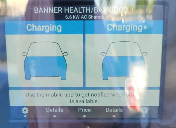

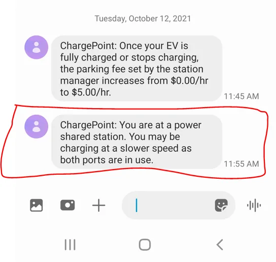

Is the ChargePoint unit at work a dual head unit with a display screen? If so, they usually tell you if they are power sharing or not. You should also get a message on your phone that tells you the charging speed. If you are the 2nd car to arrive then you just get the "charging at 3kW" but the driver of the car that was already charging gets another text message saying their charging speed was just reduced (because another car plugged in too).
