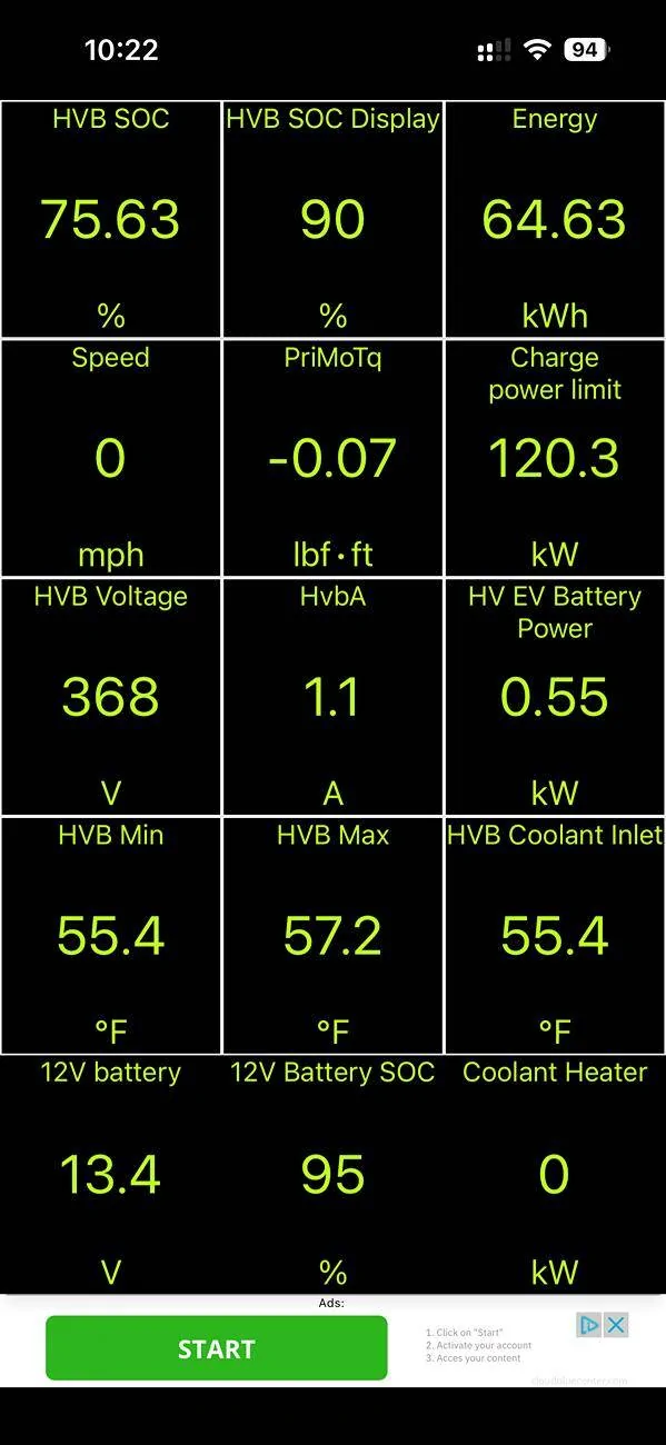

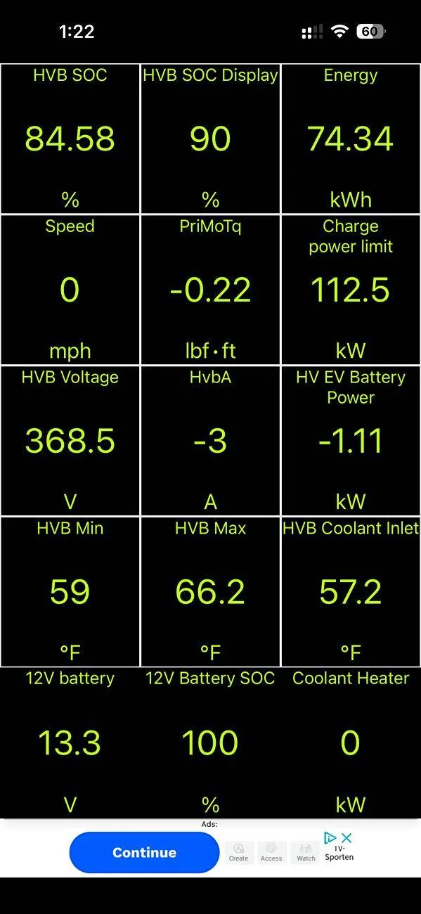

I'm having an issue with my brand new 2024 Mustang Mach E Premium AWD Ext. Battery. Whenever I leave the car unplugged for a couple hours, I see a huge drop in HVB SOC (see attached). I did a test this weekend to confirm. Right after charging my car to 90% (parked in attached garage), I unplugged it and measured the SOC, then waited almost 24 hrs later (car completely off) and measured again. I'm seeing about a 10% HVB SOC drop and almost a 10kWh drop. HVB SOC Display stays the same until I start the car, then quickly starts dropping. Currently using the Ford charger at 110V while i'm awaiting a level 2 charger install in about a week.

So the displayed SOC stayed the same, yet the actual SOC changed 10%.
And the battery temperature was basically the same for both readings.
That's definitely odd.

The battery voltage is basically the same, so it’s not actually draining. This is some weird BMS issue. It may be Level 1 charging makes things more difficult for the BMS due to the low currents involved. The extended pack should be around 380V at 90% charge, it's much lower than that (368V) so charging to 90% is being terminated early.
Can you charge the battery to 100% (on a Level 2 if possible), let it sit 5 hours, and see if it still happens? Note: Because the BMS is off, it may take an additional 10 hours longer than the estimated completion ETA for it to actually finish charging at 100%. Drive it and see how far the SoC drops in the first minute or two.
Also since you have car scanner, can you take a look at the cell voltage and cell capacity variation parameters?
