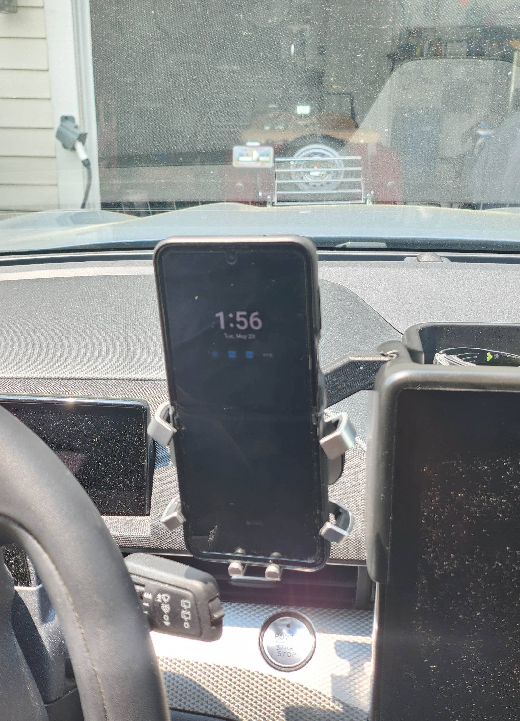

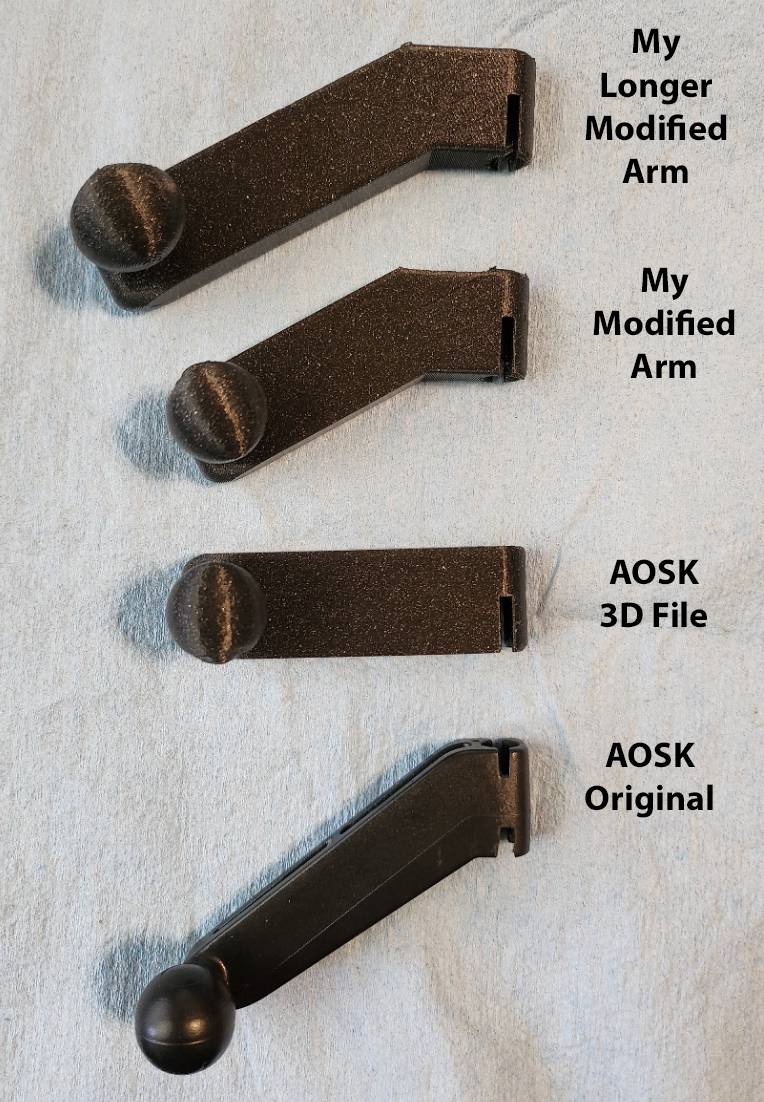

I wanted the phone holder arm on the AOSK Phone Holder Tray to angle down. A clever modification used by another Forum member didn't allow for a secure enough connection that I was looking for. So I downloaded AOSK's 3D print file for their phone holder (note: the 3D model is not the same as the arms that ship with the tray). I used a third party phone holder because the ASOK holder requires two hands to operate. I modified the original arm and made a short and longer version. When my wife returns with the car I'll show the phone mounted to the tray.

BTW, Don't use PLA filament. the sun softened it and the weight of the phone twisted the arm. PETG works fine.
