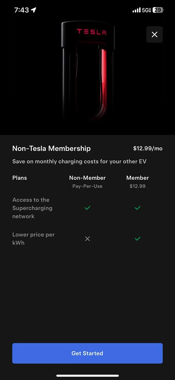

You can sign up for Tesla membership pricing to save some money if you plan to charge multiple times / 130+ kWh by using the Tesla app and signing up for their plan.
After that you will use the Tesla app to start / stop your session before you plugin to charge.
