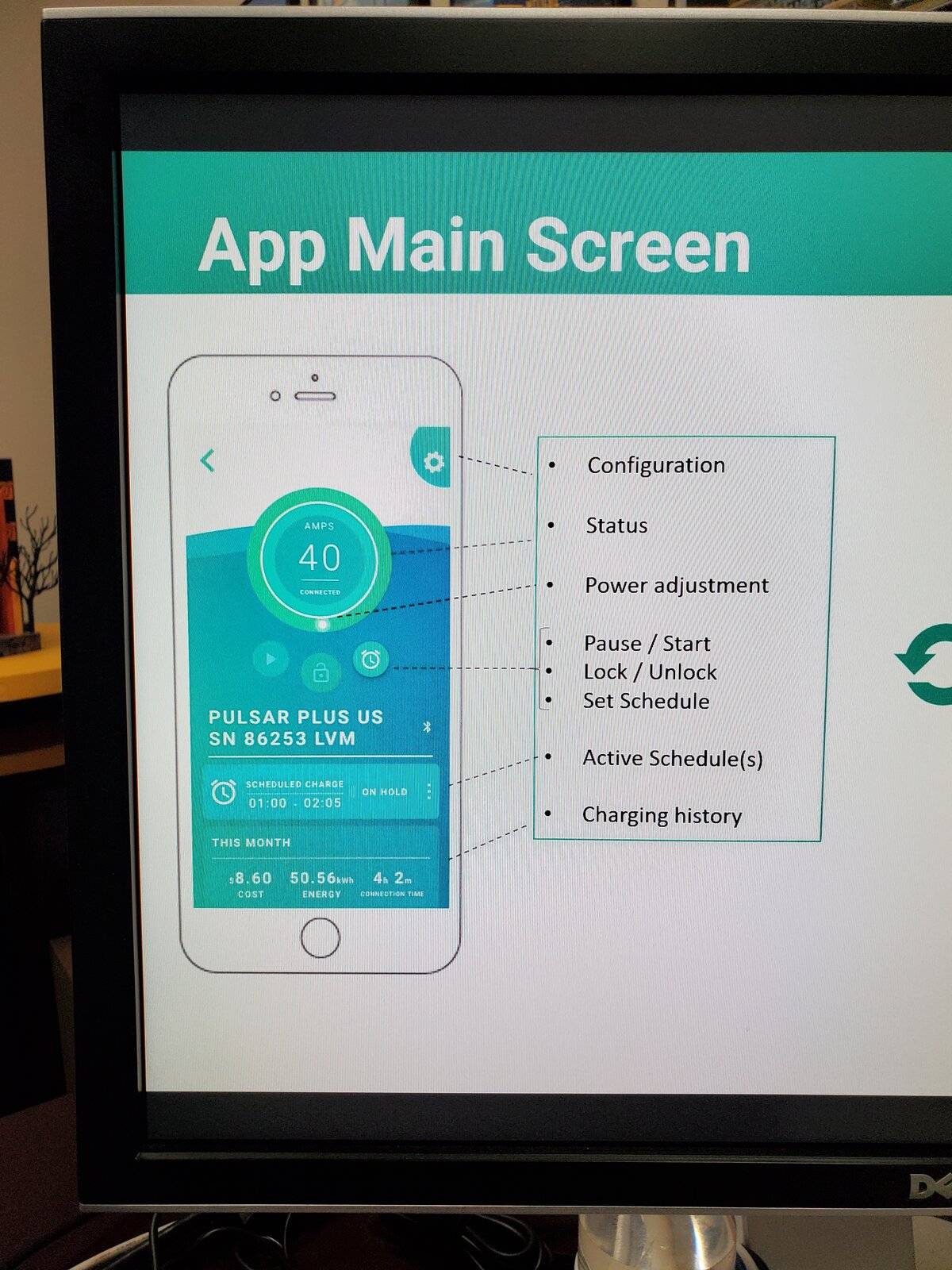

Cool. Thanks!
Screen shot?
No, screen has serial number and address...
It is a number. Type in any number you want.
