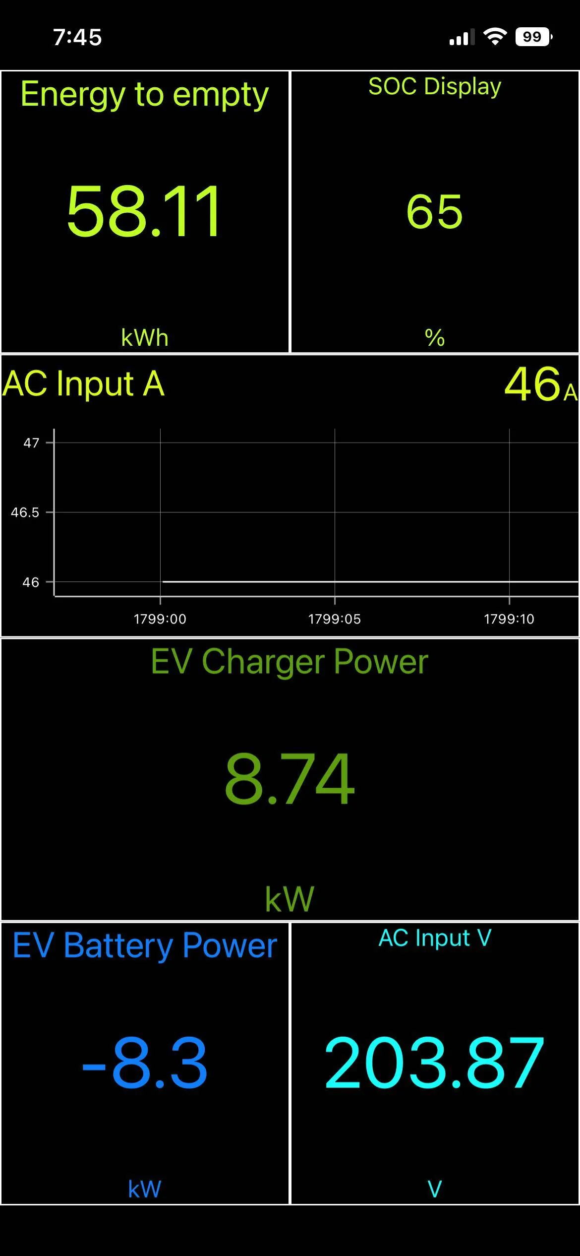

yeah i ended up getting Car Scanner Pro, it is surprisingly powerful. I am enjoy the detailed car stats directly on the car's main display.
I can confirm the FS model works very well, connects fast and goes into a sleep mode and doesn't drain the 12v. I have done some re-programming with Forscan using a windows laptop as well. Being able to monitor battery temp i feel is a no brainer. ICE cars have a engine temp gauge, why hide this important detail on EV's?
I've had the battery start at below 0c on cold days where it was parked outside. Based on everything I've read about batteries and cold weather you really want to take it easy when its that cold. Out of the box the car doesn't provide any feedback about being careful with accel/decel when the battery is that cold. Having the power meter active at least gives you a rough idea based on how many jail bars their are to judge what state the powertrain is in.
