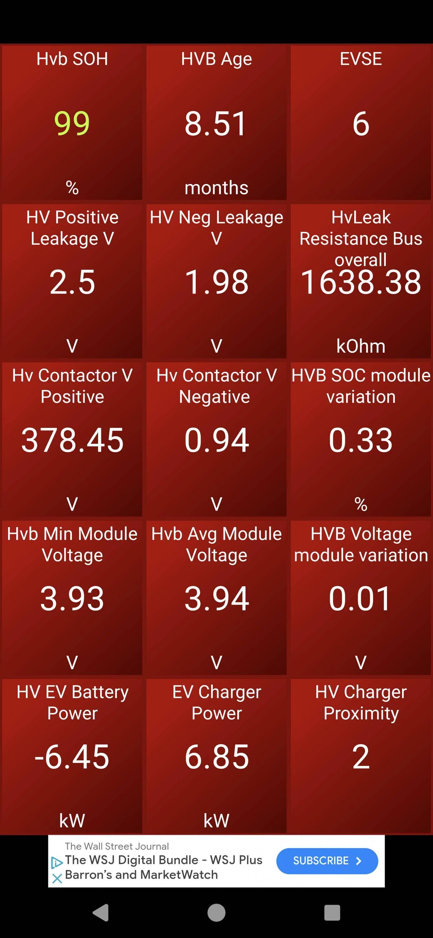

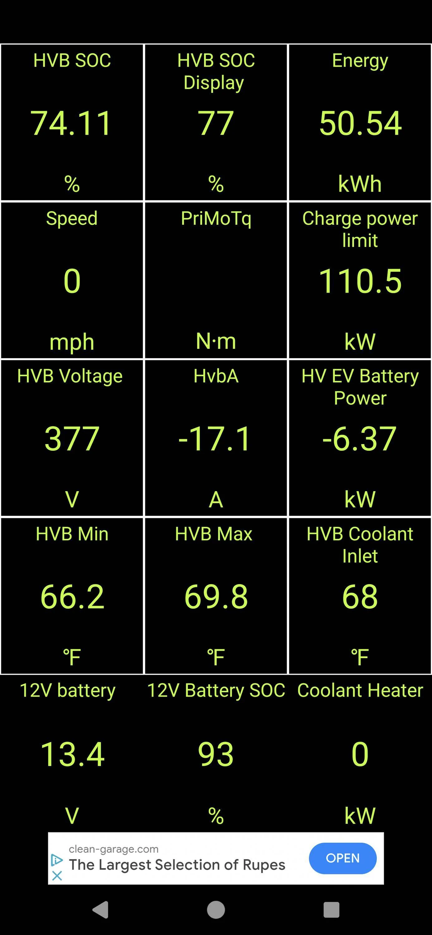

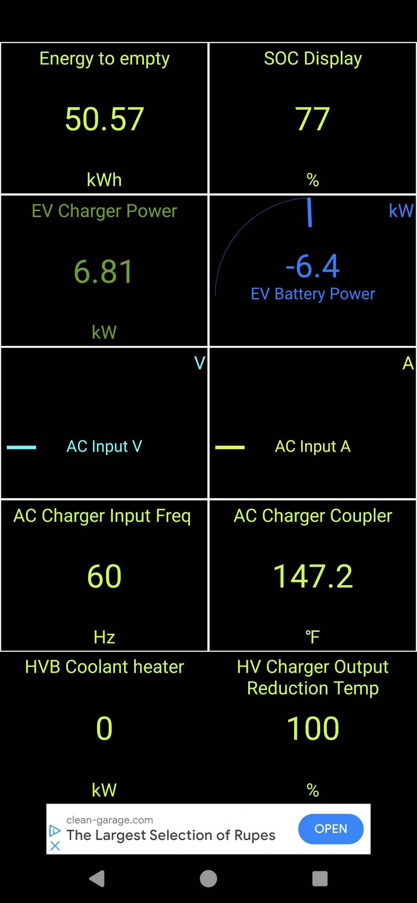

The OBD will only report live data, but you can leave a phone to record it if you want to log history I guess. Most OBD2 apps support logging.
I use this scanner for reading car data, cheap and it works: https://www.amazon.com/gp/product/B06XGB4873
Beware: you can't make Forscan changes with this adapter. You'll need a wired USB one for that.
I recommend this app to connect to it as it has most every parameter you'd want out of the box:
https://play.google.com/store/apps/details?id=com.ovz.carscanner&pli=1
If you're more advanced and know what PIDs you want to use, then use Torque.
