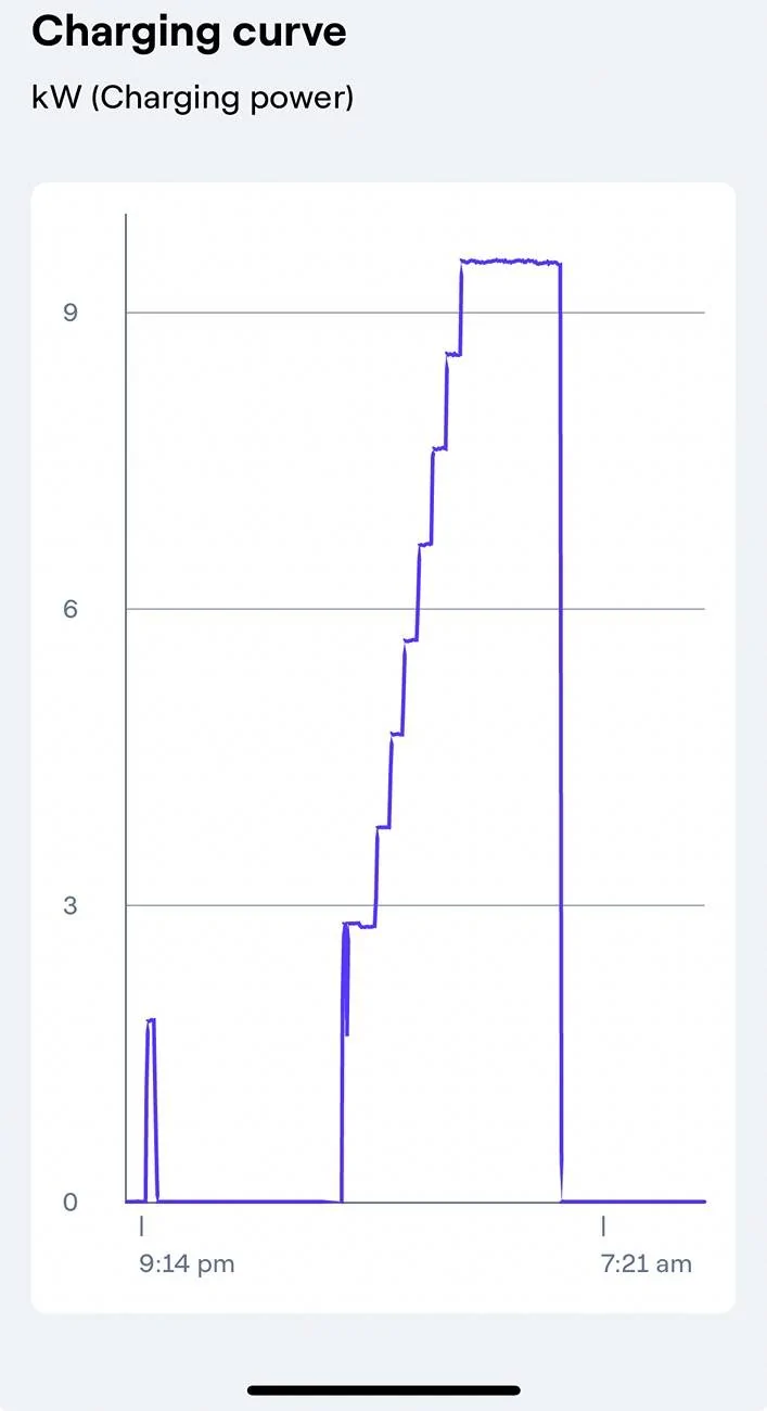

Thanks @Adventureboy Here is the charge curve from last night. It took 2 hours to start charging at ~9.5kW. Is that what you are talking about. This is with setting the charge time on the charger. Thanks for all the help on this! Also, should note I used an EA fast charger on my way home and had an issue. It charged for a minute and then said it was complete. It did this twice and then moved to a different charger and it worked great. I’m new to the Mach E, so I appreciate all the help!

It looks like it started charging immediately when you plugged it in just for a short while but less than 2kw. Then it shuts off and waits for your charge window. This is common.
Your charge ramp-up seems slow. It looks like the ramp-up to 9.5kw took a few hours on your graph. Mine usually ramps up to full power in 5 minutes (my Emporia, Grizzl-E and portable all ramp up in minutes).
  1. Do you have any settings on the Juicebox limiting full power based on your overall power usage? If so, this may be your issue since the Juicebox may be telling the car it can only give 2kw when you plug it in.
  2. Also, make sure your charge contacts on the MME and the EVSE are clean. You can find multiple posts on this forum on cleaning the MME port pins and charge gun. DO NOT LUBRICATE the pins or gun - they need to stay clean and grease-free. I use Qtips and light solvent like rubbing alcohol then blow dry with my air gun. The EVSE doesn't provide power to the gun until it communicates with the car but just to be safe, unplug or turn off the breaker before cleaning the gun.
  3. If you continue to see slower ramp up times, check on a different EVSE and see if it does the same thing (maybe spend 5 minutes at the Ford dealer plugged in to see if it ramps to full power). If it does the slow ramp-up on other EVSEs, you may need to get the dealer to look at the car. If not, your EVSE may be struggling internally and you'll need to troubleshoot it.

That is quite unusual, the ramp up to full power should take seconds, not hours. Something is up with the EVSE or the software in the car.
